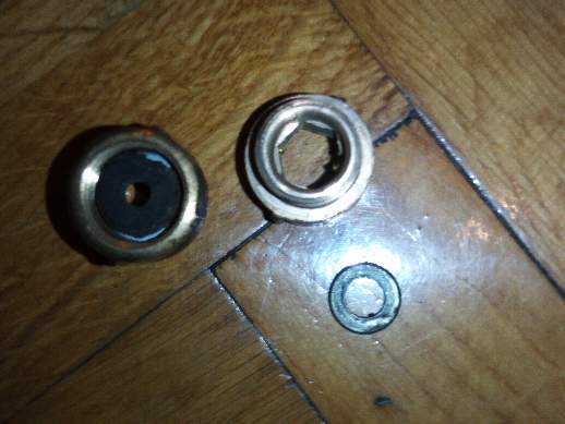

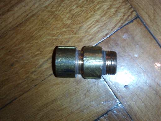

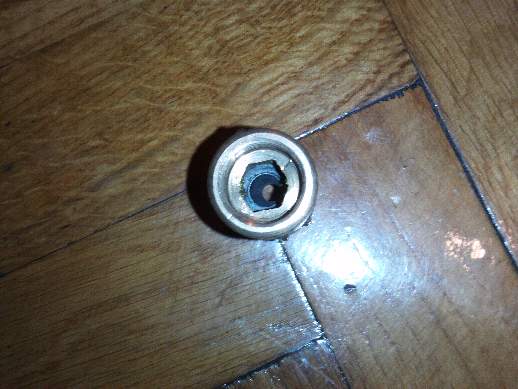

homemade compression fitting
you put it onto the tube and tighten... rubber washer gets squeezed and holds it in place as well as seals perfectly
