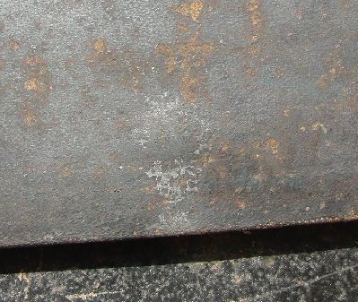

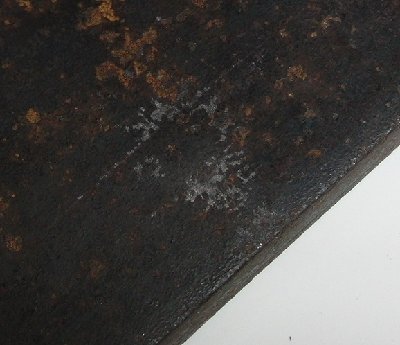

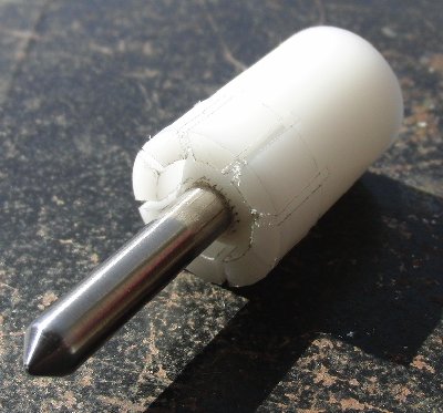

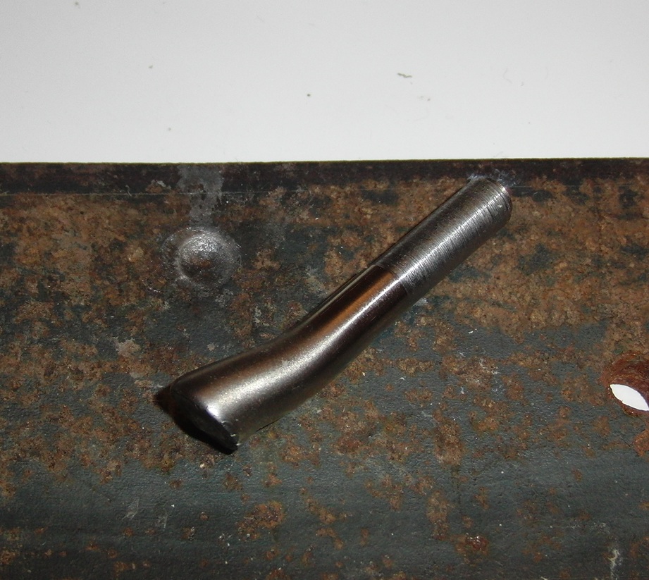

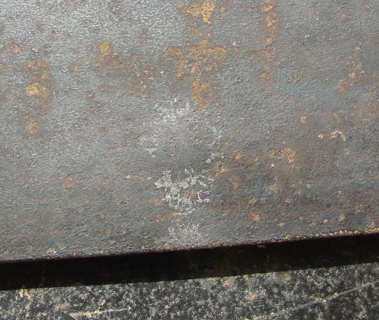

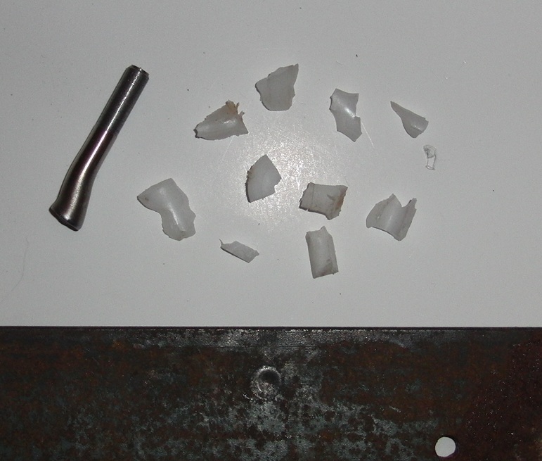

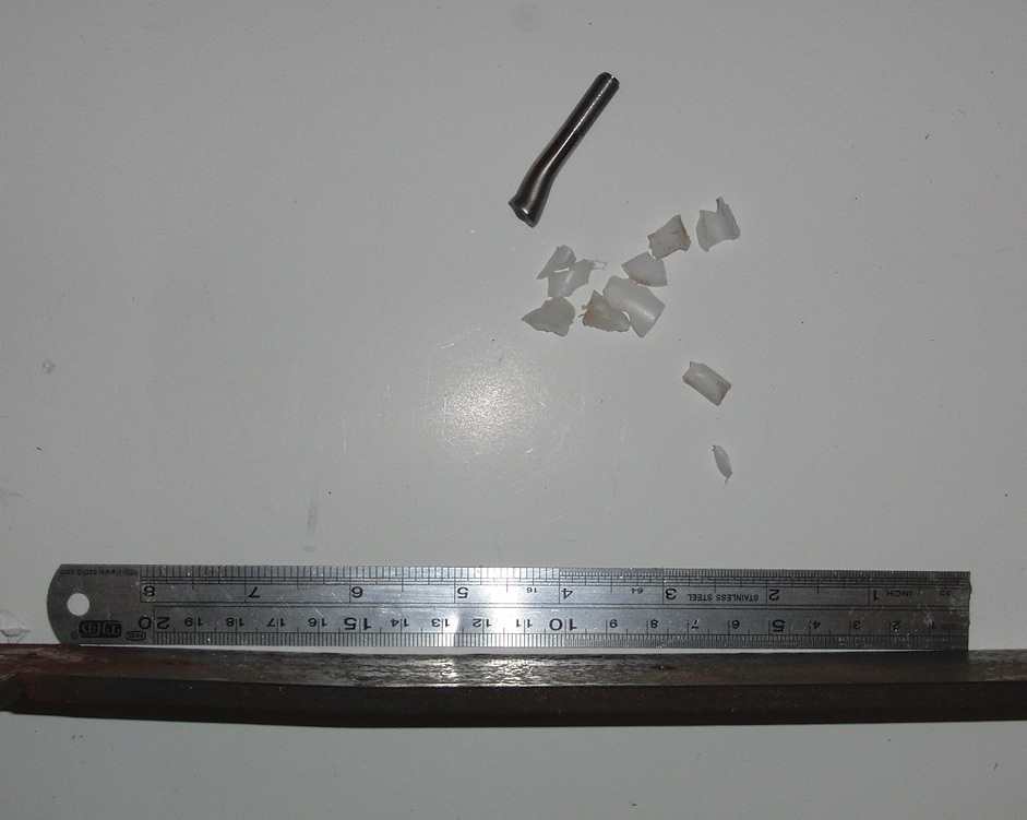

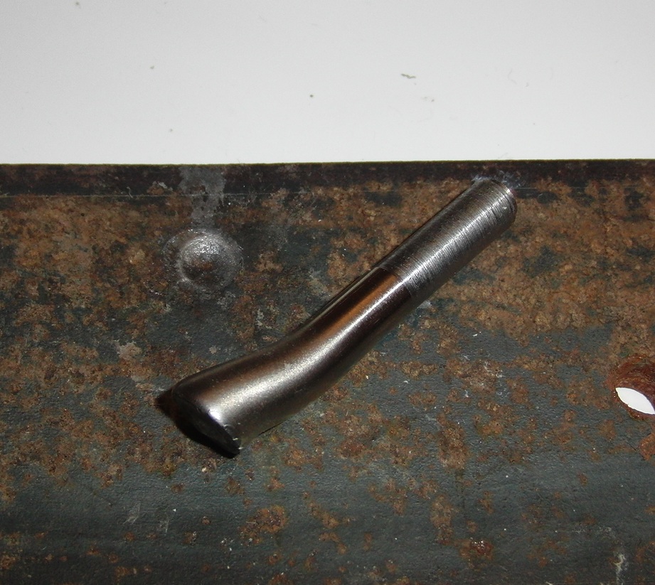

After all the sabot/fin work I did for Petitlu here, decided to give it a go myself with this launcher. I used a mild steel shaft from a printer cartridge, not the hardest of metals and definitely not as hard as the 1/4" steel plate I was shooting at.
Shot at 18x, after the smoke cleared I was disappointed to see that not much was done to the plate. When I found the projectile though, I was very impressed - the amount of deformation is remarkable. It's also worth noting the extent to which the previously dead straight plate got bent.
This makes a point about hardness, nature always takes the path of least resistance and in this case it went to the deformation of the projectile as opposed to the penetration of the plate. I trust Petitlu will have better results with his much denser and harder tungsten carbide rod :D

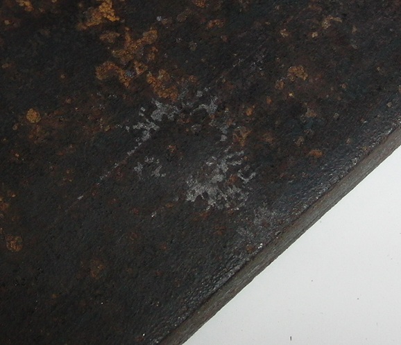

plate deformation
plate deformation
closeup of core and impact mark
projectile core and what fragments of sabot and fins I was able to recover, along with the impact mark on the plate

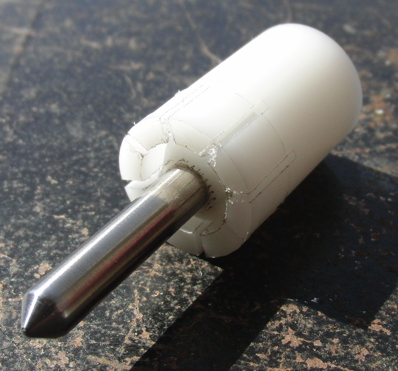

projectile fitted in sabot

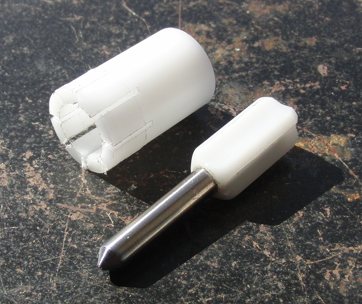

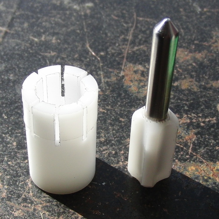

projectile and sabot
damn I am sure you forgot to put a piece of paper behind the plate to check if there was any spalling

POLAND, you can clearly see where the projectile hit on the other side of the plate, but there wasn't really any true spalling.

Why have placed the fins in a shoe?
Posts: 26220
Been thanked: 352 times
Petitlu wrote:Why have placed the fins in a shoe?
I wanted to use the same dimensions of fin that I'm sending you (12mm diameter) but since this is 0.75" I had to use a sabot.
