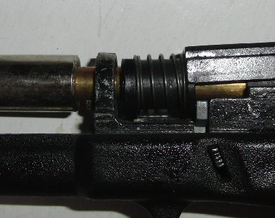

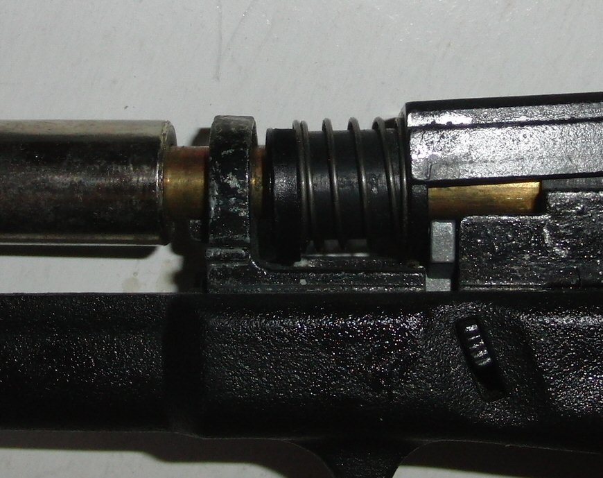

Edit, heres my reaction... WTF! Get rid of that gun, is all I can say. Pipe cleaner bushings? You got scammed my friend. If you want an airsoft pistol, let me know, I have one that goes close to 250 fps. I can sell it cheap, I don't like it, and its worthless to me. I would have to check with my parents first but yeah.

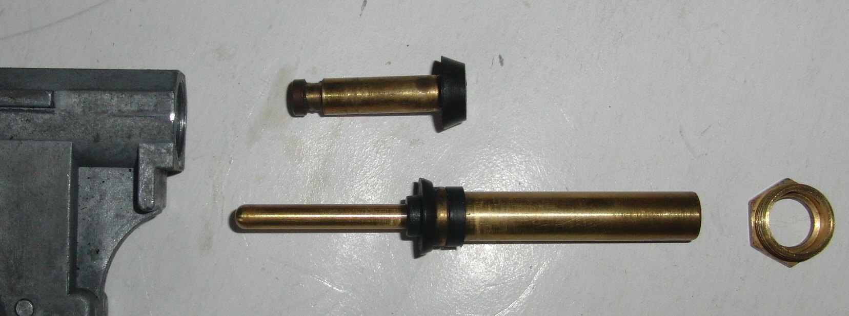

I shot the gun with the slide off and seems gas it going everywhere!.
1)I take that the rubber seal at the chamber,where the Nozzle pops into in supose to be airtight?,if I blow through the end of the barrel with the brass air nozzle into that rubber seal then you can hear air hiss around it( where the bb gets held inplace I mean,its not a hop up though.
2)right at the rear of the gun theres a small hole( where the brass blowback rod resides in,equalization hole??) and gas comes out here with great force!,is this normal?. Im pretty sure the seals in there are buggered?
3)I dont know what purpose that spring does( behind the pipe cleaner) it doesn nothing at all!!??,doesnt compress or engage on anything. That Pipe cleaner looks to have been put there to engage with a nub inside the slide,so the original part must be broken or lost by some previous idiot owner. I really need to know what the original parts were and how they were orientated onto the gun,but no diagrams can be found
I can find no contact info for Haw San Toys, google results show only a" Haw San airsoft Shotgun "and a "Glock Co2 Magazine" I wonder if any Airsoft retailers could supply a contact address??.
Hopefully Jack's gun is the same? and the seals are in good order cause it looks like sourcing these seals will be impossible

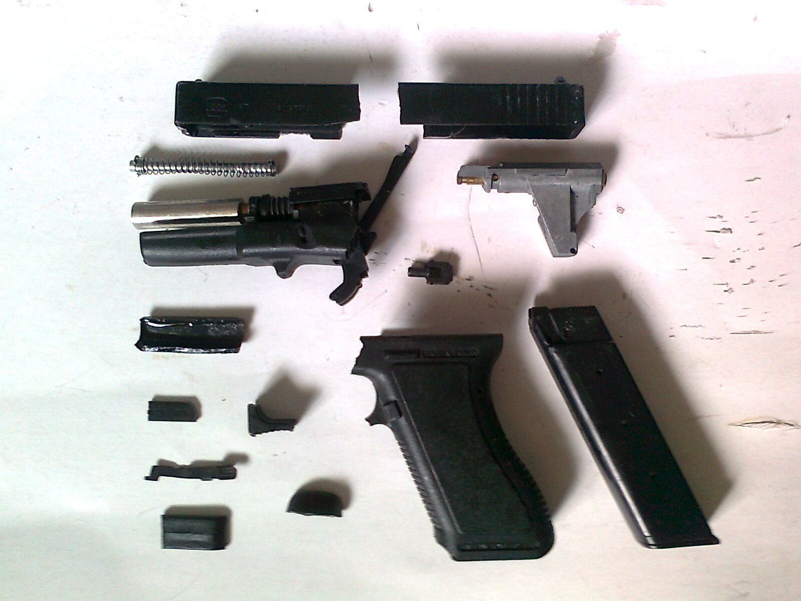

I can confirm mine is also a Han San. Here's a celllphone photo (proper camera charging...) of the state it's in, any part that can be smuggled into Aus without issue you are welcome to have at no expense :)

Wow you sure did a number on that Pistol!!,probably the best thing for it! LOL :D
1)I Really need that thing infront of that light spring,is it a seperate peice from the metal part the spring lives on?or is it all one peice?( the bit thats a pipe cleaner on mine).
2) Need the light Spring itself.
3) the seal in the barrel that the bb sits in.
4)The two seals in the chamber at the back,where the Blowback Rod live's
5) the Seals out of the Mag if possible??
6) whatever is supose to hold the barrel down at the front,mine has a o-ring? but its too big ,could put a smaller one on but dont know what the original part was?.
If that part infront of the light spring is all one peice with the metal bit the spring sits on? I dont think it wil pass customs as it looks like a gun part. Cant tell on mine if its broken off or lost ( the pipe cleaner bit on mine)...
After more fiddling ,its getting more shots per fill but the slide still refuses to lock back after the last round? and still wont load bbs into the chamber and cant understand why it doesnt?.
if I fill the mag with gas and bbs,then rack the slide it will spit out 2 bbs at once,if I load it up and dont rack the slide then nothing comes out. The only thing I can think of is that front section with the light spring and Pipe cleaner= the pipe cleaner is probably not engaging with the nub on the inside of the slide and also the spring there is all out of shape and enlarged I tried to bend it back into roundness but its too missshapen.
Some better pics, I can send you all you all the parts requested as pneumatic cylinder spares or something similarly innocuous.
The "pipe cleaner" part is a plastic split ring.
Are your seals in a similar condition?
