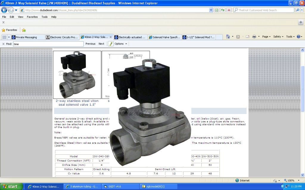

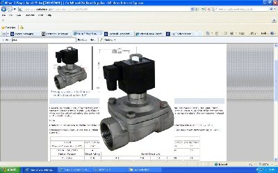

So in getting back to this orginal point of this post. I have found this valve that is an in-line 1.5" solenoid. Would really like to use the solenoid on this gun but am wondering if anyone has any experience with valves of this size if the solenoid would be as fast as modding this with a blow gun.
I will be using 10 AA batteries to fire the 12VDC valve if I do go with the solenoid rather than blowgun.
I am guessing with this gun you could just unscrew the solenoid as JSR has suggested and place a blow gun.
Link to valve
http://www.dudadiesel.com/choose_item.php?id=2WJ40040N
Link to valve
Keep it electric, unlike a sprinkler valve this sort has a high flow pilot, I predict a blowgun will give you worse performance.
I would try a single 9V battery firstAtattack wrote:I will be using 10 AA batteries to fire the 12VDC valve if I do go with the solenoid rather than blowgun.
- Technician1002
- Posts: 5189
A single 9V besides being 25% low on voltage, it may be hard pressed to provide the current over an amp the valve needs. If you use a 9 volt battery I would put an electrolytic cap in parallel with the battery to provide the impulse of current needed. Use a 25 volt cap of at least 4700 MFD.
That valve draws 17 Watts at 12 volts DC.
110v AC: 22 Watts, 12v DC: 17 watts
