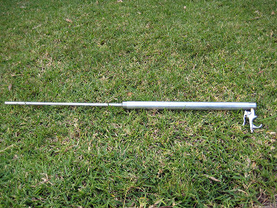

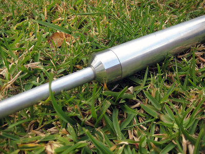

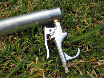

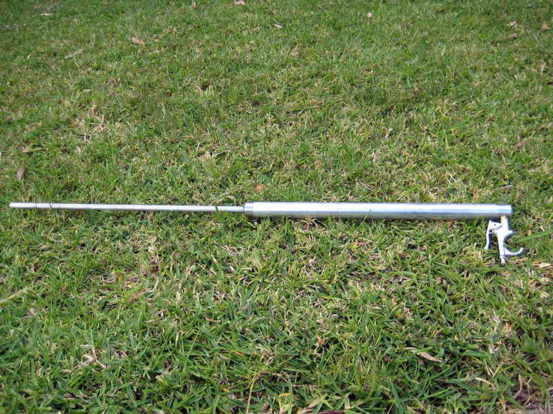

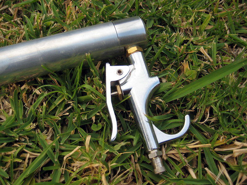

Ok so I kinda got a bit sidetracked these last few weeks with exams and other boring stuff hence the delay.
Taking your advice I tracked down some nylon rod for the piston.
Today I quickly knocked up the barrel support/spacer and the piston.
Sure they may not look fantastic but they're out of site so I don't mind.
I need a bit more practice with the turning of the nylon but it's a nice fit and I'm sure more than functional.
Rubber face has just been epoxied to the piston and I should have it assembled for it's first test tomorrow.
