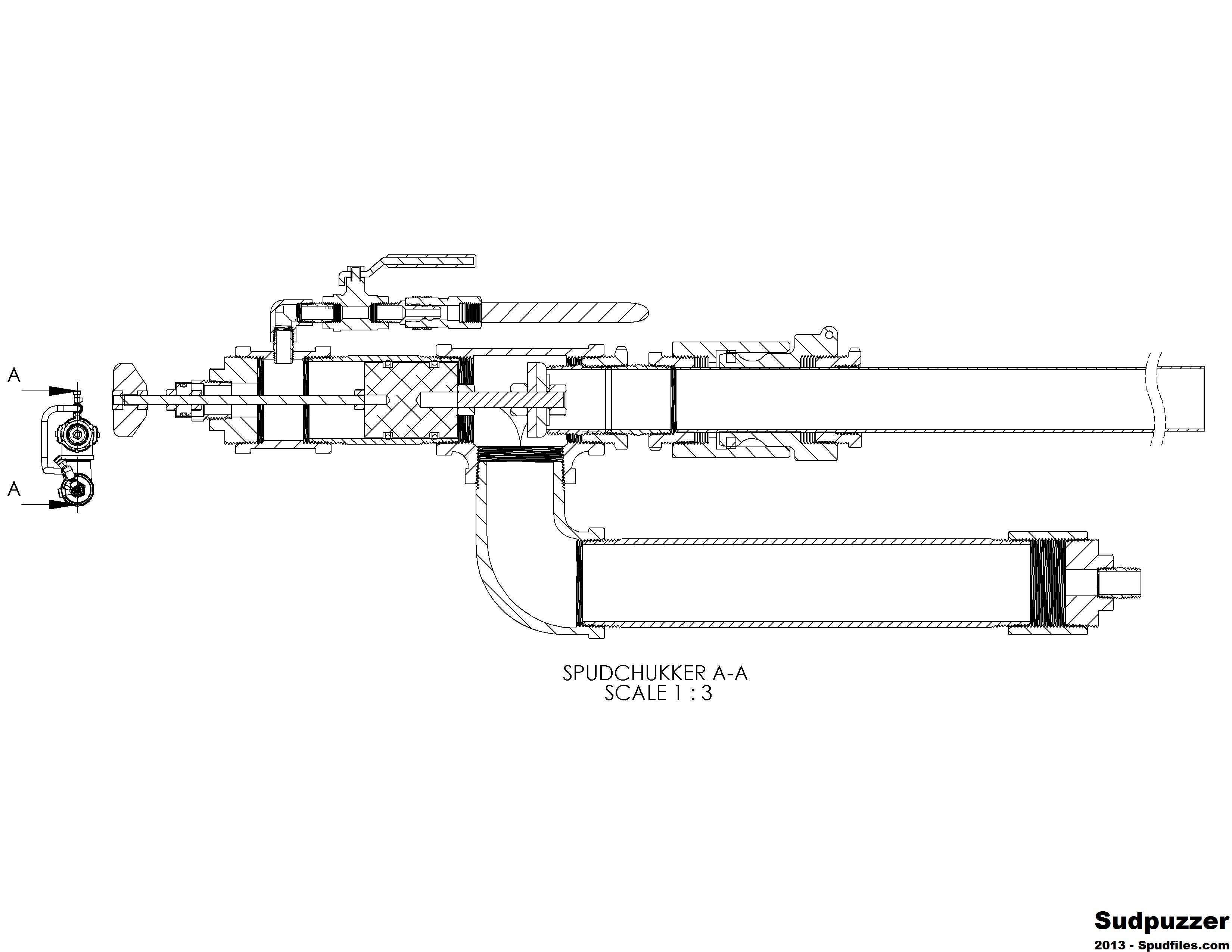

Or would I be better off with a design like this?
Spool type valves usually have 3 pistons, instead of 2. Any reason for this?
