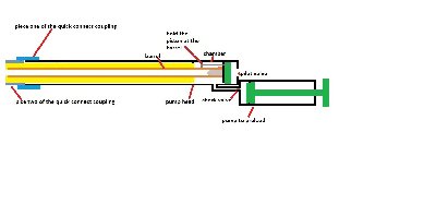

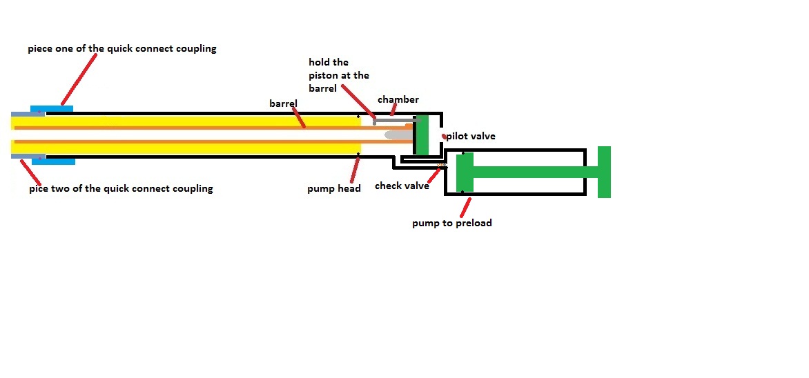

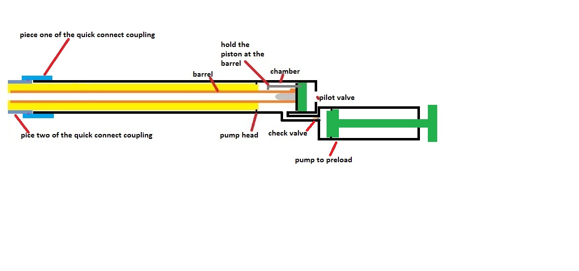

to precharge the pump tube high pressure isnt need only 1 or2 may3 bar to precharge the tube and for high pressure than the thinner diameter pump
jean
Germany
Posts: 125
Joined: Thu Dec 13, 2007 12:23 pm
here
It would work as drawn, certainly - but in terms of complexity, you're not really gaining anything by having two pumps in my view.

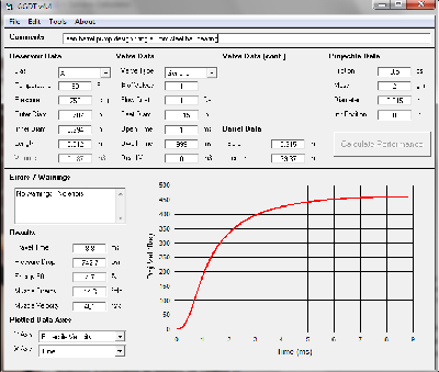

jean wrote:@jsr can you please ggdt it for me?
100cm barrel 8mm
chamber 3ml @100bar
Sure, not just yet though as I'm at work and don't have access to GGDT. What projectile weight?

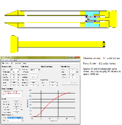

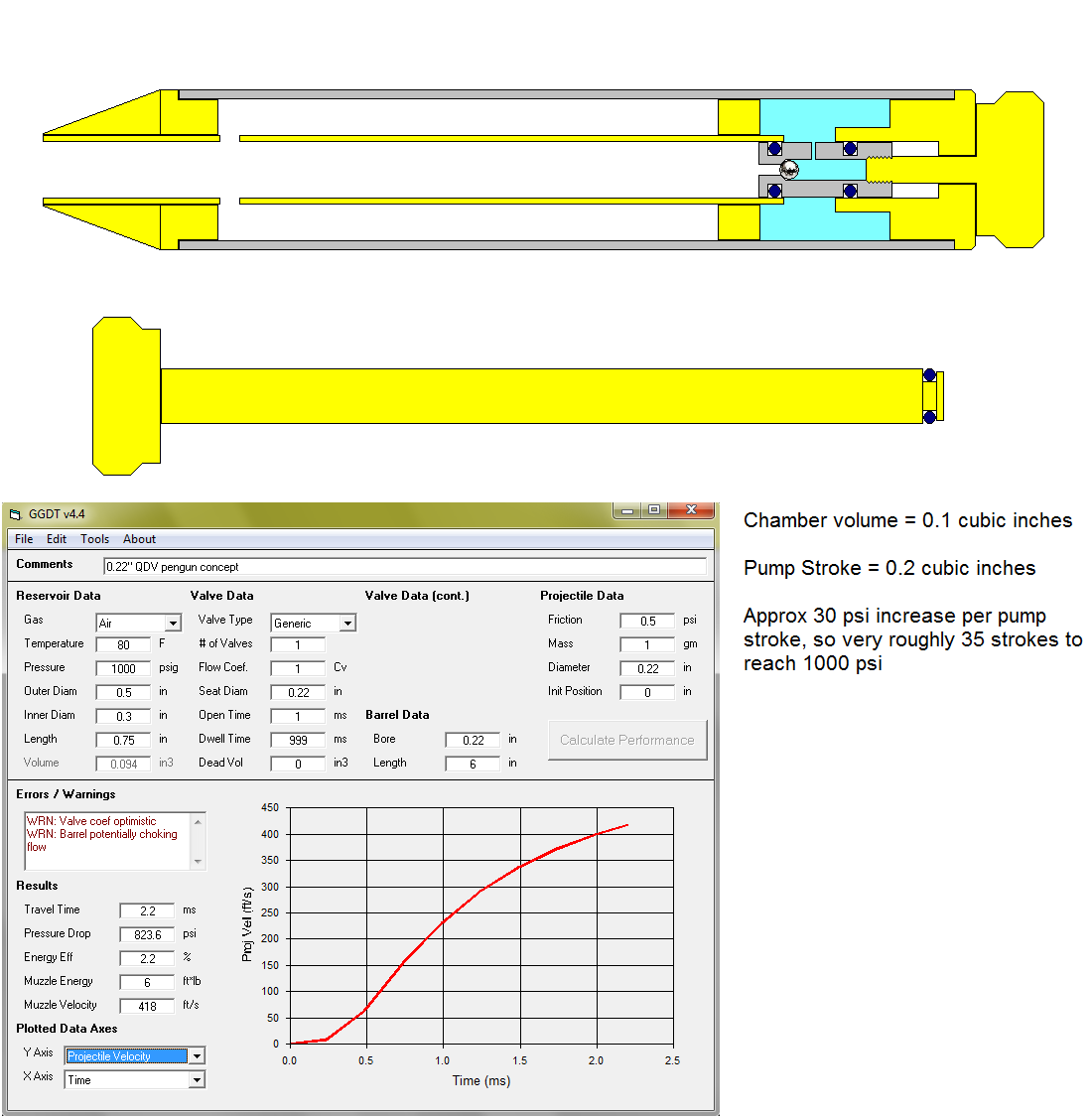

I was thinking along these lines here.
By having a 1x mix in a syringe and using that to pressurise a cartridge, any pressure you reach would technically be at the right ratio. Using it manually would naturally limit you to the pressures you can achieve through the pressure you can exert, so a possible solution to this would be modifying the syringe to enable the plunger to be pushed by air pressure
Coupled with Brian's concept here, hmmm...
Replace the burst disk pilot with a check valve, add some ignition points and a quick syringe squirt of butane/propane before inserting the pump head... profit!

I've been thinking a lot about that lately, it seems that with pellets it's the best solution. O-ring detents are a dead end because of the head and skirt, works for BBs but not for pellets.
Jamming a 0.22" pellet into a 5mm hole on the other hand, that holds some promise...

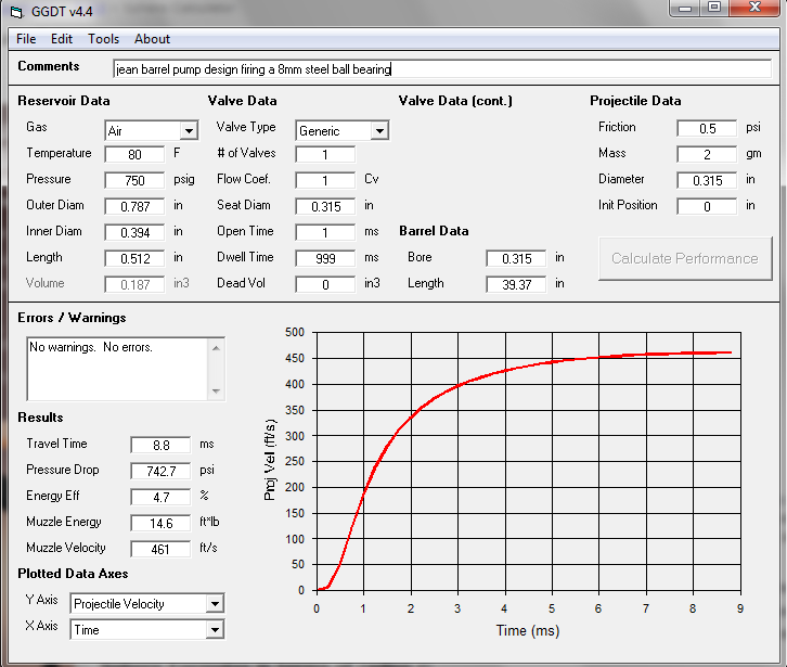

@jsr
s i know that hgdt hybrid why not as a piston hybrid projectile weight say 3g
Here it is in GGDT assuming an 8mm steel bearing projectile and you can get to a pressure of 750 psi / 50 bar.
Note that at that pressure and using a 20mm ID chamber you would have to push down with around 125kg of force... so start eating :D

Just thinking aloud here, hmmm...
Labtecpower
Posts: 1297
Location: Pyongyang
Has thanked: 5 times
Been thanked: 13 times
Should work I think, however the opening speed of your valve will be hugely limited by being fixed to the pulling rod..
you aren't going to manage a 1 ms. opening time on this one :D
Labtecpower wrote:you aren't going to manage a 1 ms. opening time on this one :D
With 1000 psi in the chamber giving a hand, I think it would ;)
Netherlands
Posts: 3497
Looks like that thing would pop as soon as the balance is broken... :D
Brian the brain wrote:Looks like that thing would pop as soon as the balance is broken... :D
My thoughts exactly :) might be worth building but lots of other projects on the table at the moment.
