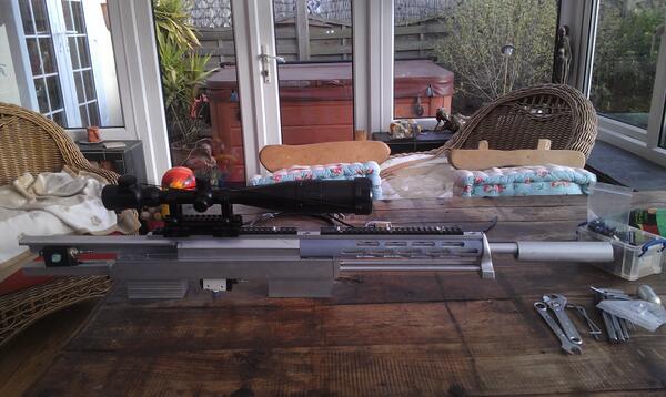

New milling vice has come but still cant use it, the one bolt i need i no longer have laying around have to get a couple tomorrow if possible.
So i have done what i can on it and got some more pics to share.
Main mag well with M4 stubby mags
3way and qev in there milled slots
qev set up with 6mm out let for pipe to bolt assembly
bolt assembly silver end will be going into a custom made hop up and mag feed assembly.

Quick update not done a great deal due to work and other things that come first. but i have put a large amount together.
and mainly working on internals and seeing if i can build a injection air reservoir for this gun.
Strive to be what you want to be, only the strong survive
