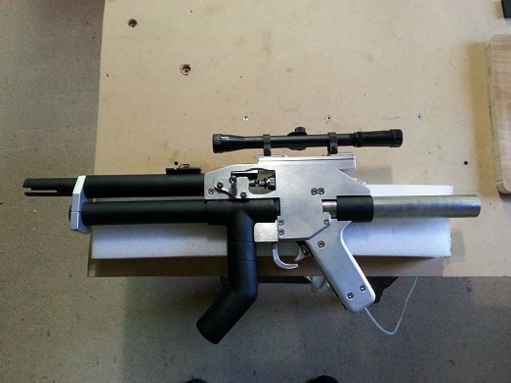

Stainless steel chamber upgrade work, the original PVC front part of the chamber is plugged off, will be doing a chrono test soon as well.
Re: Single shot airsoft
Posted: Fri Jul 06, 2018 8:14 pm
by hectmarr
Your work is very nice.

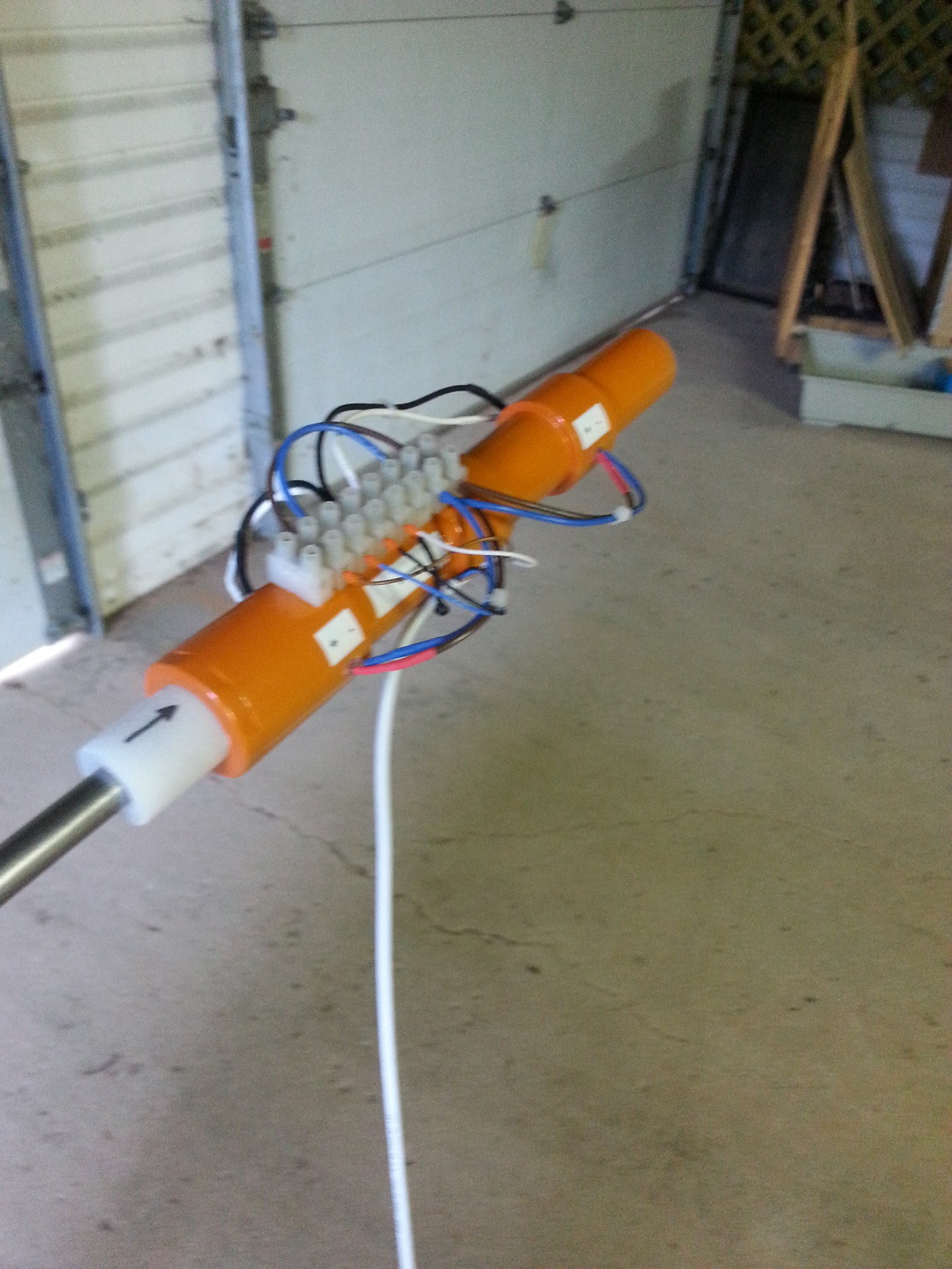

Did you build your chrono ? Looks like you were going to make one the same as I did (Jimmys), I used 2 pairs of 5mm photo emitter/receiver diodes (Ebay) spaced at 6" (0.5ft), powered by 1.5Vcell in the junction box. It works well and is consistent. I am using Audacity to capture the trace, it is tricky to read the spacings though, might try and look for another program with higher resolution.
Posted: Sat Jul 07, 2018 9:55 am
by hectmarr
I did not build any of this. Maybe in the future I will do it.

Looks like Audacity is as good as any, I think if I cut and paste the selected pulses and use maximum zoom it is easier to read, should get to test a couple of air soft tomorrow hopefully.
This is sort of what I get

Did the chrono test with 0.2g,
150psi = 694fps
160psi = 706fps
So looks like around 700fps with the pressure I can safely give it, that seems pretty good
Got to try the 0.12g now
Posted: Sun Jul 08, 2018 12:15 pm
by hectmarr
Interesting test and chronograph
I would build a similar one to yours, I would have to position it at no less than 20 "from the muzzle of the shotgun, because I see a flame, white fire, when I shoot in the dark and could damage the instrument.
