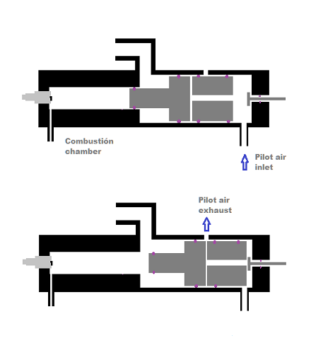

I built a valve like the one you use, but very small, it is for a future hybrid short gun. It works wonders and I no longer have the problem of burning the front seal, nor doing it, nor aligning it absolutely perpendicular to the barrel so that it seals. The smaller diameter is only 6.35mm and the larger piston is 8mm. I only bought about 50 6mm o'rings, which are what I used in the part that seals the combustion chamber. Add a system so that the pilot is open after the shot, because I need air to be able to come out of the barrel to clean the chamber immediately after the shot. It has a stem to close it before pressurizing with butane and air. When I can, I'll leave some photos here.

This is the drawing of what I built.

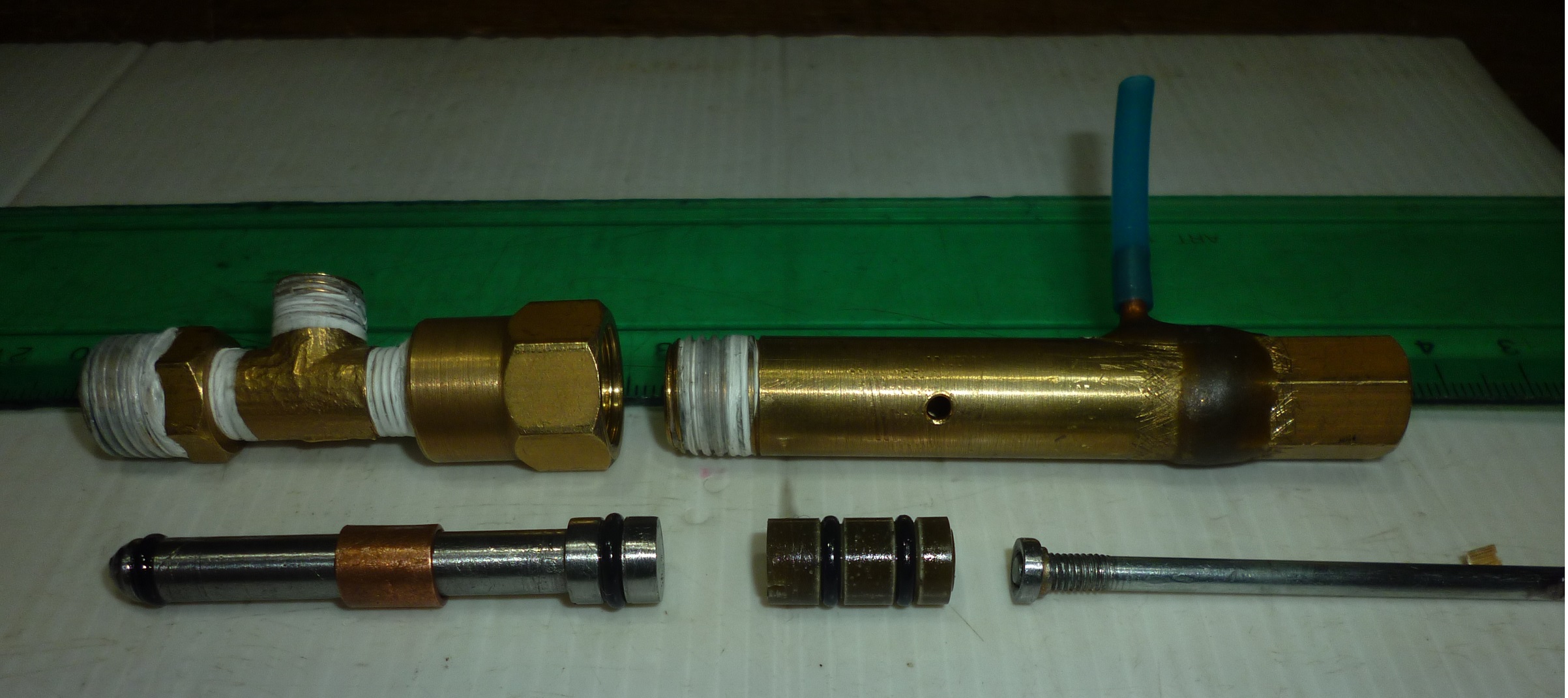

A photograph of how it was. I am building a mechanism so that it closes automatically. The small piston with two o'rings and the hole in the center is for decompressing. It is fiberglass because it only supports 6 or 7X pressure. The hard part is the one that seals the chamber.
I leave here in this publication what I did, because I think it is not necessary to make a new topic, it is a comment of the same.

Add what was missing to get the valve closed automatically. It works correctly, luckily. The valve closes when you let in compressed air and the pilot depressurizes immediately after firing.
The dosing system that I am testing needs to be able to decompress to measure the right amount of butane, it is of the volumetric type. I'm thinking of adding a 60cm firing cannon, with 12 microstriae that I bought a long time ago, caliber .25, and firing ordinary pellets 8-)
