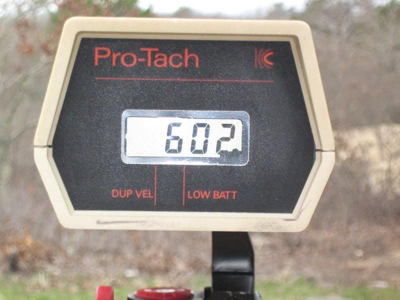

<img src="http://i116.photobucket.com/albums/o12/ ... G_0276.jpg" border="0"><img src="http://i116.photobucket.com/albums/o12/ ... G_0278.jpg" border="0"><img src="http://i116.photobucket.com/albums/o12/ ... G_0281.jpg" border="0"><img src="http://i116.photobucket.com/albums/o12/ ... G_0282.jpg" border="0">
The temp. was 53 today, yesterday was closer to 63. I ran the fan longer before and after shooting. These are the only changes from yesterday.
Had faster results. 483 fps was with one dose extra on the gas. 596 fps was the first shot of the day, 602 was the last.<img src="http://i116.photobucket.com/albums/o12/ ... G_0280.jpg" border="0">

that gun looks like a beast. im suprised you are not getting a higher chrony rating. thats still pretty good results though.
ya, and another thing is that maybe at 10 feet away you loose 10-20 fps because of drag. it may not be as much as 20 fps, but maybe 5-10. i have no proof of you loose that much, but its possible.
edit- so the muzzle volocity is not 602, the speed at 10 feet is 602 fps.
