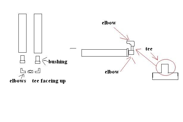

ok good you can buy sprinklers at home depot and if you want 2 chambers i would make them 3" then find out what size barrel you are useing (we'll call this x pipe) and get two 3" to x pipe bushings. then i would get three x pipe elbows and a x pipe tee. assemble it like this with little peises of pipe inbetween the fittings. make sure all the fittings you buy say NSFpw DO NOT BUY ANYTHING THAT SAYS NSFdwv
right after the elbow on the top attach your sprinkler useing a x pipe to 1" busing and a 1" threaded male adapter. do the same thing on the other side of the sprinkler
EDTI:also i forgot to mention you will need 2 end caps and a shcrader valve
