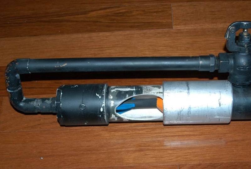

here is a few examples of how you can do a breach load.

As to breech loading, I would recommend a sleeved barrel as per grumpy's last illustration.

And also what about the structural design? Would it be good how i have it in a straight line formation, like a bazooka/rocket launcher, but the recoil and the weight wont kill my shoulder?
I was considerering the design that grumpy had for the third picture but i havent seen it used really so i wasnt sure if i should use it. Also for that breech load, would i need to lock it in or just sleeve a pipe?
And since i have never done a breech load, would a hacksaw be fine to use? I think i can but it would just be difficult.

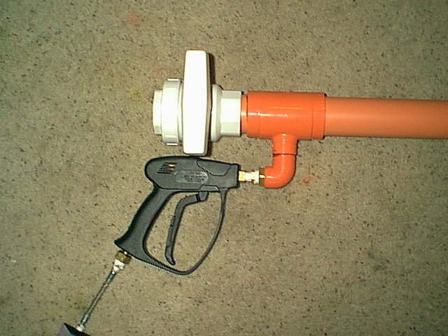

I don't mean to hijack your post here, but what is that second breech load setup called?

Idk but it looks like a ball valve to me but idk whats its called.

The flap thing in the first pic is also in the second design, do you know what they are called? The thing just after the union ion the first pic is what I am referring too.
I'd go for a properly braced over-under, otherwise you'll be severly limited for length.
It's quite a common design, like these examples by Novacastrian and SpudBlaster15 - all you need is piping that fits snugly on the outside of the barrel and a couple of o-rings. You can either have it one piece and slide back and forth, or cut a projectile size hole in it and rotate it for reloading. No need to lock it, and a hacksaw should do just fine.

the first picture used what is called a slice gate valve, it is the same valve used on rv's to dump waste.
the second picture is just a simple pvc ball valve.
the third picture is a slide breach in 2"pvc, just take a piece of 2"pvc to a auto parts store and get a 6 or 7 inch piece of tail pipe that slides snuggly over the pvc.

Ok thx for the replies but i dont know how i can get 3 i can O-rings. i have seen that design before but i didnt know that they were the same in a sense but now i see it.

if you use the slide breach like in the bottom pic, the metal slide fits tight enough that it does not use orings and it works very well. actualy none of the designs use orings
