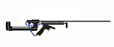

Ah wow... So much information to absorb hahaha. Do you have a link for your copper coax Law? I was considering a Coax over a T valve by a long shot but I've never soldered before. Thats why I've decided to go with the T valve. It will all screw together.

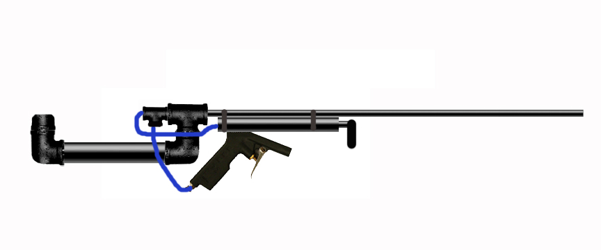

Here is a rough diagram I made on photoshop that will give ya's a rough idea on how it will look. I just stuck the blowgun there for the hell of it but Choas suggested that I use a 1/4 ball valve trigger like what Jack uses on his. Damn good idea concidering I love the whole "pop off valve trigger feel.
Any feedback on the design would be more then appreciated.

why not make one like this?
http://www.spudfiles.com/forums/bb-snip ... t9584.html
or this if you want a screw together coax?
http://www.spudfiles.com/forums/spudthu ... t9625.html

Thats a nice cannon there. only thing I would change is that i would make a simpler stock.
instead of using the pipe and then the elbow, go to a larger diameter through a reducer fitting and then screw and encap onto the back of it. it uses larger, heavier pipe but its much more comforatable.
if youre still gonna use the elbow, point it downward. it would stink to have the gun uncomforatable to hold because your face has to rest on a giant peice of steel pipe.

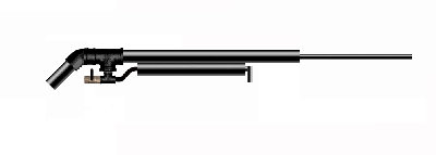

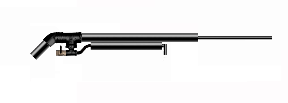

Ok guys this is the idea i was talking about. Gotta love thinking of something cool on the spot
I've never seen anything like this. I can't wait to make it and make history hehe.
The nipple between the eblow and the larger tee will be filled with epoxy to reduce the pilot by a hell of a lot as apossed to capping the end of the pipe off the elbow.
The piston will be made out of epoxy more then likely and will sit in the beginning of the chamber. The epoxy plug will act like a wall so I can add a spring behind the piston.
Everything else on it should be pretty self explanitory to the people who know the principles behind Piston Cannons. Any questions, please give me a buzz.

Actually I use a schrader to trigger my 6mm piston pneumatics - I can afford to because the piston is only 1/2" in diameter and moves back less than 1/8", so the pilot volume is approximately that of a very small insect's left bollockMitchza89 wrote:I just stuck the blowgun there for the hell of it but Choas suggested that I use a 1/4 ball valve trigger like what Jack uses on his.
