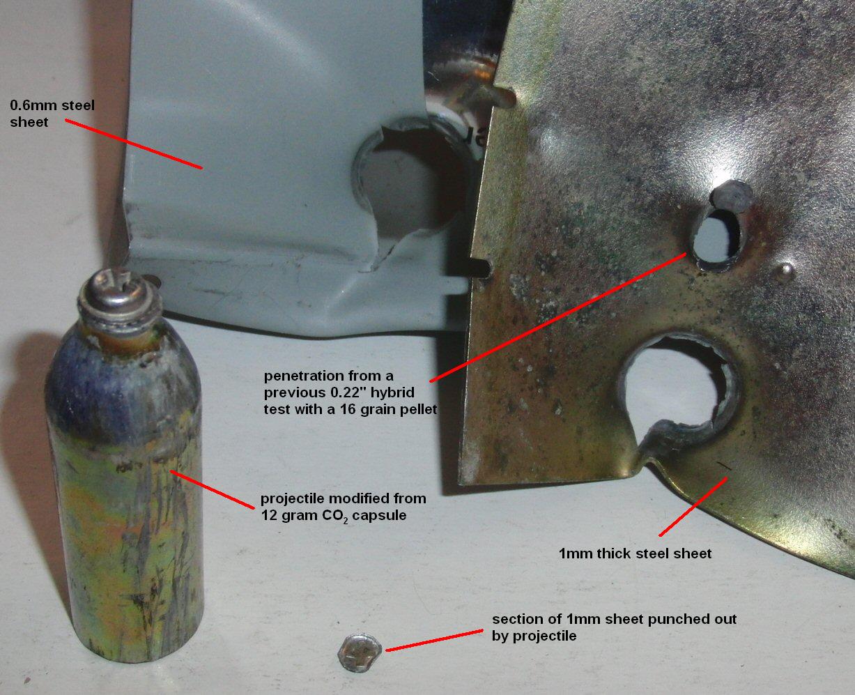

edit: took the 0.75" hybrid to 20x fired at 1mm steel plate over a 0.6mm power supply case, it didn't penetrate fully but still, impressive damage.
Too bloody loud though, there's enough propane/butane in the chamber to fuel a 500cc combustion :roll: not going to fire it any higher unless I make a barrel extenstion with a suppressor.

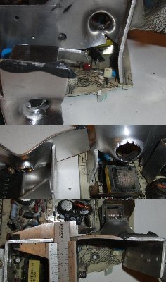

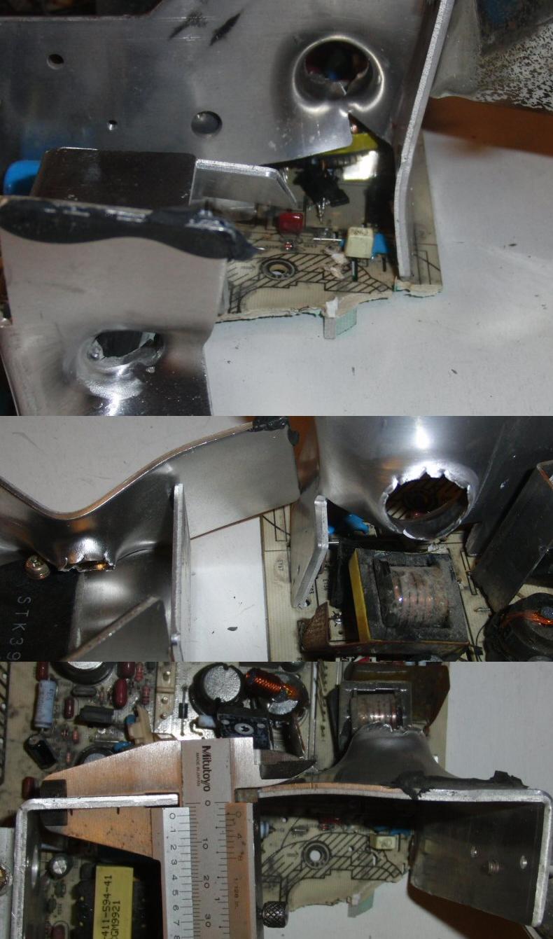

Here's an old Sagem cellphone donated years ago for target shooting purposes, finally being put to good use, 20x and 1000 frames per second ;)
Target is the 3mm (just under 1/8") alloy heat sink from the CRT monitor board that gave up the flyback ignition (does that count as self harm :D), fired at with an unmodified CO<sub>2</sub> capsule at 20x.
The projectile went through the heat sink but was stopped by the heatsink behind it, some photos showing entry and exit holes as well as heat sink thickness:

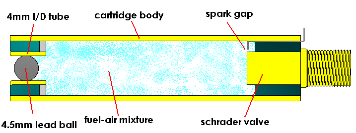

have you considered 'swagging' your cartridges ??
lead is pliable and ductile, right ?
well if you build a cartridge with a sort of lip/recess, let say 0.5 cm from the front, you might be able to force a lead ball into the cartridge and achieve a perfect seal
Damn you might even build a special press for it (and include an automated metering system that first fuels the chamber then inserts ammo and seals the cartridge)
POLAND_SPUD wrote:have you considered 'swaging' your cartridges?
You know, you might just be on to something.

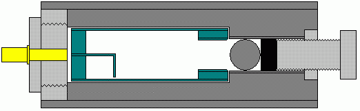

That sort of construction is a bit involved for someone latheless, I'm thinking more along the lines of taking say a 5.5mm pellet and using it in a 5.0mm barrel. I'll have to built a test rig however to determine what pressure they will effectively hold (because now I've gone 28x, anything less seems rather homosexual :roll:) and if it will indeed be a perfect seal.
Sounds slightly ambitious, but I can see myself making something like this. Open cap, insert projectile and cartridge, close cap, insert fuel through schrader valve and pressurise, then turn swaging screw to seal the projectile in the mouth of the cartridge.
edit: modified diagram for clarity

google 'reloading arbor press'
Well, who said you need a shrader ?
:wink:
Yeah, I know it seems simpler to have shraders.
Though if you ever build an automated metering system for it you might as well get rid of shraders (well at least that would simplify cartridge design) and fuel through the same hole where the bullet is forced.
Yeah I know I know sounds horribly difficult to build but if you are to achieve world domination you're gonna need a lot of cartridges
POLAND_SPUD wrote:Well, who said you need a schrader?
The schrader is part of the filling system, I modified the diagram so it will be clearer. Air and fuel are charged through the schrader and enter the cartridge through the mouth.
Given the disappointing micro hybrid test at 28x, I doubt that the kind of performance needed for world domination is achievable with a rifle sized cartridge :s
Technically speaking you need manometric metering system* and two valves... two cams somewhere on the press and you've got a system that opens and closes the valves when needed so you just have to insert the cartridge and operate the lever

Anyway, crude prototype currently curing looking something like the diagram below and about the same size as the micro hybrid chamber. The plan is to see if it can retain pressure at all, if so to what extent, and then chose a close hybrid mix and go from there :)
