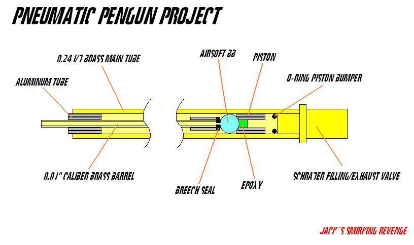

didn't check if anyone already asked this (i know, i know...) but what material are muzzle and breech parts, i mean the silver color parts glued to the barrel? also sorry if im posting on some old topic.
Posts: 26220
Been thanked: 352 times
Aluminium, but I've had good results simply wrapping masking tape around the barrel and gluing the whole thing with araldite:
http://www.spudfiles.com/forums/mini-0- ... 20101.html
Good for 800 psi at least ;)

what else than masking tape could be used to make the cap to the end of the chamber
Posts: 26220
I'm sorry, masking tape is really easy... if that is too much for you then maybe you shouldn't be making it...
