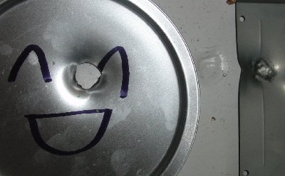

My copper spudgun is struggling with only 1 layer of this stuff
mini hybrid win!

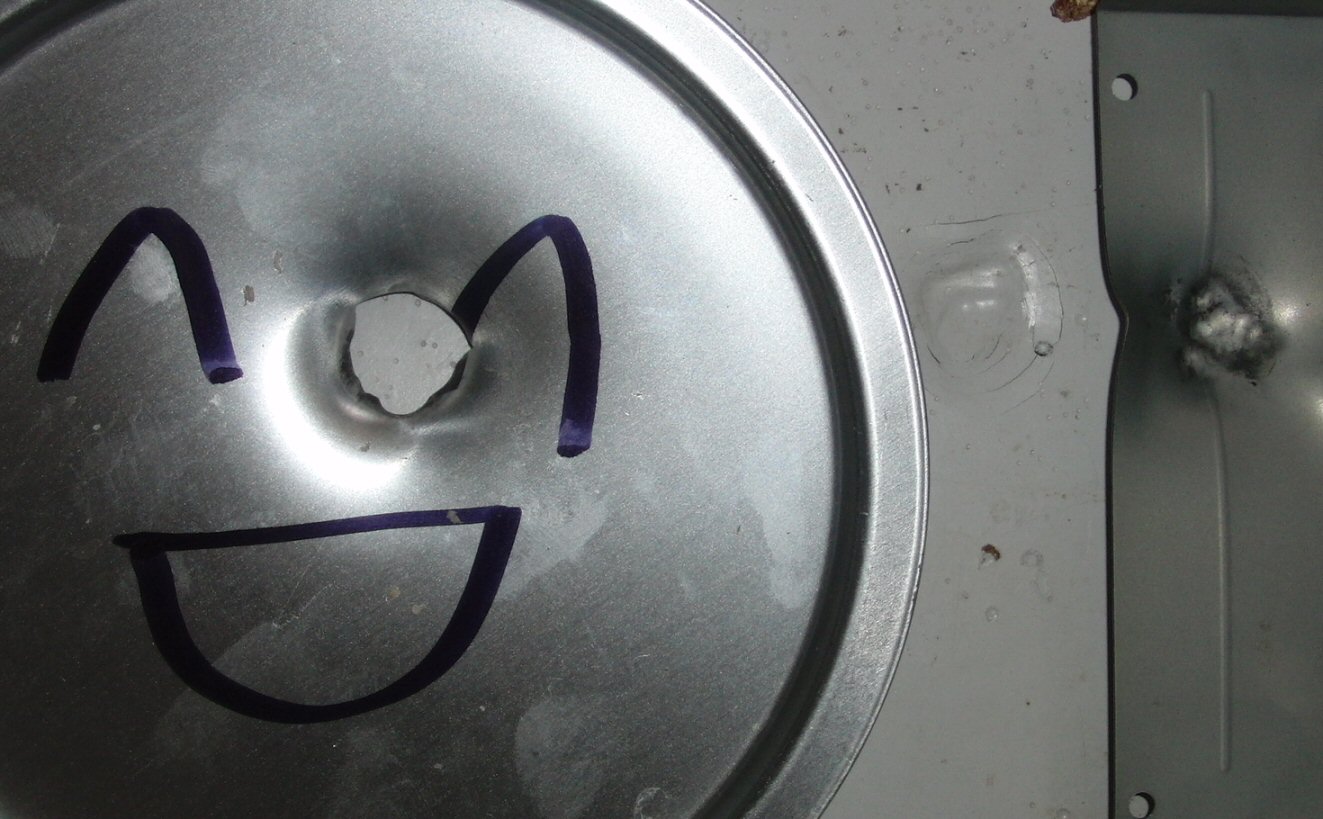

Tried another shot at 15x with 7 x 0.177" lead BBs, still too close to the target to get a good spread though.
The damage to the steel sheet and the wood backing it is also impressive, if the wood wasn't backed by a granite slab there's a possibility the lead would have gone through.
