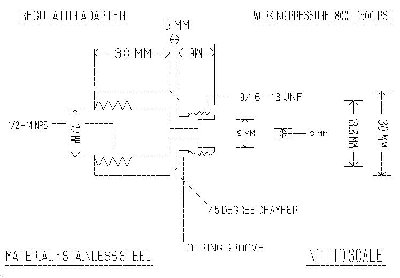

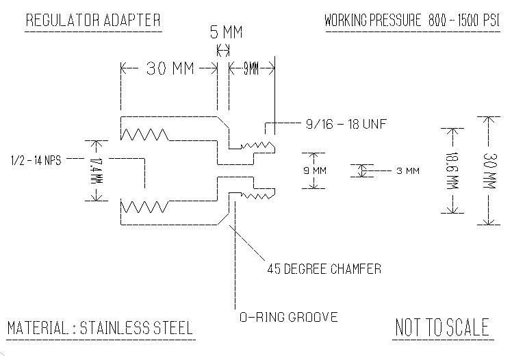

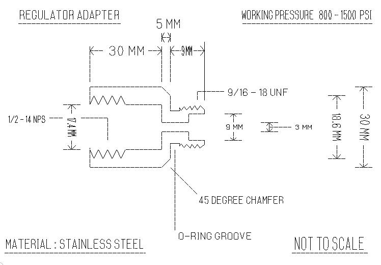

You're missing the depth and width of the o-ring groove, and the depth of the bored section on the side with the male thread.
You're also missing the alloy and heat treatment required (I only see "stainless steel"), as well as all of the tolerances.
Goats spudz
- Specialist 4
- Posts: 458
- Joined: Tue Aug 02, 2011 12:31 pm
The machinist making it made me something before with the male side of this diagram on it, i told him to do it the same and the alloy and heat treatment dosen't matter as it will be made with off cuts, the tolerances are the same as the old part (he knows this) 0.04
