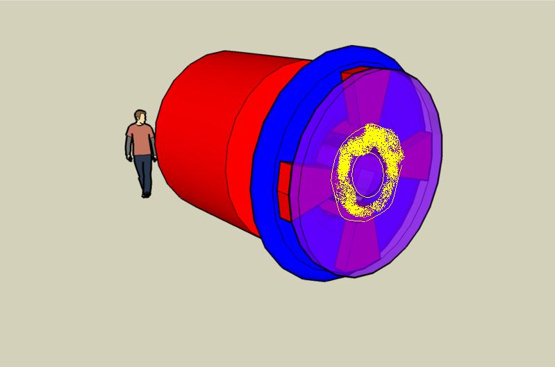

this is the difference in surface area
yep its pretty crappy

- yep its a crappy diagram
- area.JPG (27.5 KiB) Viewed 4062 times
Can you explain why? And does that mean the bolt will work?

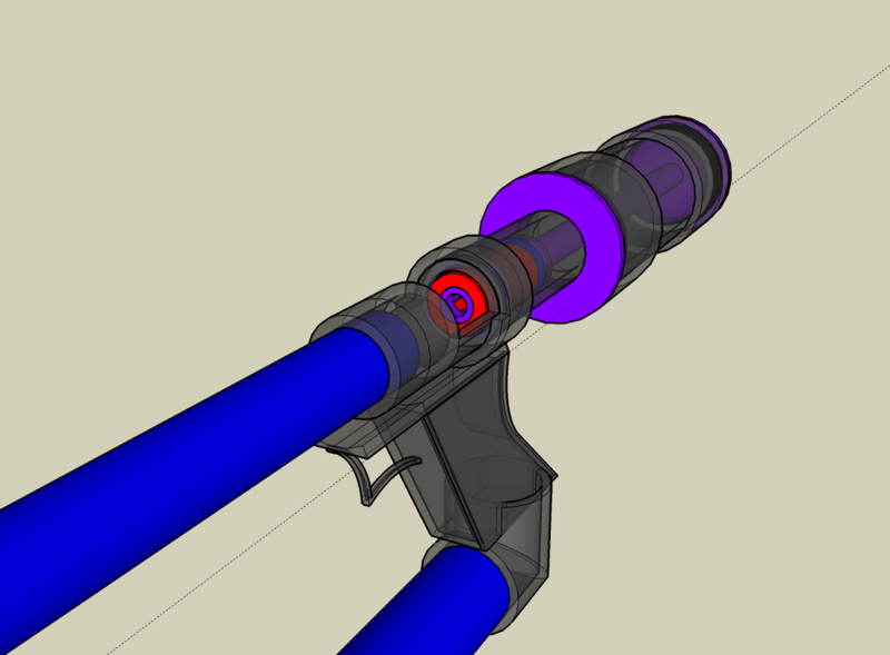

Anyways if it does work, I'm going to build a prototype to see just how fast the bolt moves. I designed it so I can build all of it using cheap, durable, light weight, and available materials from Mcmaster. I put together the order list and everything will be under $50.00. Its a prototype because it will only have the firing chamber and the 3 way valve. Instead of building a separate airtank to hold all of the air at a high pressure and using a regulator to bring down the pressure to something safe, I'm just using a
pump to fill the chamber. I also made the firing chamber larger to compensate for the lower pressure that will be used.
Here's some picture of the design, pretty close to scale.

the area I painted yellow is the area where the chamber's pressure is not countered by the pilot's pressure, that means when the system is pressurized the force will be greater on the chamber side and it will not close, just try a non telescoping system
The purple section is not part of the bolt, its the bolt rod. The bolt rod acts as a stopper and covers the back part of the bolt when the chamber is being filled. The actual bolt and the o-ring are the only parts that move. So wouldn't the front and back of the o-ring determine if the bolt stays?

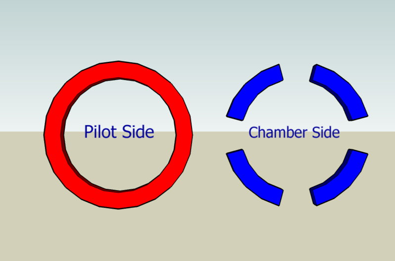

Here's a diagram of the o-rings front and back:
The bolt rod covers the back part of the bolt and since it can't move, it would make it so only the o-ring is the only exposed part that matters.

in those areas pressure is applying to the o-ring, and you forget the entire inner ring/layer that I highlighted

I don't understand how the inner layer tubing would affect it. The bolt stopper completely covers it.

you'll have to keep the length of the ion, the wider part near the back in necessary to balance to force, the makers of the ion wouldn't have made that part longer and increase the dead space if it was so possible to make the forces equal, but your design currently is physically impossible to make balanced because the plug seal is inside of the pilot seal, and the difference of that plug's OD and the smaller diameter of the pilot is the difference in the pilot's surface area and the chamber's

The plug seal isn't only inside, it covers the entire backside too. That's why there is more SA when the chamber is being filled. The bolt rod is stationary. The forces acting on the plug don't move the bolt because the bolt moves seperate from the bolt rod.
