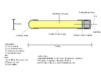

Hur? Where do you get $300 and titanium and dangerous propellants? The one I saw used some PVC, some N20, and some ABS shavings.
Well, hybrid rocket produce a lot of power and pvc is not designed for that...

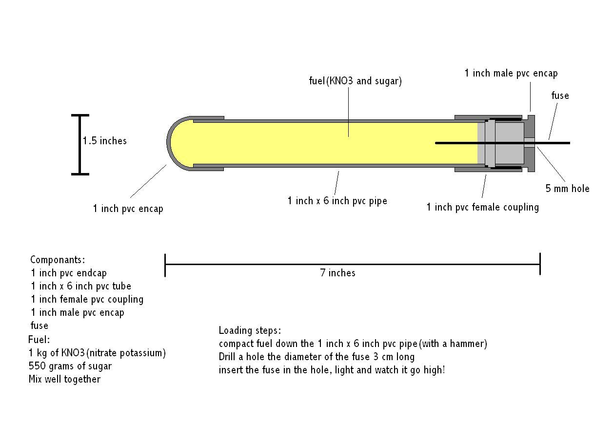

I see a few problems here. The first is that the PVC "nozzle" will become a full-bore hole in a very short time. The second is that the hole you show is likely too small, and will result in your rocket turning into an expensive, time consuming firework. Somewhere down the list after that are the facts that your rocket design is nowhere close to aerodynamically stable, and that you are using over 3 pounds of propellant in your first attempt at a rocket.
On the subject of hybrid rockets: While the technology is perfectly accessible to the average hobbyist (and you certainly don't need titanium, tungsten, or any particulary dangerous materials), oxidisers can get expensive. For the small scales that most sane amateurs would be working with, this isn't particulary problematic. When you're using almost 10kg of fuel alone, well... :roll:
What????
This model just use approx 50 grams of very basic fuel...

What????
The diagram says, very distinctly, 550g of KNO<sub>3</sub> and 1kg of sugar. That's 1.55kg, or about 3.41 pounds. You might want to take a look at the plan YOU posted before making comments :P

???okay, try to put 3 lbs in a 1 inch x 6 inch pvc pipe.
I dont know exactly how i need, so i make more fuel then i need, thats seem logic for me.

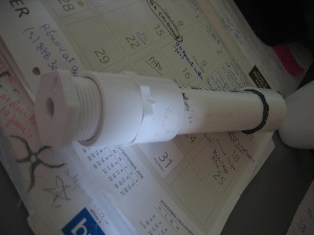

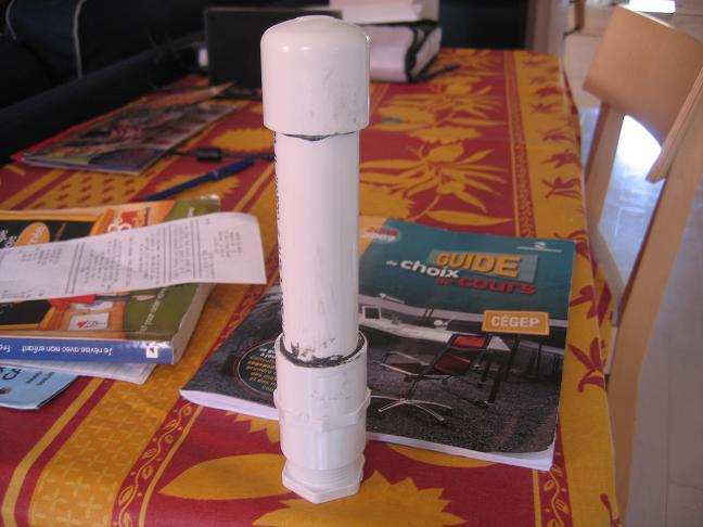

i just went to rona, based on the plans just there ^.
rocket butt!
rocket butt!
Photo 032.jpg (27.93 KiB) Viewed 3264 times
Rocket!
Rocket!
