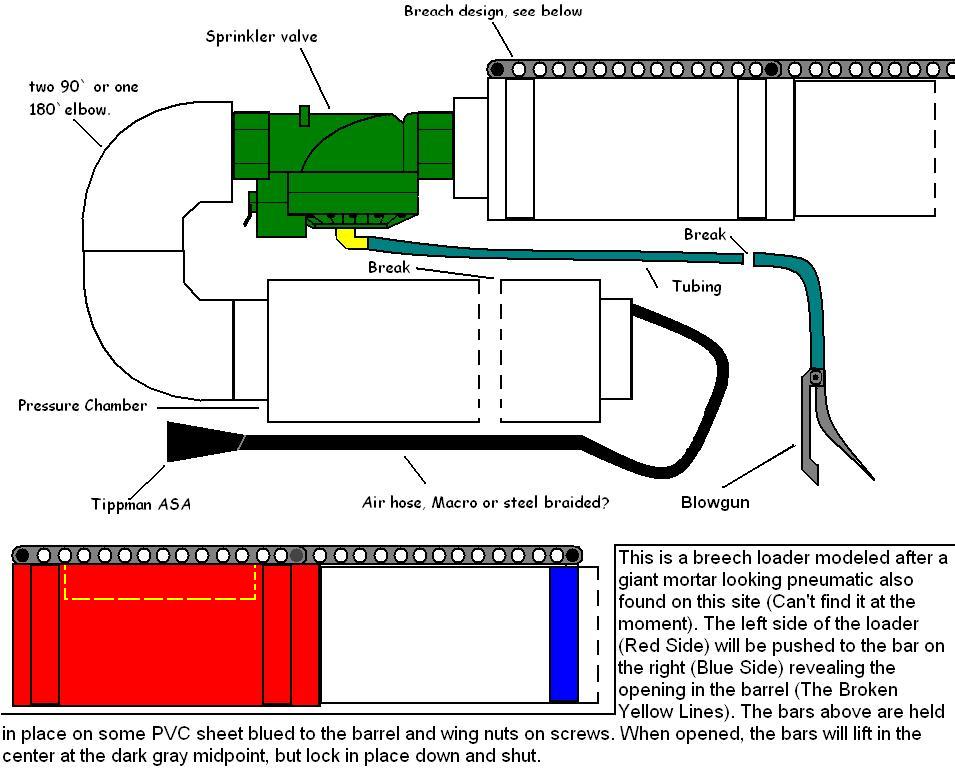

Hey! I'm a paintball player in the North Carolina Triangle area, and my friends and I may be making a team soon. Well, our rocket launcher recently broke, and I've been trying to make a better one for when we get a sponsor. I've had some experience with very simple pneumatics before (read:ballvalves). So, i checked out your wiki, saw some plans and some pictures, and now i think I've got an idea of what to do. My real question now is, "Will It Work?" If you could help me out here, that'd be great. I just want to know what could make it more efficient, smaller, more paintball accesable, etc... I'm going to put it in a shell to make it look better, probably a bullpup sort of thing. For those of you who don't know, thats when the trigger is in front of the ammo feed and firing mechanism. Speaking of ammo feed, do you think that mine seems prety good? It's an alright breech loading system, with a low profile for getting rid of gear shots. I had rigged up a little example using some spare tubing and some of my little brother's KNEX, and it seemed to work alright. I'm still trying to think of ways to make it better, so if you could help out on that too I'd apreciate it. I'm really trying to get rid of thepressure chamber, but would that raise the PSI too much? Thanks for your attention, hope you can help!
These are the plans I would really like help with.

I dont see any reason why it wouldnt work, but you may encounter problems with breach loading and higher pressure, though personally i've never done a breach loader. The airhose dosnt matter as long as its rated to the proper pressure. The steel braided hosing might be easier to work with.
psycix
Posts: 3684
Location: The Netherlands
Beware when using long hoses.
The longer your hose, the more pilot volume you have, the slower your valve opens.
Spudfiles steam group, join!

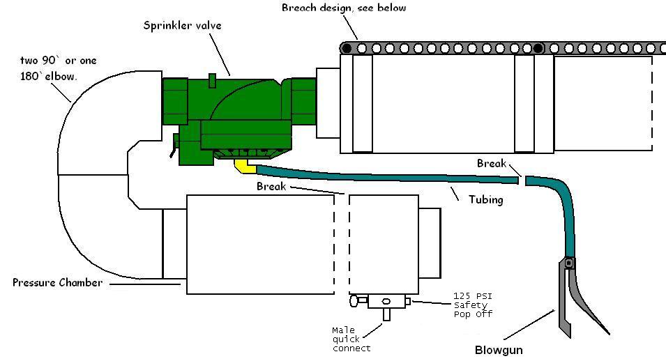

Ok, so I'll use some short (thank you psycix) steel braided hosing (thank you rp181), probably from tippman products. But do I still need the so called "pressure chamber" (please see drawing for details), or can i connect the air supply directly to the sprinkler valve? This would be ideal, as I am constantly looking for a smaller version of this thing. Thanks for the advice guys, anyone have anything else to contribute?

you do know that a sprinkler valve is only rated to 150 psi, and the smaller the pressure chamber the more pressure you will have to use.
and yes you will need some sort of pressure chamber.
judgment_arms
Posts: 1272
Marlowe!
sorry I didn't find your thread sooner.
you told me you were building a tank gun, I thought you meant a main gun for a tank, not an AT weapon. :?
sprinkler valves don't lend themselves well to man-portable, compact, cannon.
they require long barrels and a large pressure chamber volume.
you going to want a good piston valve, preferably a chamber-valve like the ones used by Biged and myself, or the valve used in Clide's golf ball semi.
chamber-vlaves (also known as inline valves) are compact and powerful, being no bigger than a pressure chamber but with the speed and flow of a piston valve.
depending on the pipe used, they're also capable of running at a high pressure
another thing to consider is burst disk cartridges of similar design to what Davidvaini has come up with.
understandably, building such valves might be a little to complex.
one might try using two sprinkler valves, the improved flow might allow for shorter overall chamber and barrel length.
by far though, best thing would be to get a good 1.5-2 inch QEV, I'm getting +250fps off of a 13inch by 1.5inch chamber and using a 7inch barrel, which allows me to just stuff a NERF right into the end of the barrel making it incredibly quick to reload.
not to mention loud enough to leave your ears ringing. :D

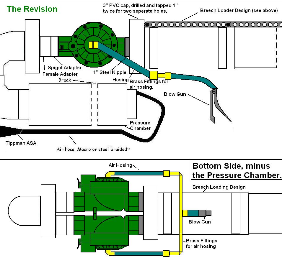

Thanks a lot for the advice guys! I'm getting really excited about this thing, and trust me when this is done I'll be coming to you for more help with other launcher designs. So, taking into account everyone's advice (and being stupid in Spudtech and not wanting to make complex things), I have the revised edition of my plans. Anything else you want to help me out on with the design would be greatly appreciated. I didn't really label anything on the bottom half of the plans, but I'm really tired after wrestling practice and really must get to bed. Please note that if I didn't mention it in the upper diagram, I didn't change it. Thanks again.
The revised plans, for your critiquing.

Looks good.
Only comment is that I would use a piston valve instead.
