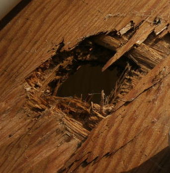

Gumballs shatter too, but it surprised me when one went through a sheet of 1/2 inch plywood. With enough power, he might make it. :D

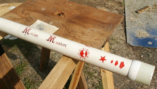

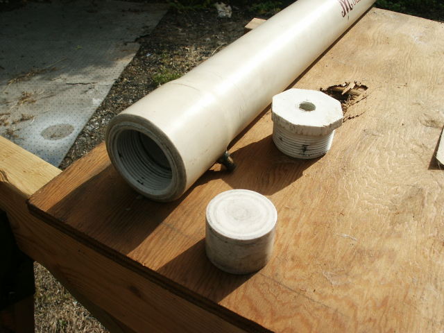

Edit*** Added photo of the 1 inch coaxial cannon that shoots gumballs through the plywood. Blow gun trigger is used on another project. This cannon is retired as it was dropped once too many times and the muzzle coupler and reducer cracked and leaks. This cannon broke 3 pistons.
Hole in 1/2 plywood from a gumball.

Mouse musket breech disassembled on the sanding board.  The hole is from a gumball shot.
Mouse musket, muzzle view.  2 inch chamber 1 inch barrel coaxial air cannon.
