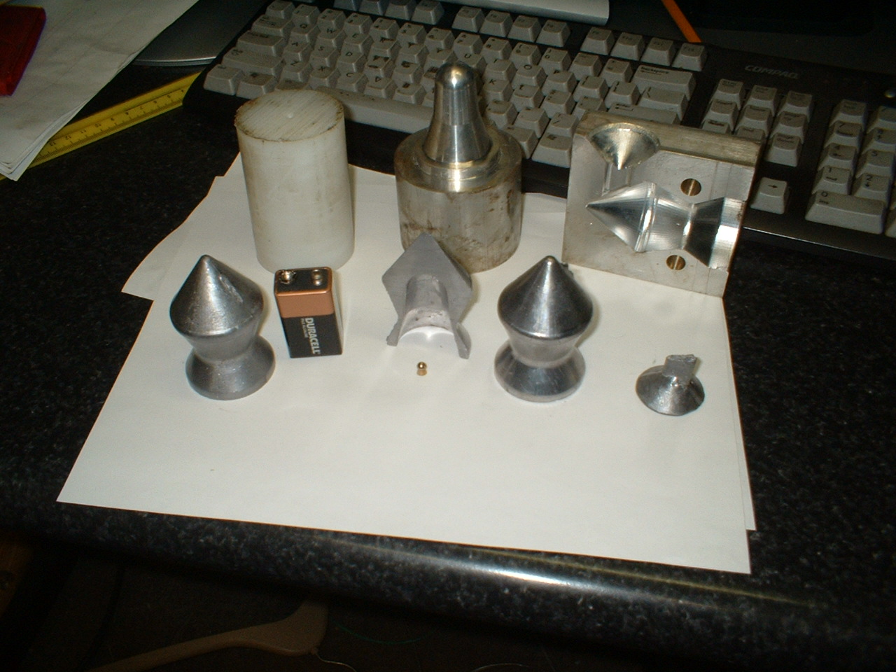

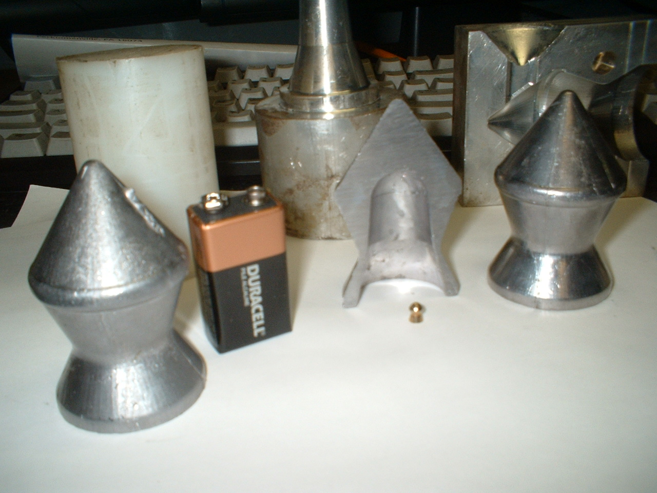

JSR, Found some time to set up the pour. We had to heat the molds to around + 375° F before the tail started to fill nicely. Note the 9 volt battery and .177" (4.5mm) pellet in there for scale. Also a 2" UHMW blank for a pneumatic round we are planning. Oh, one of the first pellets that did not fill 100% was cut in half to show the skirt profile.
First pour of 1.6" lead rounds
Has thanked: 581 times
*Expletives scarcely repeatable in polite company*

Beautiful, have any been fired yet? What does it weigh compared to a typical potato slug?

Math says it should weigh .811 lbs, or about 368 grams.

The things you can do with a large machine shop. Yes, "It" does work well but there are a few technical issues. I do not want to steal his thunder. Another thing, I made the pellets to 1.5 sched 40, his test gun has an aluminum 2" sched 40 barrel. Oh well. When the VMC is open, there is a larger mold gonna be made...

Those "pellets" are amazing. With the weight of the 2" bore pellets nearing 1 lb and the new prototype easily running 200PSI (max current shop pressure) should be some serious energy. Replacement O-rings should be here soon!
I like that you included the UHMW slug.

Oh dude...this is a little too cool to be real. I wonder how straight they will fly without rifling. I want one!

USGF wrote:JSR, Found some time to set up the pour. We had to heat the molds to around + 375° F before the tail started to fill nicely. Note the 9 volt battery and .177" (4.5mm) pellet in there for scale. Also a 2" UHMW blank for a pneumatic round we are planning. Oh, one of the first pellets that did not fill 100% was cut in half to show the skirt profile.
Will these molds be for sale at some point? Or would I have to come to you as a client? If for sale, any idea on a general price range for say a mold for 1 1/2" SCH10? I would love trying different materials to make the pellets out of. I have a rifled barrel that would be wicked with wax pellets or a more durable yet soft material.
