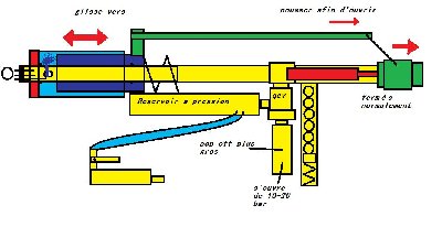

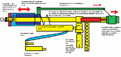

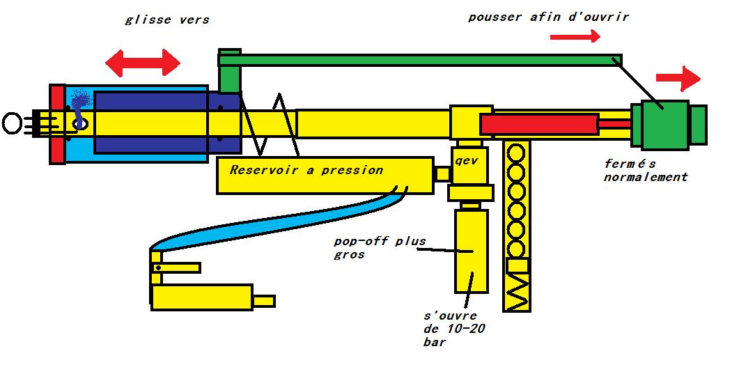

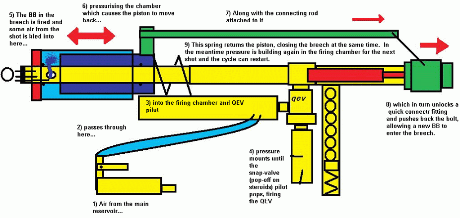

Edit: Only fair to post the diagrams I made for the French here too:
Everything is working the way it should..
You'll get it when I finish it tonight.
I will have to cut some of the grooves inside of the QD to have it disconnect smoother and add 1 or two extra rings to the spring.
Maybe it's just a little hard to get from a picture.
I know I have been staring at other people's pictures before thinking WTF??
I have tried it on the gun.
The bolt remains locked untill the sleeve is pushed back.
Right now it's hard to push back the sleeve while the bolt is under pressure ( while I'm pulling it) but my adaptations should make it open smoothly.

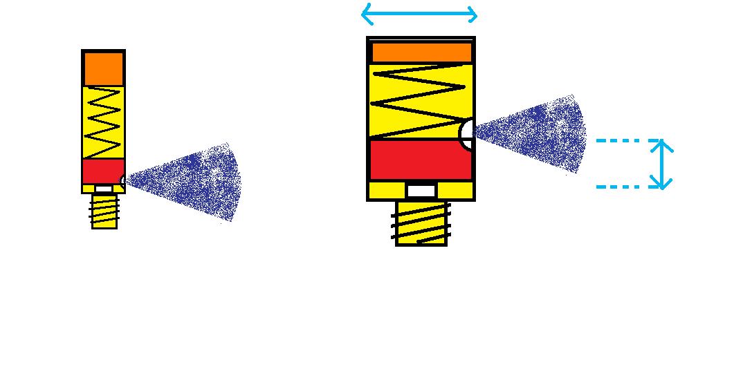

The crucial point is as follows, if the piston seals over the exhaust port and needs to travel further to reach the seat and reseal the valve, it will never reseal because incoming pressure will push it back et voila, une machine flatulencesJSR was using an airspring perhaps?
As good as that sounds, it brings friction into play...at least I could not get my airsprung snapvalve to work properly.Too bad, it seemed ideal in theory.
In the case of this valve for example, the piston is not airtight so port position was not as critical:
