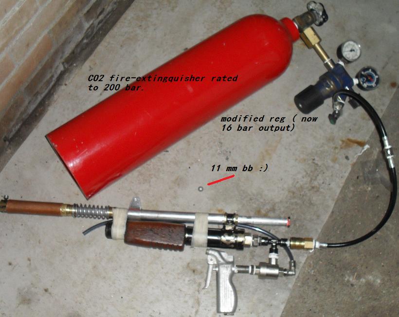

As I was very impressed with the forced blowback design wich was entered in the last competition I felt I had to go for it.
So far I have made the barrel ram wich is supposed to cock the system.

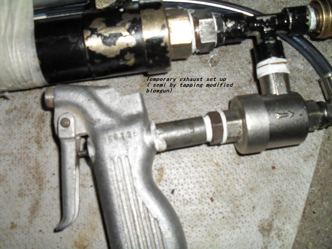

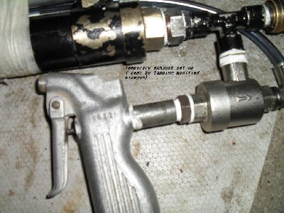

For the moment I made a simple pilot system wich I can fire semi style if I tap the trigger under constant flow.
I plan to get a new QEV for it, modify it and pilot it directy with a pop-off, as I have done before.
The incoming air will be handled by a blowgun, but this time from the reservoir side.
Wich basically means I can place it anywhere and I intend to go for ultimate bullpup.
I'd like to call it the BAR as in Bullpup Assault Rifle, with a wink towards the metric scale for pressure.
But as I have not yet performed the feat of rifling succesfully..I guess
Bullpup Air Ram will have to do.. :wink:
Pictures speak louder than words so I took some pics of the early stages.

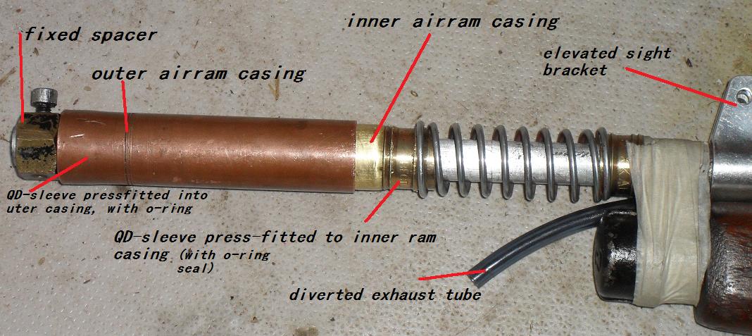

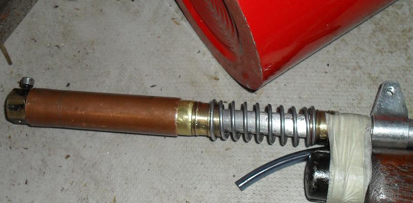

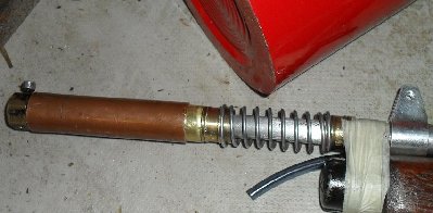

I built the airram with stuff I had lying around and miraculously everything fitted together to form a 95% airtight ram.
It's co-axed around the barrel.
I press fitted QD sleeves into some 28 and 26 mm pipes and some O-rings into the QD sleeves, wich I superglued in place.
I need to fix the moving part of the ram to the ( not yet built) bolt in the back.
I have the perfect rail to make the mag out of BTW.
QEV-pop will give me a much better configuration so I can have the ammo come in from the bottom.
I have the brackets to mount elevated sights too.A must in bullpup design.
The muzzle spacer serves as a mount for the front sight.
I tested the ram by plugging the barrel and it extended really really fast!
All I need to do is regulate the flow coming from the blowgun ( with QEV-pop in place) to make sure the forced blowback system can keep up with the valves.

Yes, it's a coaxial cilinder wich gets pressurised through a barrelvent located inside.
I might put a piece of flexible hose over the hole to make it work as a check, so the ram will fully profit from the incoming air, while able to drain because of the small blowby between the two tubes.
I always have the option of drilling additional holes at the end of the stroke.
At least I can tune the ram to my needs that way.

Is there some sort of air cylinder around the barrel? When does it retracts (at trigger pull or not pulled?)
Can't see the vid huh?
Yes..there is a cilinder around the barrel, with a piston/tube inside of it.All airtight with O-rings except for the two tubes wich have a very tight fit.
It is filled rapidly with air when, after a shot, the ammo passes a venthole.
So technically, it doesn't do anything at the time of the triggerpull.
It only slams back when the ammo is very near the muzzle, so already going fast.
Very little performance loss to recock the system as opposed to say, a blow forward bolt.
