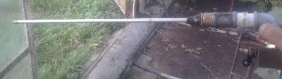

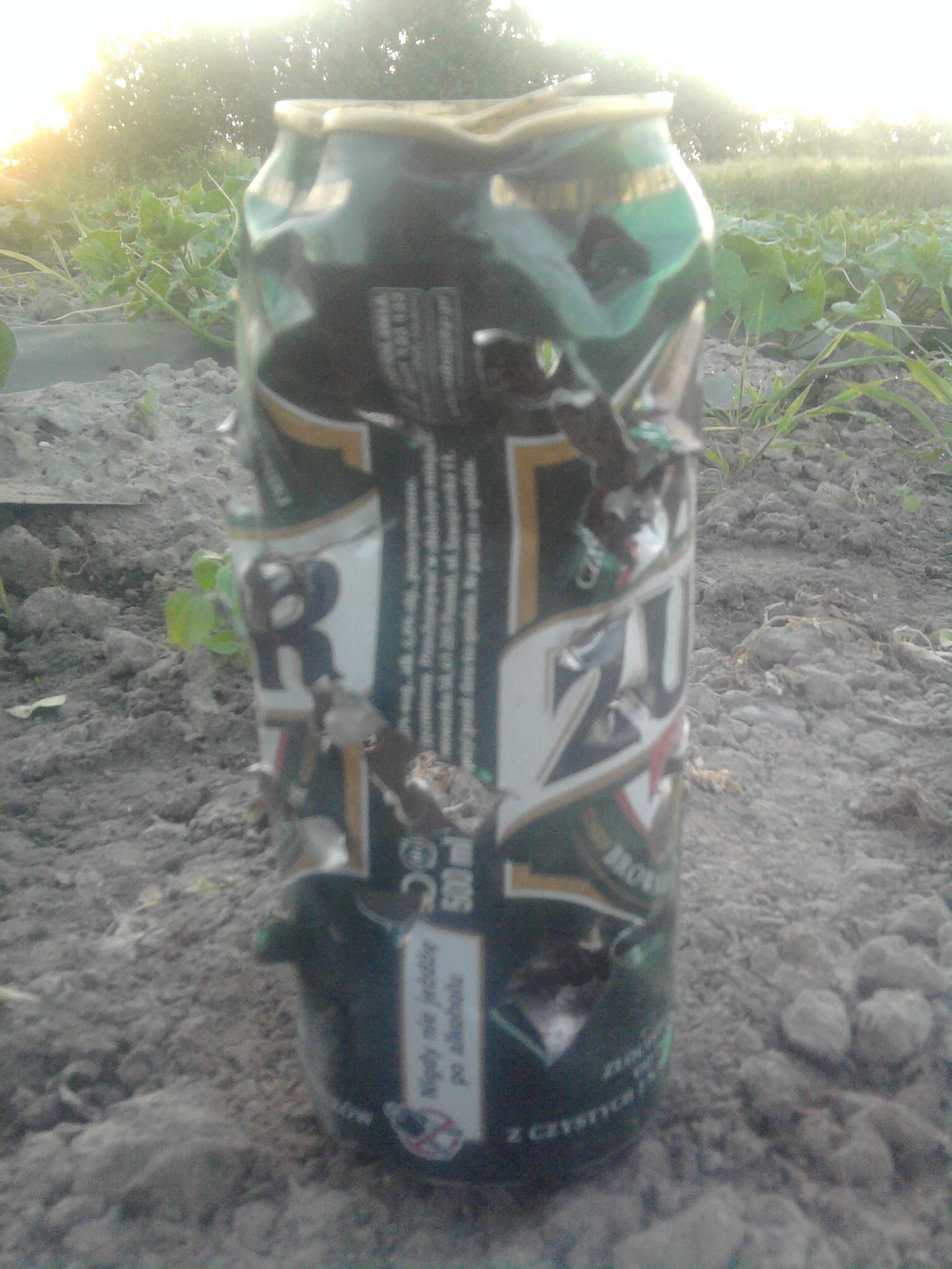

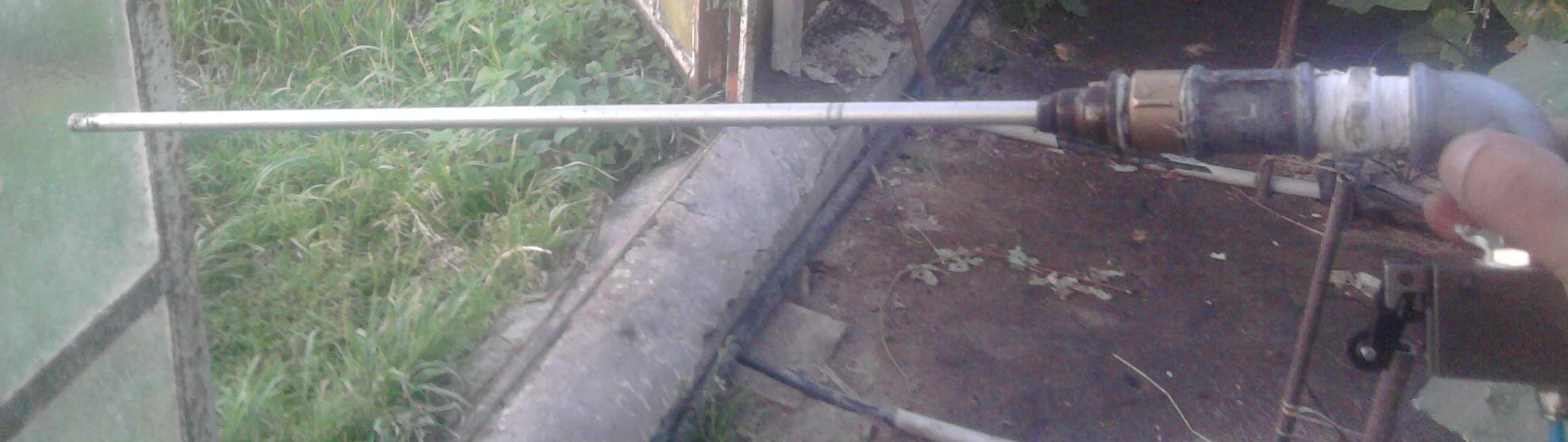

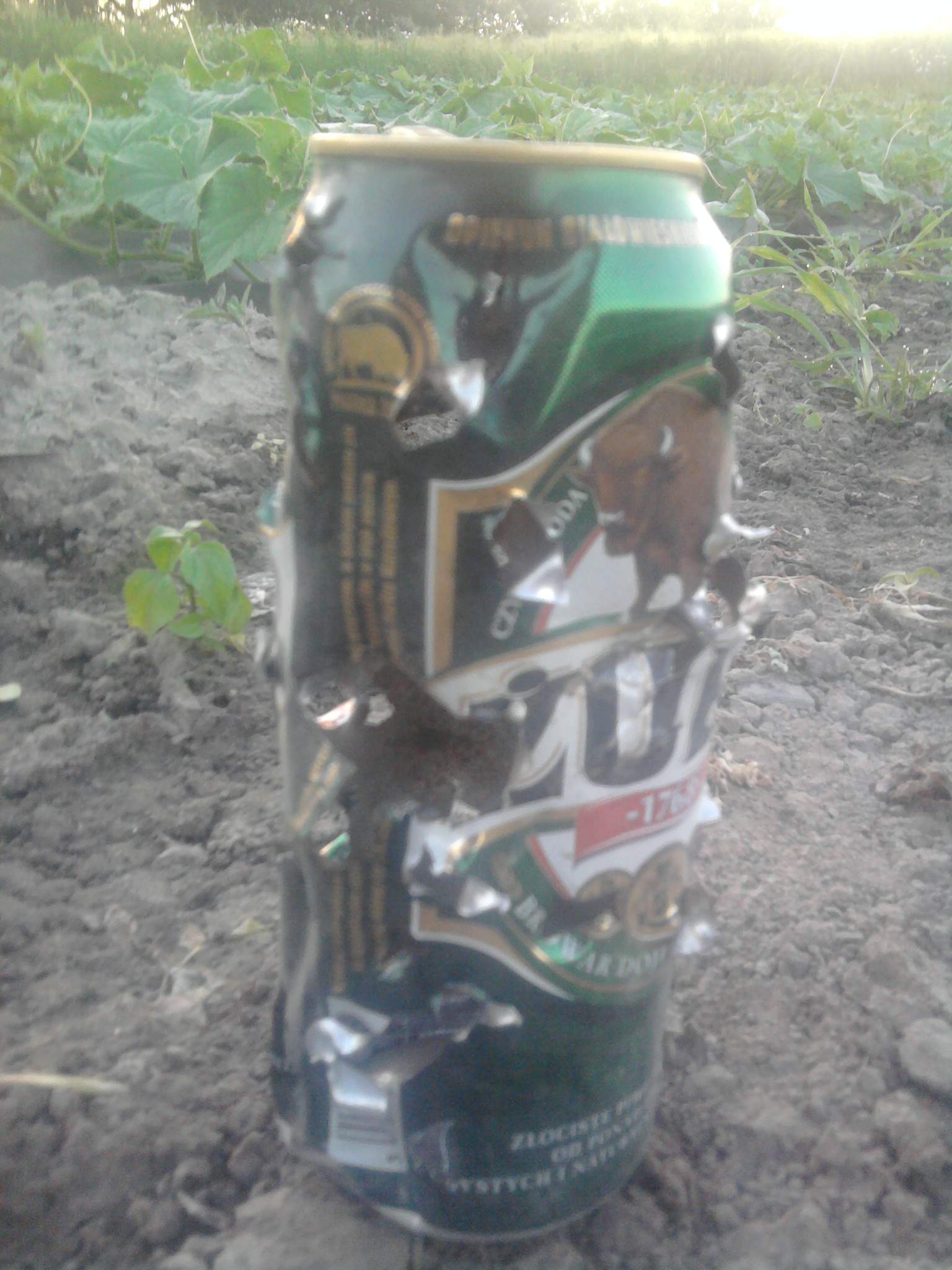

since hijacking threads has become a sort of tradition I decided to post a few pics taken today
