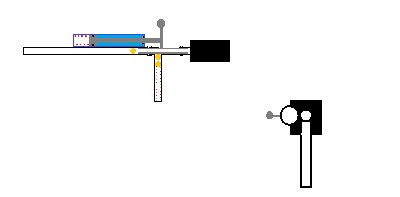

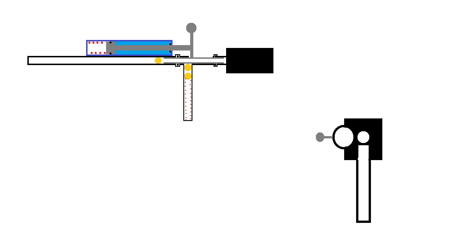

Got bored of pulling the bolt, so took it apart to make it semi
Already got all the critical part done, but before putting them all together, a diagram so if you see any inconvenience please write up
The cylinder it´s connected to the momentary chamber.

How does the air cylinder get pressurized?

It´s connected to the chamber, every time the chamber gets pressurized so does the cylinder.PaperNinja wrote:How does the air cylinder get pressurized?

Ah ok, similar to the way I'm gonna do it.
The only problem I can see is that every shot you have that bolt flying back and forth... wouldn't want that to hit anything.

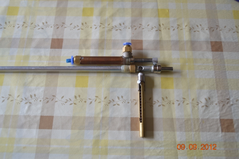

BTW, the new semi-auto system is almost done
All the connections between moving parts are o-ring sealed.
(Bolt in opening position)

wow impressive, want to see that working
