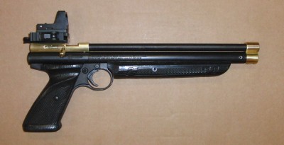

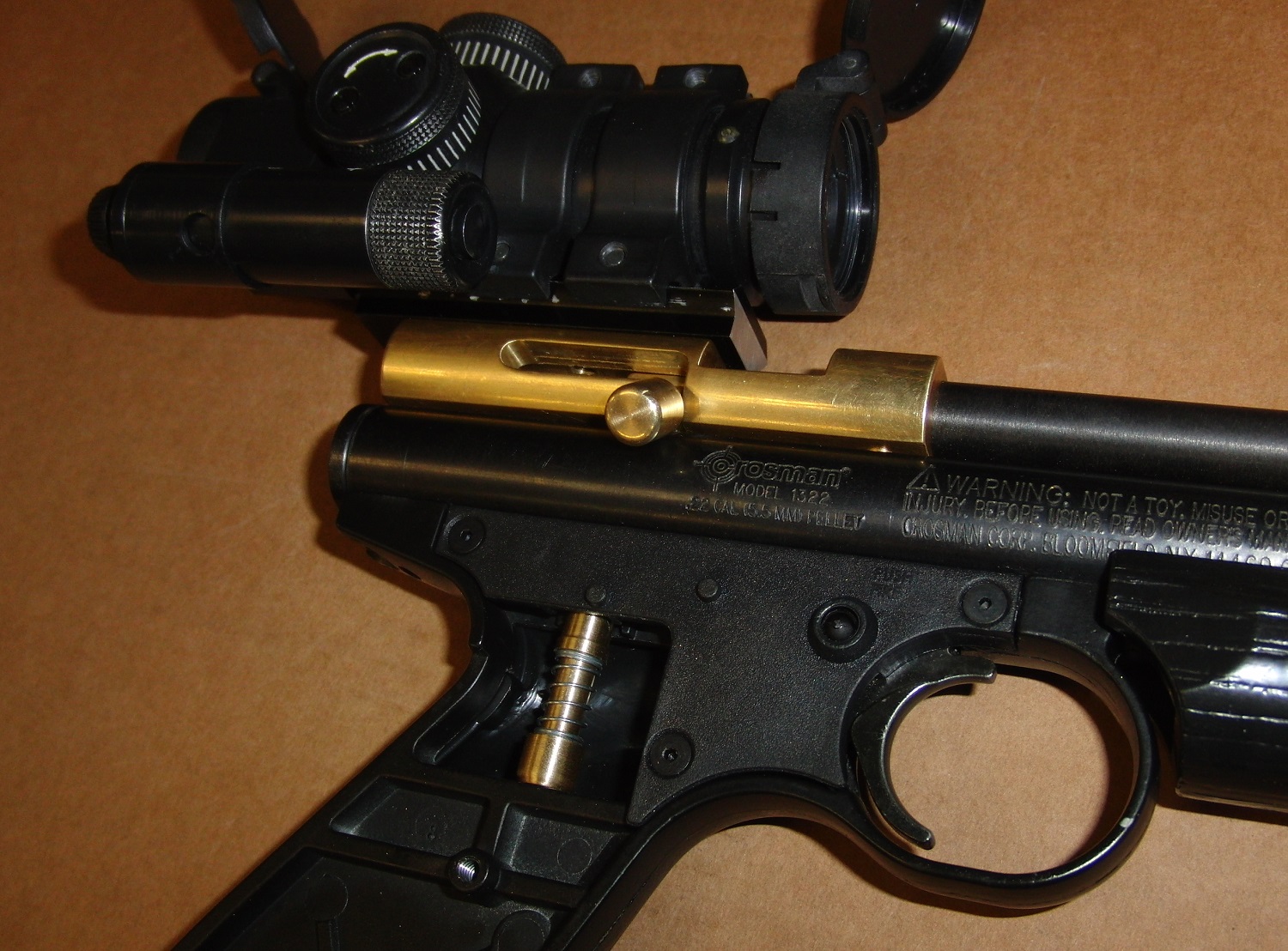

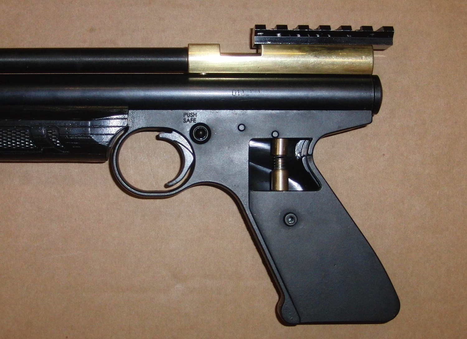

In the meantime, progress! Replaced the strong sear spring with a much weaker one, adequately supported with a brass spring guide, and also added a length of Picatinny rail:

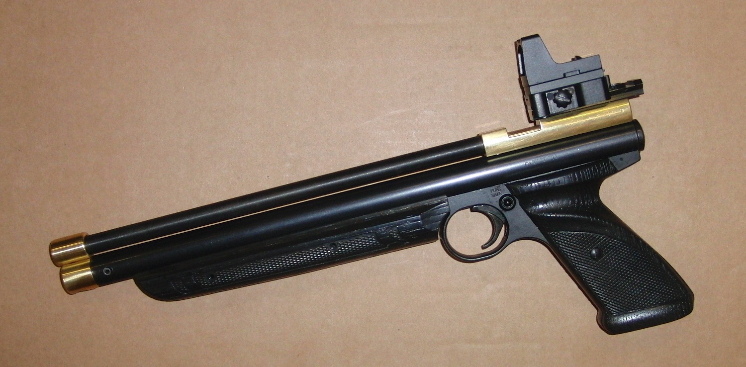

I also replaced the muzzle block with a larger diameter one to keep the barrel parallel to the pump tube, here it is with a QD red dot sight attached:
Now to see if I can get some chrony results, quite a grey day but fingers crossed.

Two bicycle LED light will solve that, place them on top of the sun shade.
On the picture it seems like the lower brass piece does not extrude into the upper piece... Would be more stable if it does IMO, like the one you've linked earlier.
wyz2285 wrote:Two bicycle LED light will solve that, place them on top of the sun shade.
That would be ideal but I only have fluorescent lighting at the moment. I have some LED strips somewhere, will give them a go tomorrow morning.
This was a quickie, I'll make a better one later but it seems to work quite well to be honest, the trigger is a lot more pleasant now.

Looking good :)
Is the radius cut into the bottom of the brass breech necessary for fitting the breech to the gun? Otherwise I might make one while I still have access to machining tools, it won't be long until my internship starts and I won't have any machining tools until I have my own house and money to buy some...
Labtecpower wrote:Looking good :)
Cheers :)
Not strictly necessary, but it does keep it aligned with the pump tube.

Ahh nice, a shallow cut with a mill will suffice I think :)
I'm planning on making the breech full length, so it covers the entire barrel.
Of course with a picatinny rail over the complete length.
Should keep the barrel from being flexed at every pump :roll:
Labtecpower wrote:Ahh nice, a shallow cut with a mill will suffice I think :)
Er... that's what it is, a shallow cut with a 3/8" ball end mill ;)
This should be interesting :)

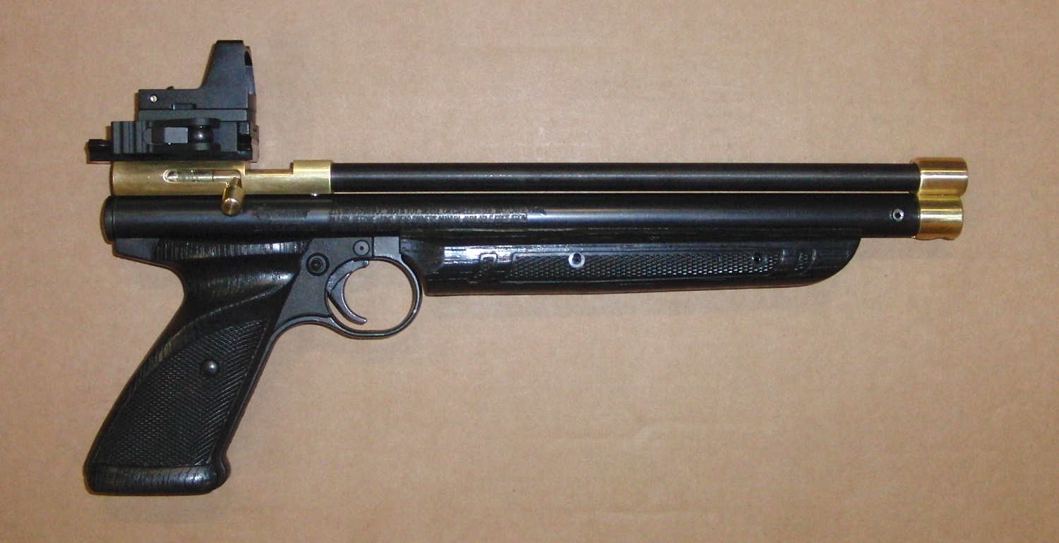

Still no chrony results but some progress, following criticism from Europe ( :D ) I redid the sear spring, smoother now... and remembered that I have a nice Russian пдк-23 red dot, no need for Chinese airsoft crap hehe

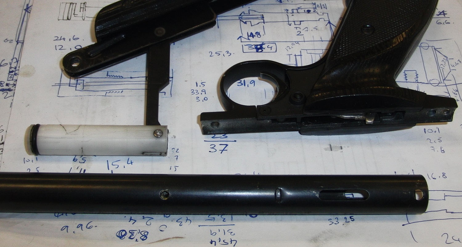

I took it apart to look at the valve again, it's still not fully reliable. Here's the pump tube underside, frame and flat top delirin pump head.
Finally some data, from one of these so not sure about the reliability but it's all I have working at the moment. Numbers are averages from 3 shots all with 14.3 grain nominal Crosman Hollowpoints:
10 pumps - 406 fps - 5.2 ft-lbs
15 pumps - 455 fps - 6.6 ft-lbs
20 pumps - 488 fps - 7.6 ft-lbs
The package it came in says it was doing 460 fps, presumably that was at ten pumps... I'm guessing that since the chamber volume is higher, it needs more pumps to reach the same pressure.
