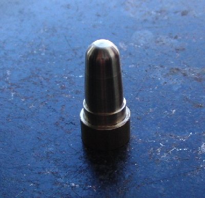

Crna machined this for me. Unfortunately the lovely finish is no longer as I had to shave 0.1mm off it to get it to fit better in the piston housing. I'm planning on restoring it back to its shiny finish if anyone has some tips (sandpaper finer than a couple hundred grit seems to be difficult to find at the nearest hardware stores).
[img]https://fbcdn_sphotos_a-a.akamaihd.net/hphotos-ak-snc6/s720x720/205414_3641142380506_1876181068_n.jpg[/img]
Can't wait to get this going in the piston hybrid. It weighs the same as the old piston but it's infinitely more scary because it's so dense
I approve of the machining but not the design

I think my original design (which had an area between the sealing face and first o-ring reduced in diameter to ~25mm) would have shaved off about 130g; which is quite significant.
I decided against it, without consulting the forum engineers, because I don't like the idea of having 'pockets' where there would be gases in front of and behind the sealing face.
Has anyone done flow simulations to see if there is a turbulence caused by a piston design like that?
I'm thinking I might need to buy another boat trailer roller to stick on the rear as part of the bumper system. I was momentarily tempted to go with an air spring when I felt how heavy and dense the piston was

good to see you got it, i think ill make one for my hybrid too.
go to a car sale shop like autobarn or supercheap auto they have fine sand paper for when your respray your car. 5-600 grit should get it back.
Had you made it lighter, it wouldn't even have crossed your mindMrCrowley wrote:I was momentarily tempted to go with an air spring when I felt how heavy and dense the piston was
If you were concerned about turbulence, you could easily have made a load bearing structure out of ali and filled the gaps with UHMWPE which is three times less dense.

That would make a cool looking piston. If weight becomes an issue, I can get someone to take a chunk out I guess but how do you fill the gaps with UHMWPE? The only way I can think of is by making a 'donut' and cutting it in half and then epoxying it back together.
... or make the piston in two threaded halves and sandwich the donut between themMrCrowley wrote:The only way I can think of is by making a 'donut' and cutting it in half and then epoxying it back together.

I've had some bad experience with dual O rings... there seems to be a great tendency for air to get trapped in the area between the 2 O rings so the piston gets stuck in the housing.
How did you avoid this in your design MrCrowley?

I don't think it'd get stuck with these o-rings, perhaps on floating though. Air being trapped between these o-rings would not cause any outward force or create greater friction. The forces would be balanced...
