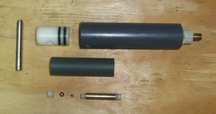

Here's the setup, I machined a PVC inlet for the fill rig in order to reduce dead (non cartridge) volume and make it easier to force the projectile to seal against the detent:

Hang on, I'm confused. maybe its because its 0127 in the morning, but bear with me. The whole idea with the pin inserts is for the fill rig correct, and the cartridge still has a threaded front for the o-ring holder? or does the cartridge have a pin holder method as well?

Yes, the steel pin is what holds the fill rig closed. The cartridge has an o-ring detent held in place with a threaded fitting that also serves as a "fill valve".Hang on, I'm confused. maybe its because its 0127 in the morning, but bear with me. The whole idea with the pin inserts is for the fill rig correct, and the cartridge still has a threaded front for the o-ring holder? or does the cartridge have a pin holder method as well?

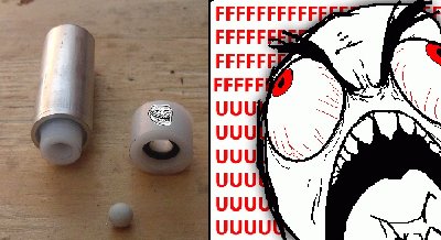

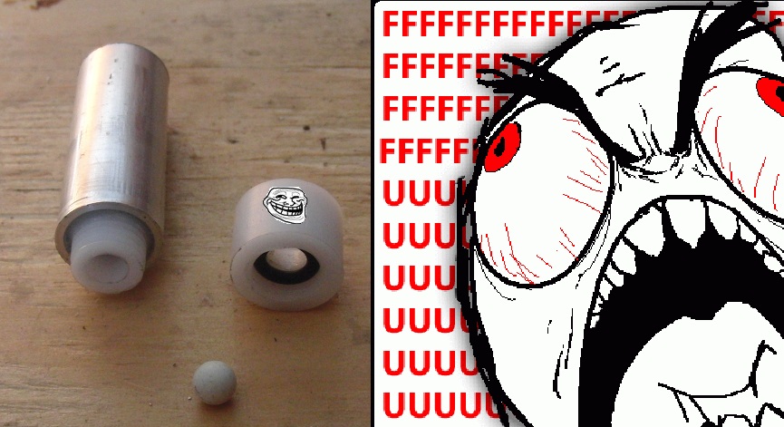

Scaled it up and been fiddling with it all morning, but no luck, the detent is impossible to adjust! It's either too weak and pops the projectile as soon as you depressurise the fill rig, or too strong and doesn't pop even with a 25x mix burning behind it.

hmm maybe you need a different oring ?? or the oring holder should be modified so orings wouldn't be supported from the sides and can expand when needed

I've used both 6mm ID and 5mm ID o-rings and tons of combinations of tightness and mixes, but didn't get a single successful shot - either I depressurise the fill rig and find the projectile has come out of the cartridge, or the ignitor goes click-click-click and nada, but the cartridge is warm and full of smoke.POLAND_SPUD wrote:hmm maybe you need a different oring ?? or the oring holder should be modified so orings wouldn't be supported from the sides and can expand when needed

well the previous one worked fine, right ? so I guess you can spend a few extra minutes to work this out rather than throw it awayI've used both 6mm ID and 5mm ID o-rings and tons of combinations of tightness and mixes, but didn't get a single successful shot - either I depressurise the fill rig and find the projectile has come out of the cartridge, or the ignitor goes click-click-click and nada, but the cartridge is warm and full of smoke.
ohh you didn't get what I meant... I meant that orings probably need to have room around them to expand outwardI've used both 6mm ID and 5mm ID o-rings

OncePOLAND_SPUD wrote:well the previous one worked fine, right?
I literally spent the whole morning fiddling with it, didn't get the right combination.so I guess you can spend a few extra minutes to work this out rather than throw it away
