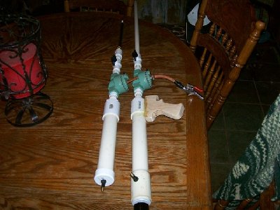

Here are the results thus far.

Chuck wrote:Here are the results thus far.
i don't see anything :(

I wanted to make the air line go to the pistol grip and a fix the air blower as a trigger.

ahh now i see them. hmm pretty cool but when i get round to making it my styre scout/elite tactical style gun will be cooler.

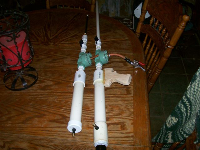

I got my 177 cal. rifle up and shooting tonight but it's not shoting hard . I figure it around the 300 range FPS . I am wondering what went wrong I can't get it to shoot any harder. Some ideas please.

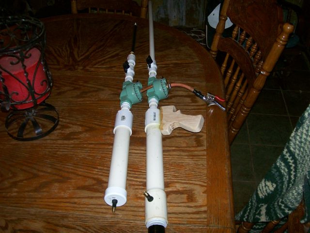

Here is a few pictures I hope.

Chuck wrote:Here is a few pictures I hope.
nope can't see them and as for your .177 not shooting hard what pressure are you using it at? because pressure makes a huge difference, if you got another 50psi it would probably shoot alot harder. although the sprinkler valves are quite limiting because they are not rated very high (usually under 150psi), in my 6mm pellet gun i'm going to use a 1/2" qev at 250psi which gives a high flow, fast opening time, and a ton of power. with a .43g bb it should be doing 900fps with a muzzle energy of 10 foot pounds :twisted: which is near the power of most commercial air rifles.
