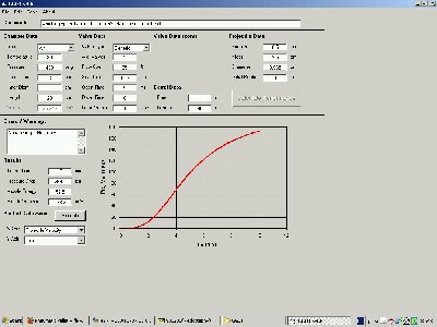

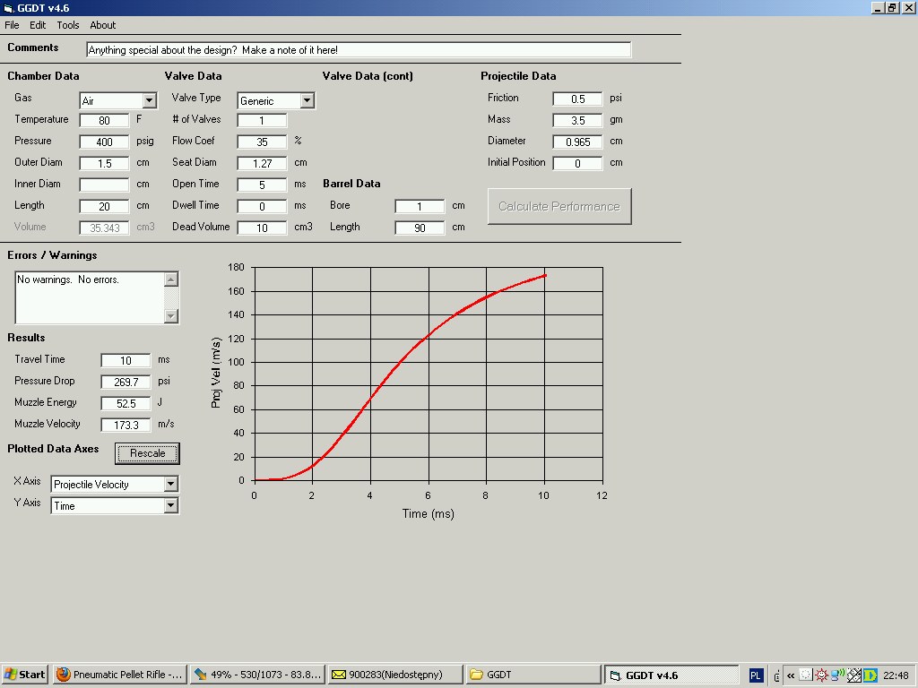

with 1 cm barrel and 9.65mm ammo (ball bearings... but you could use lead shot for better energy retention)
you could get this
(if you are totally non-metric that's roughly 38ft*lbs and 565 ft/s.... notice that the chamber is quite small so you could get more easily)
you could get this
