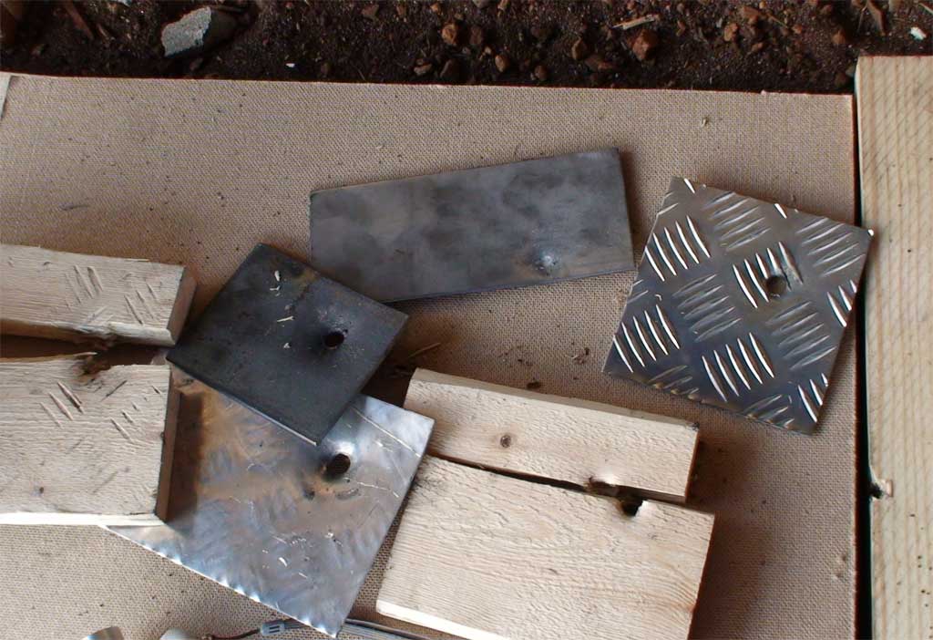

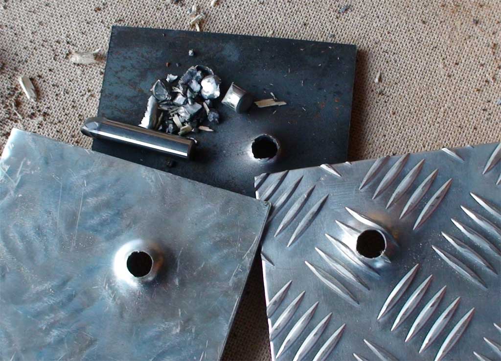

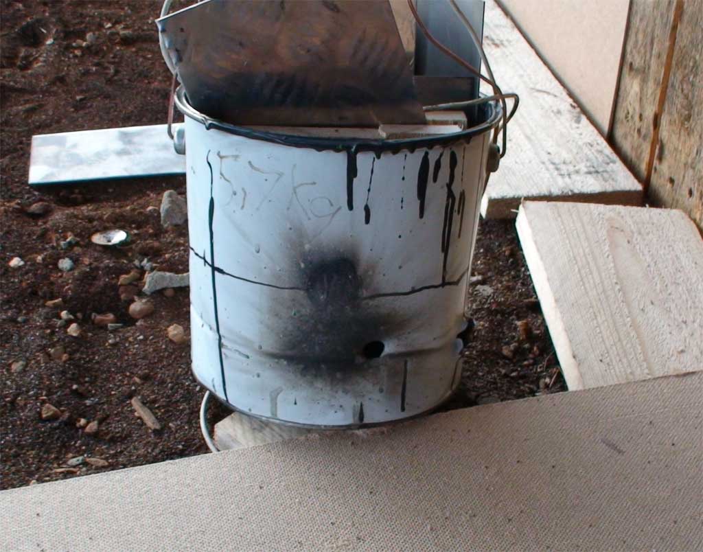

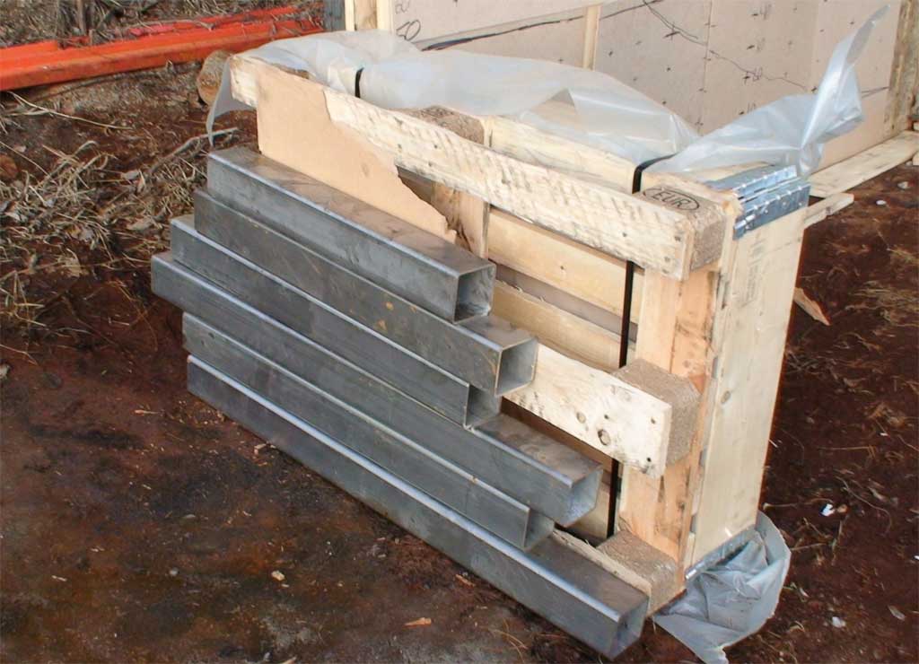

I made another more successful attempt to measure the velocity today.
I added several layers of sheet metal to the pendulum to make it "bullet proof".
The projectile penetrated two pieces of 20mm wood, two pieces 3mm aluminium, and finally 5mm of steel before it disintegrated.
In this test i charged the capacitors to their surge rating 1350v, for a total energy of 36,5Kj.
High Speed video of the test, its captured at 100FPS but the resolution is lower.
http://www.vimeo.com/769985
The failed test earlier.
http://www.vimeo.com/770135
Damage by a 90g 12mm Solid Carbide projectile.

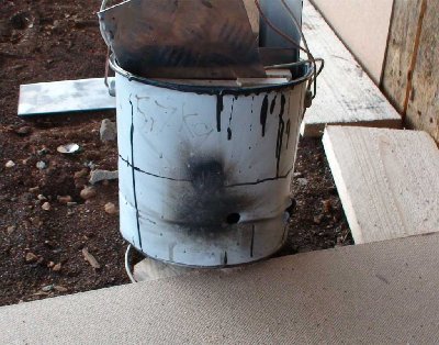

The pendulum.
The pendulum.

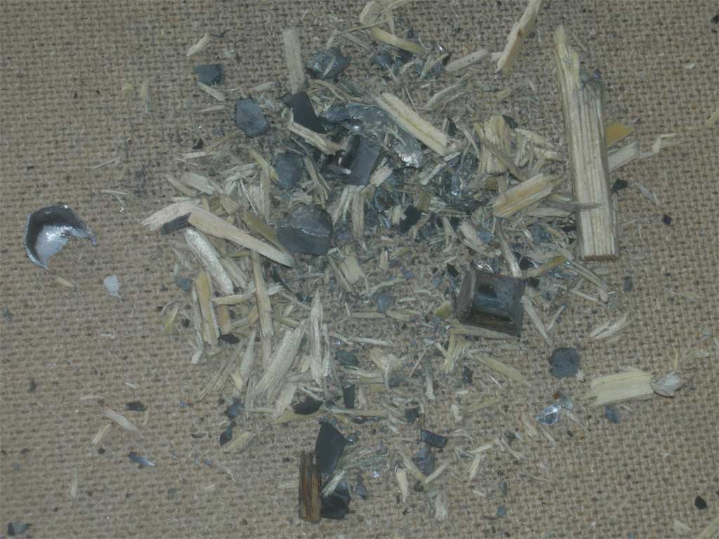

The projectile turned into shrapnel after impact.

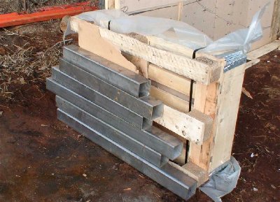

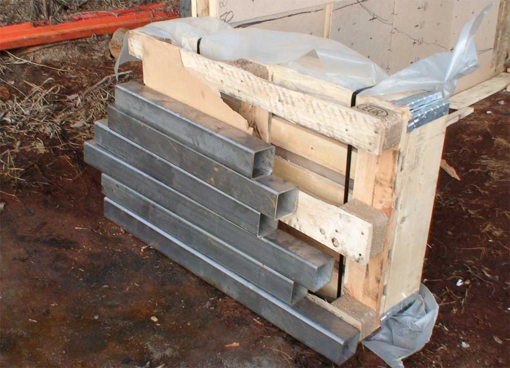

Bullet Trap
Bullet Trap

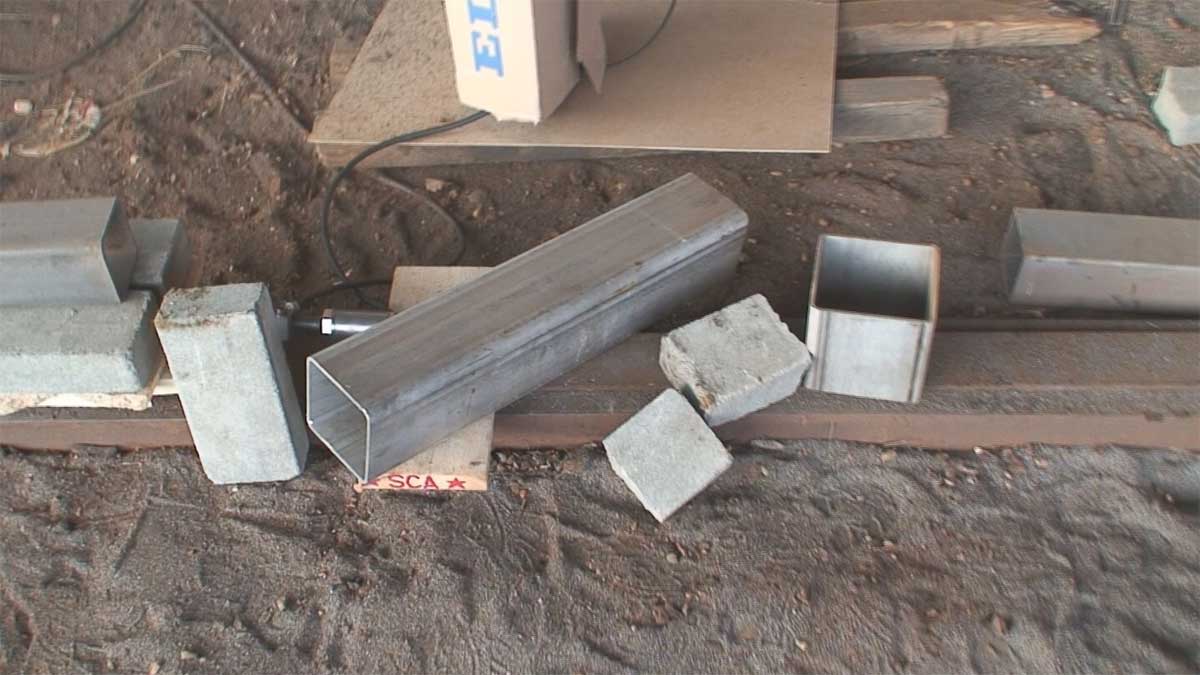

anybody else noticing the completely massive recoil? It appears to be launching bricks and those square metal bars backwards...

chartreusesnot wrote:anybody else noticing the completely massive recoil? It appears to be launching bricks and those square metal bars backwards...
chartreusesnot
Posts: 109
Joined: Tue Jun 05, 2007 11:52 pm
Dude... whats happening in that picture? did the recoil split that brick...?

I love the way the chequer plate pattern is imprinted on the wood in this photo - amazing stuff, keep it up :D

Well, that sort of puts things into perspective. DYI has been well and truly beaten on the penetration front.
From that video, and guessing from the markings on your back board, it looks like you're doing about 260-270 m/s (860-880 fps), which is around 3200 Joules (2400 ft-lbs) of kinetic energy. That's a phenomenal amount from a 12mm barrel of that length, and it would seem you're achieving an average pressure of around 10000 psi - possibly more, I'm not sure how long your barrel is, so I guessed around 40 cm from the picture in the opening post - which is a full order of magnitude above anything anyone else has yet achieved (at least, that I can think of).
So, it's not actually supersonic, only about 80% of the way there, but no doubt if you used a projectile of somewhere under 50 grams, you could manage to break the sound barrier.
It's also a respectable 11% efficiency. Ooh, I can see more of these being made.
You sir, have what is no doubt one of the most kick-ass spudguns ever.
