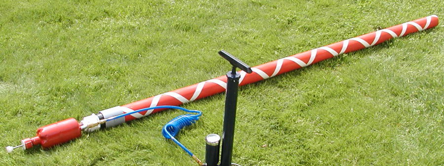

A longer barrel will quiet it down considerably along with lower pressure. In a test, I tried an overly large barrel on the marshmallow launcher and launched a tennis ball at 110 PSI. The clank of the valve is noisier than the actual shot.
The tank, not shown in the video is the 54 cubic inch marshmallow cannon.
Marshmallow cannon with the 7 foot tennis ball barrel.
