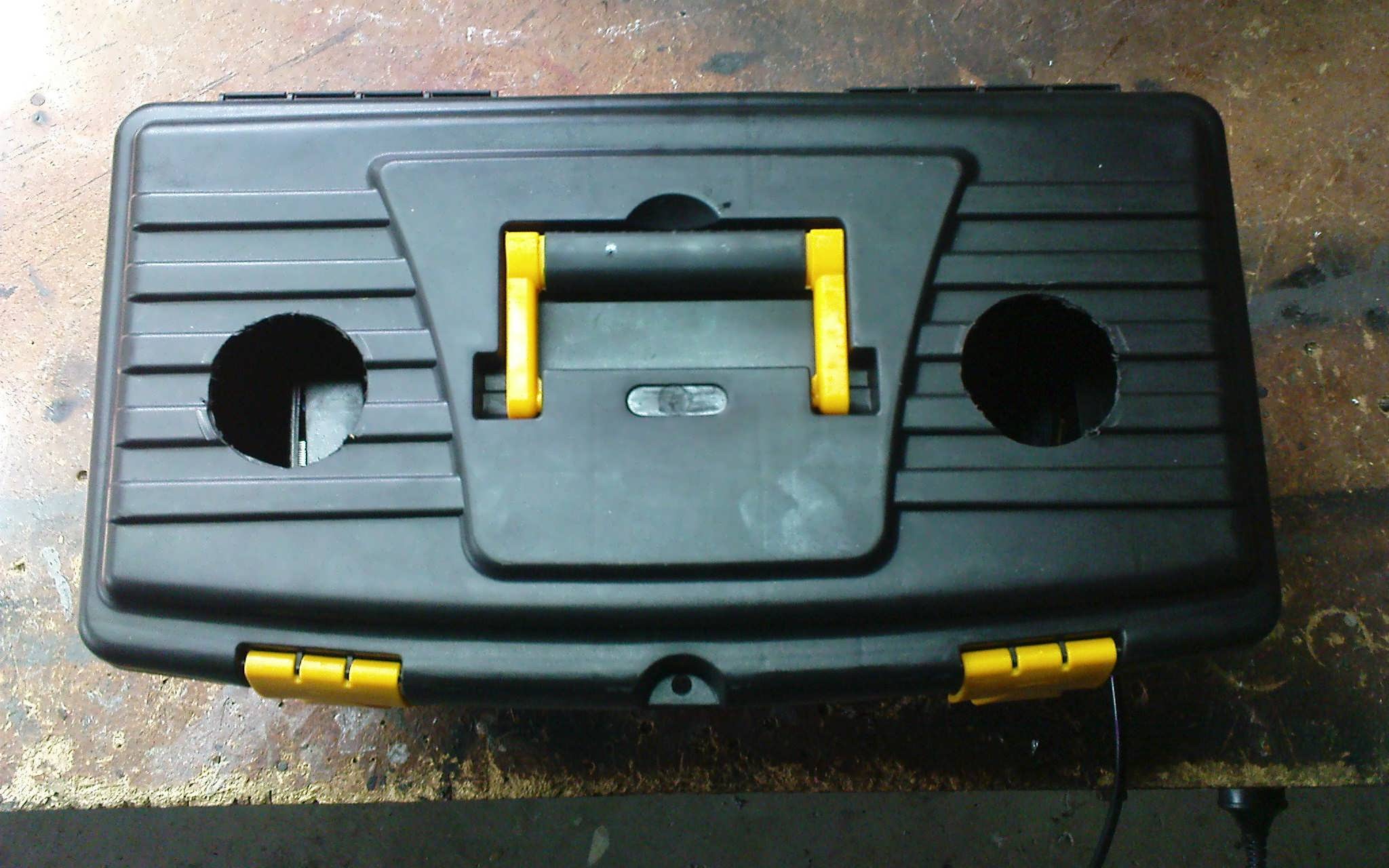

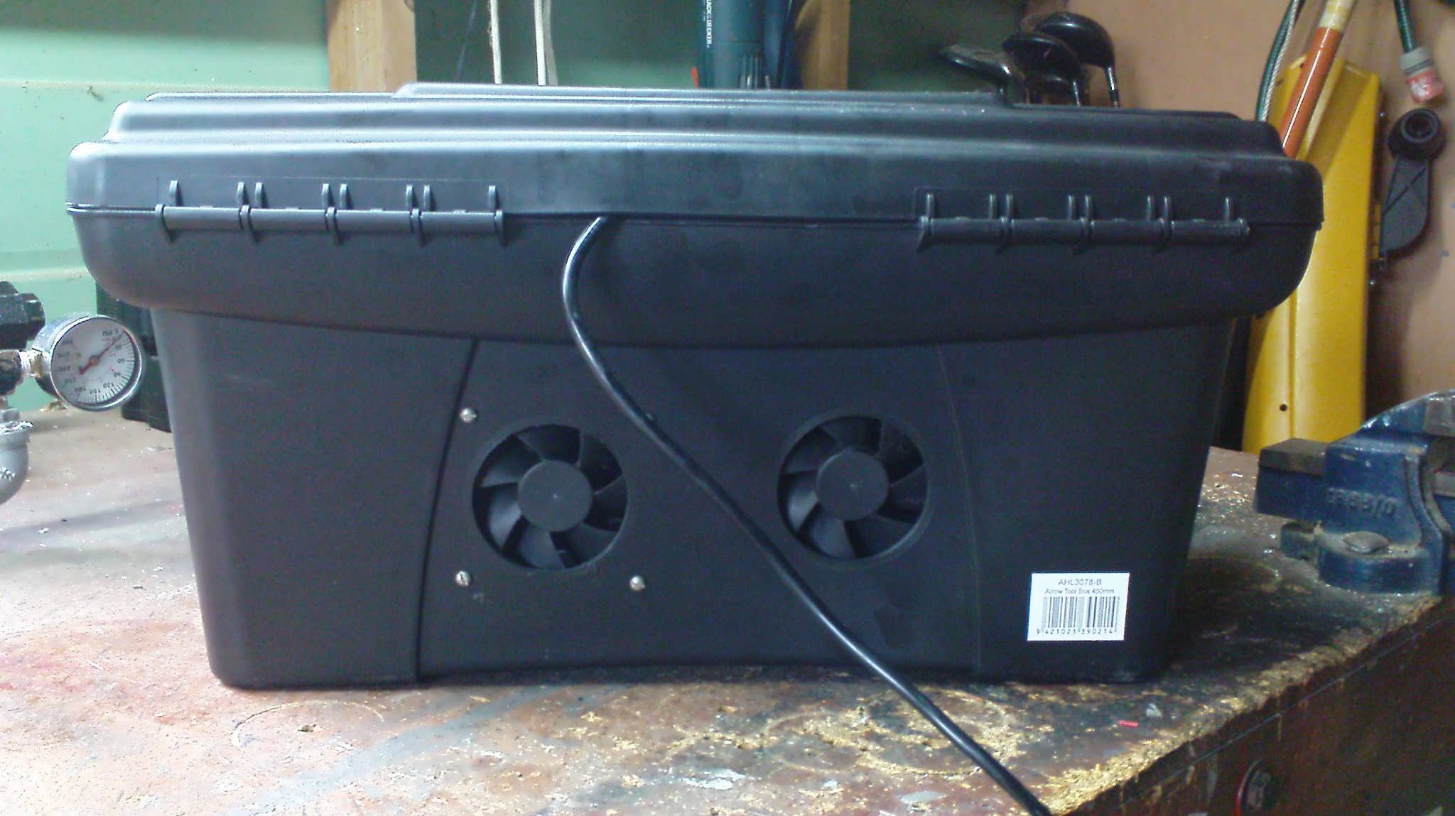

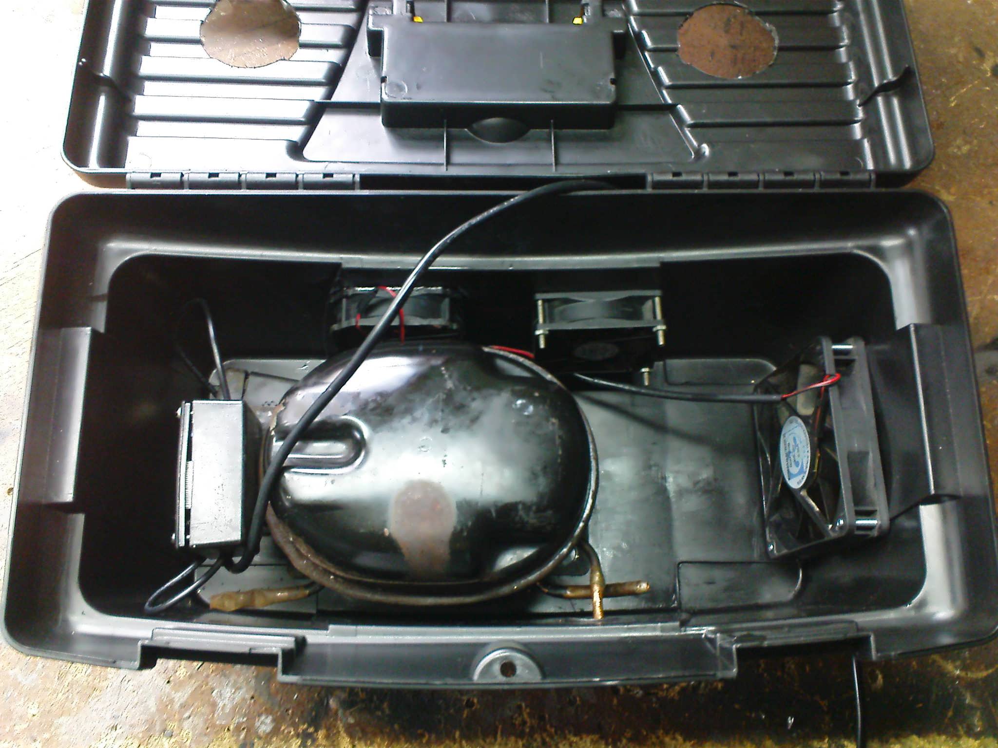

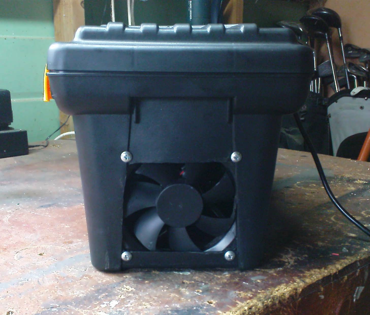

This is my cool toolbox...literally
Toolbox was about $12, the 3 fans cost me nothing (2x80mm, 1x120mm) and all the electronic components I had around the garage. All 3 fans are sucking from the outside and blowing in to the toolbox.
I had a theory that if I had 3 fans that blow in to the toolbox, they hit the compressor and then rise out the top 2 vents. Also hot air rises so I thought it would be better having vents in the top rather having a fan suck it out the side.
If you guys have any other suggestions for fan placement or direction, let me know. My setup was only a guess at cooling efficiency.

lol it's cool... does it cool ?

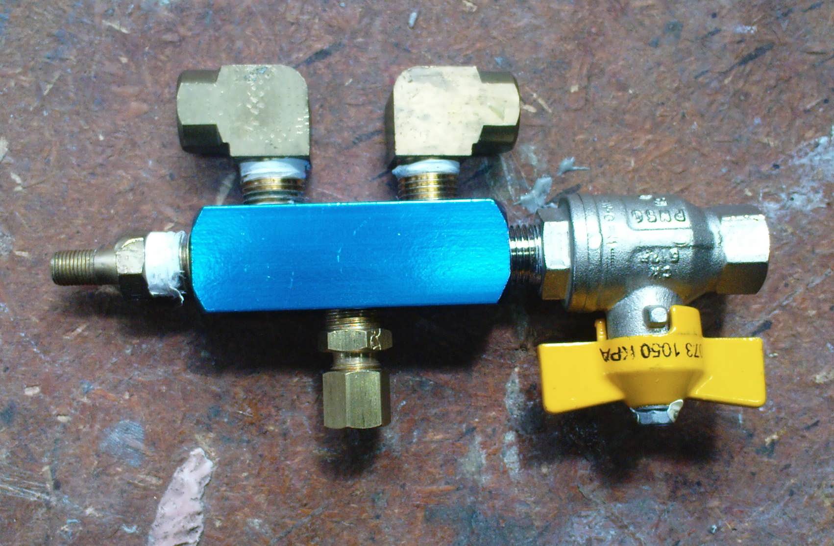

Got quoted at various hydraulic stores for prices around $50-60NZD for a meter of hose and threaded fittings on each end but I have found an auction for 3 hydraulic hoses, all with fittings on the end, for $40NZD so I'll do that. I need two hoses anyway, one for attaching to a gun and the other a tank to store pressure.
Just go to a local hydraulic store and ask them for a quote, I can give you the names of some if you need them as I see you're also in Auckland.

a) The prices above for hydraulic hoses are mostly for the fittings and attaching it to the hose, the hose isn't very expensive.
b) the nylon hose that is rated for 600PSI and costs $3 a meter might not be the right diameter or material if I tried to get it crimped and fittings attached at a hydraulic store.
I simply can't find push-to-connect fittings and hose rated for above 300PSI.

Well I figured it would be better to go with the hydraulic hose for two reasons:Found some 600PSI rated hose for $3 a metre haha

As to the fans, the best thing would be to have the fans blowing out as rp181 suggested, drawing air though the top. While, you're at it, why not mount another two small fans in the top vents
with the opposite flow to the side mounted fans. Alternatively, mount the two smaller fans opposite the larger one and have one side blowing in while the other blows out, with the top vents sealed up. Some mesh over all the vent holes would complete the look
oh, and a small slot for the power chord

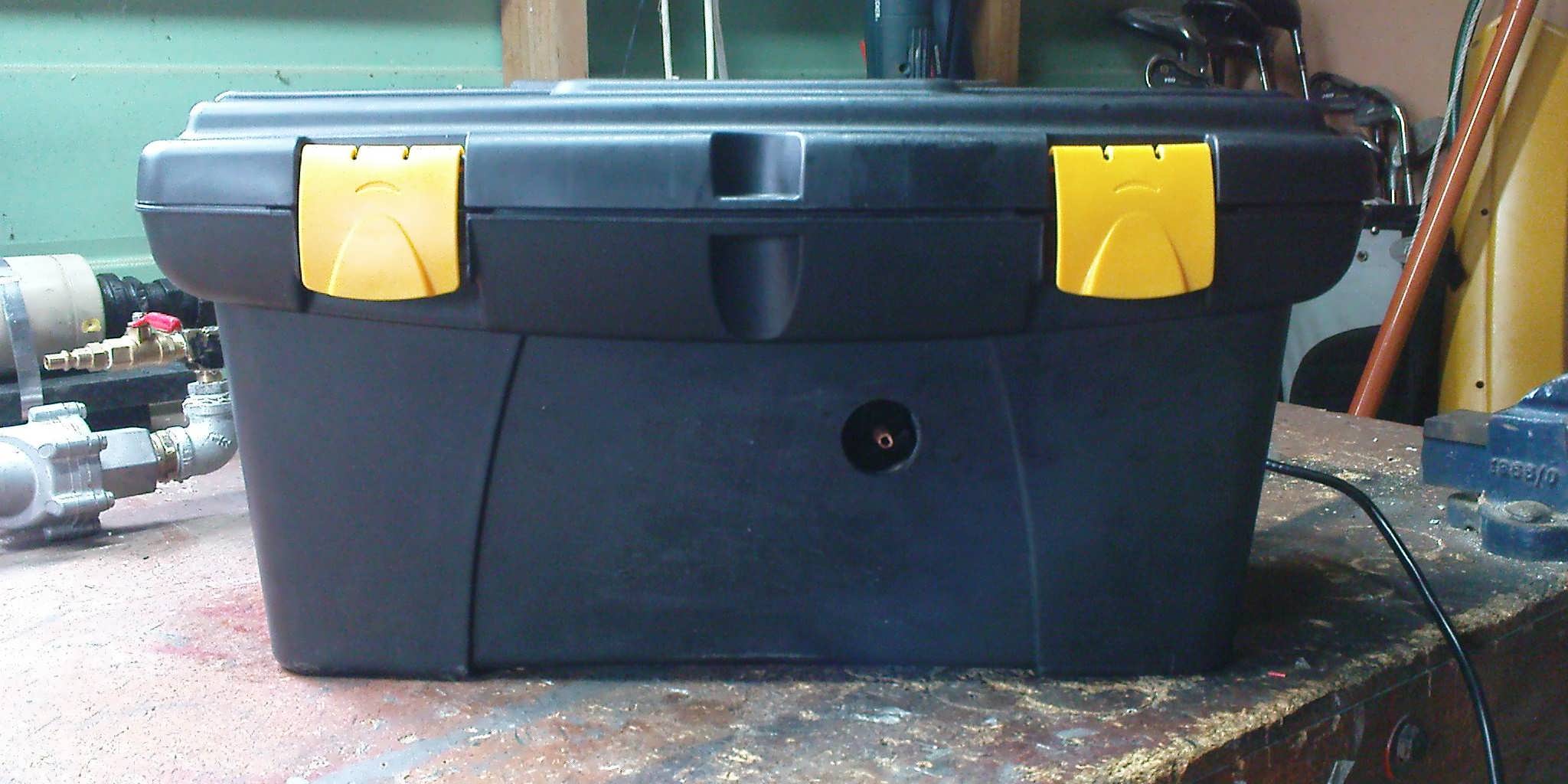

I've been thinking about this setup... and while it's really neat and looks great, probably it would be a better idea to force the air to flow around the compressor by having one, two or three fans on one end blowing air out and a vent on the opposite side of the box...
well that would simplify stuff a lot because you could run the cord through the vent too
though if you find metal ones buy them... even if they are not rated to 30 or more bar they are quite sturdy... you can always sleeve them in a metal fitting if you're afraid that they will explode (or epoxy them inside a metal fitting)

Yeah it takes time to find them... I found only one shop that sells them in polandI simply can't find push-to-connect fittings and hose rated for above 300PSI

I'll run it for an hour this afternoon, if it is hotter than my liking I'll change the fans. If it seems to be fine, I wont change the fans unless I see a noticable difference once it starts compressing air when I get some hoses, fittings and a gauge.

Ok so i'm not happy after it running for an hour in my cool toolbox which, ironically, is not cool.
Tomorrow i'll swap the fans around. Tell me, would it be better to have the two 80mm fans sucking out air from the side (wher they are now) or sucking out air from the top (where the vents are now)?
It'd be cool if I could just chuck the compressor inside a fridge
edit: Oh and would it be better to drill a nice big hole in the side of the box opposite the 120mm fan?

As it is I think you have too much turbulence. I would seal up the holes in the top and move the two smaller fans opposite the larger one, also sealing up the holes in the side. Then wire them to have the small fans blowing in and the large fan pulling out, to give you a straight-through draught.

yeah, for a start I would cut a hole opposite the large fan and plug all the other holes... then test it (with just the large fan)I would seal up the holes in the top and move the two smaller fans opposite the larger one, also sealing up the holes in the side
and maybe later try it with all three fans on one side
