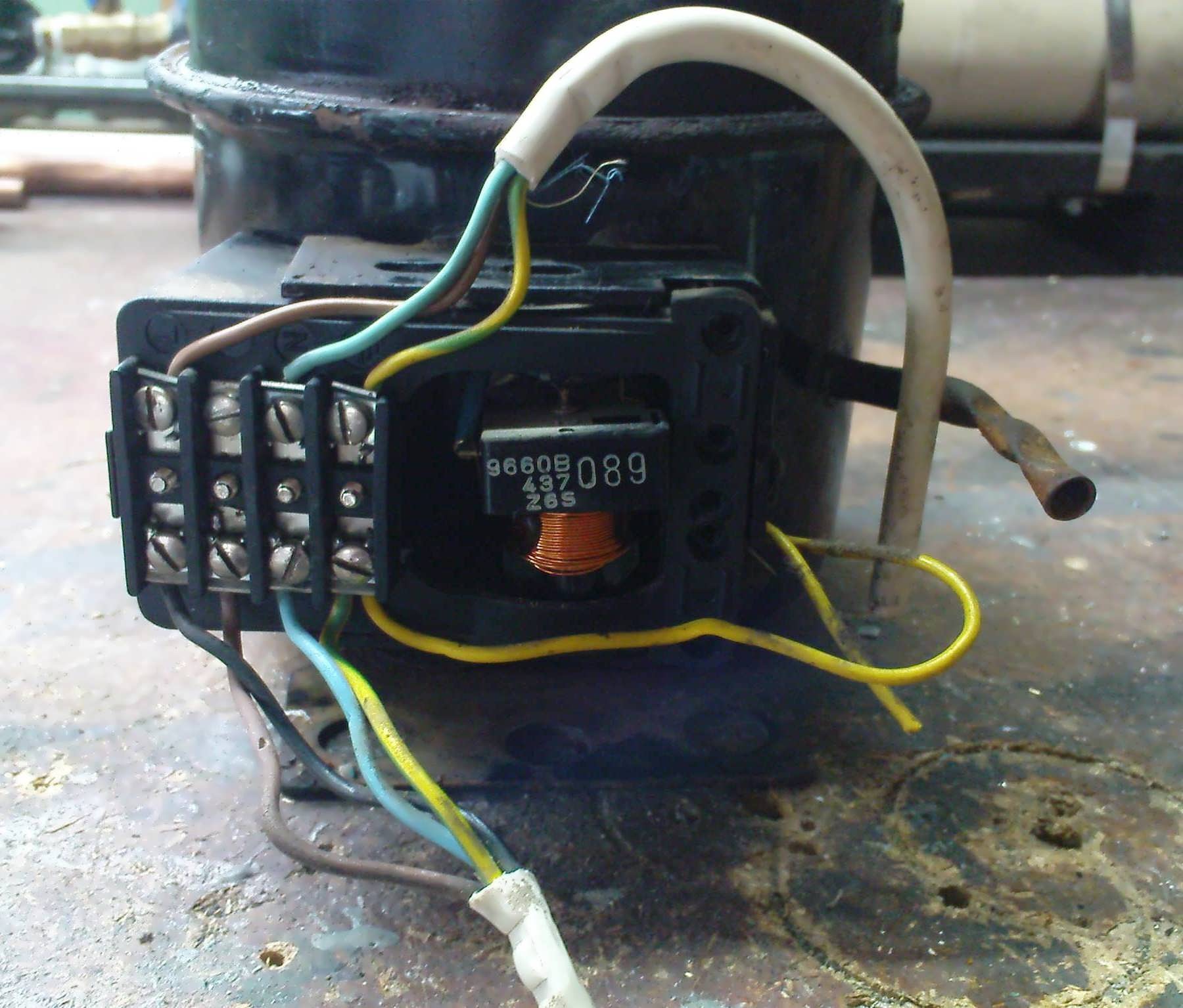

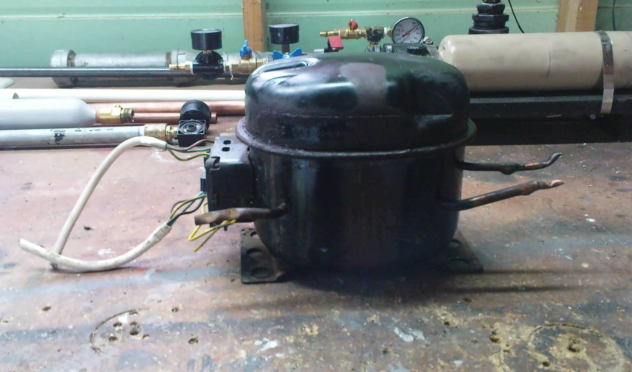

Ok I got meself a fridge compressor but I would rather not f*** it up through my lack of knowledge... Assuming it actually works anyway.
Ok well the pictures below speak for themselves but I'm wondering;
A) Do I have to get the compressor running before I know which of the copper pipes is output and which is input?
B) How do I wire this thingy (note: it has two cables??)? I believe I was reading the book "Das Boot" while we were studying electricity in physics last year :roll:
C) Quite a bit of oil was drained out, maybe a few hundred mls, will I need to replace this with more oil and if so what oil will work?
D) What are the best ways of attaching the copper pipes to a hose or something with threads? Will brass compression fittings work (note, if this thing will go to 500PSI, I am taking it to 500PSI)?

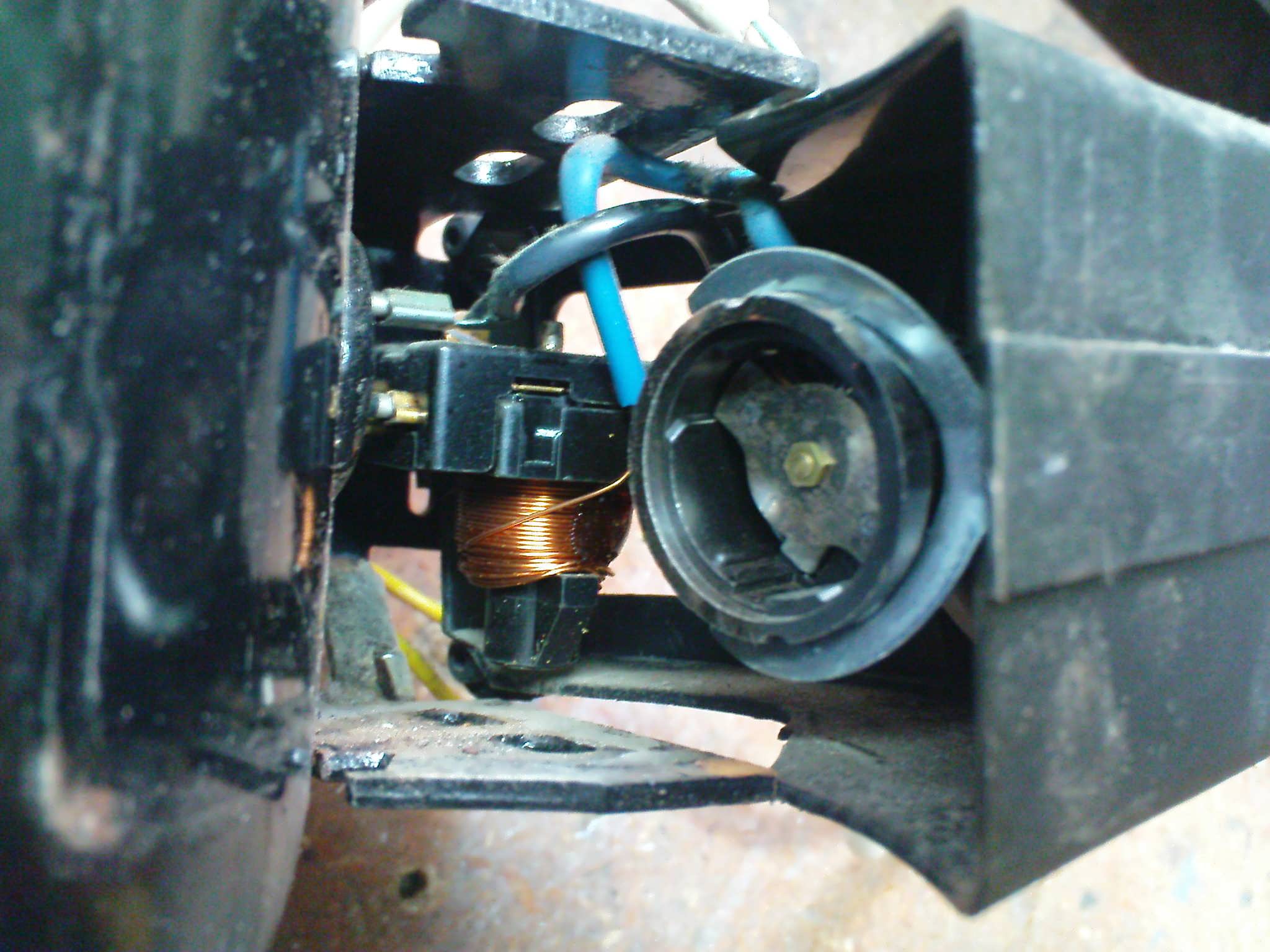

Witch wires go into the starting capacitor? I am betting you will find that the motor was the distribution block for all the wiring in the fridge. witch means some of those may go to light, fan ect. The only wires that should matter is the ones going to the starter. On mine I striped everything but those 2 wires and it runes great. Keep in mind with out knowing were each one leads to we can't know for sure.
On the note of the compression fittings I connect mine that way and have had to to over 600PSI no problems.
I would get it wired be fore you try to plumb it up. But the tubes coming out should have a larger one witch is the suction.

A once you get it running you'll know which one is output and which one is input
B Everything seems to be in place... just replace the cables with longer ones and add an ON/OFF switch
one of the cables led to the thermostat... do you know which one..? you need to know that... you can attach the ON/OFF switch there
ohh btw sometimes there are schematics somewhere on the compressors..
I assume that the lower cable led to the mains...
the upper cable is the one that led to the thermostat and you can attach an ON/OFF switch there
buy two lengths of cable (one with a socket and 3 wires in it.... the other one is for ON/OFF switch so it might have just two wires)
YELLOW-GREEN wire is ground
BLUE & BROWN are neutral and positive (or whatever you call them... anyway you already have wires attached so you know where to attach the new ones)
do you need more info?
D you can build your own compression fitting... it's in one of my posts there -> http://jumbodesign.nl/phpBB3/viewtopic. ... a9&start=0
C you might but first try to get it to work... even engine oil will work but one for compressors would be better

The bottom wires were wired to nothing except one of the small yellow ones was wired to the base of the compressor.
The top 3 wires have two blues wires going back to the starter and whatever (the thermostat? Round black thingy in the first picture) haha. So i'm guessing I wire the top 3 wires to the mains.
If that is right, can I put my own switch in coming off those top 3 wires, wire it to mains and remove the wires from the bottom part and just leave it like that?

upss... I didn't notice there are 4 cables at the bottom... anyway I am still not sure which cable you should connect to the mains...
it's not a that difficult to work it out... you just have to analyse the circuit and find two wires that close the circuit once you join them (they were attached to the thermostat)
(just try to draw a diagram once that's done you should be able to work it out yourself... if not post it here)
once the two are found and you put an ON/OFF switch there it should work
