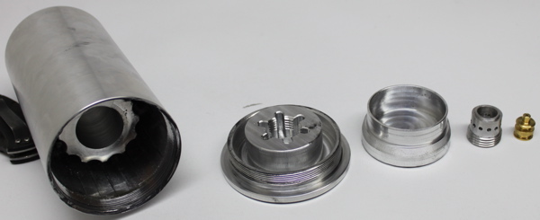

jackssmirkingrevenge wrote: So there's no hammer valve, just a direct lever to the pilot? Surely it would be very simple to have a double action trigger mechanism that would give a predictable release point and consistent pressure every time?
Certainly possible and a path we considered, I even built some double action hammers to flesh out ideas. I think I sent you a video, feel free to post if you dig it up. At 500psi the poppet requires a 24lbs to actuate. The hammers needed to push that were getting pretty big/heavy.. Also i think it would need a "dead blow" type design built in to hold the valve open for full vent.
One of the original ideas used an unbalanced spool valve which worked great and required little force to actuate. We opted not to, because it required more machining, was more complex (more prone to problems) and easier to set off if dropped or bumped. This was designed for a small hammer to actuate. I think I sent you the photos of the first valve prototype too. Feel free to post.

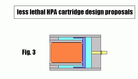

You're right about the hammer valve, we were throwing so many ideas around at the time I forgot what eventually got chosen :roll:
jagerbond wrote:I think I sent you the photos of the first valve prototype too. Feel free to post.
I was looking through the e-mails and there's tons of pictures, not sure what you want to keep private or not. I did find one of the first proposals which isn't too far from what you eventually settled for :D
jagerbond
Posts: 286
Location: Hawaii
This is the current version, below is the version with the unbalanced spool valve.
