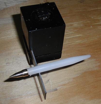

Where is the actual balancing point?
Measured from nosecone tip.
Maybe due to the shape of the tail end, there will not be enough drag for stabilization. Adding fins would help.

If you still want to go finless, you'll probably need to change the tail, since you've already pushed the density of the nose as high as is reasonable, though you could shorten the nose a bit, the cylindrical section could have been removed.
How are you attaching the two? Does it have something like a tang? That could be screwing with the balance point a little, replacing such a thing with epoxy might help.
Your Delrin tail (I think) was poorly chosen. I'd go for a UHMWPE, lower friction (.25 vs. .12) and only two-thirds of the density. McMaster sells UHMWPE rods, but I think all their stock is on a roll, so it'll be sightly curved. Heat-treatment while chucked into lathe to straighten it?

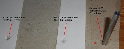

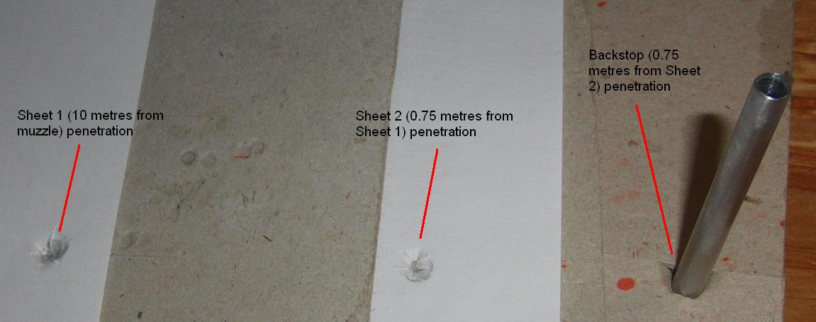

Could it be that 10 meters doesn't allow enough distance / time for the projectile to stabilize in flight?jackssmirkingrevenge wrote:The inset shows the impact hole in a sheet of cardboard 10 metres away from the muzzle, I shot this out a 300 psi 6mm piston launcher. It was clearly travelling sideways when it hit, this is not looking like it will work.
Friction fit but the "tang" is very short anyway.
Sadly I have been unable to find a local source for UHMW and getting it in reasonable quantities from elsewhere is prohibitive, though I might be on the verge of getting a little help with thatYour Delrin tail (I think) was poorly chosen. I'd go for a UHMWPE

It was clearly travelling sideways, if it's fishtailing so much I doubt it would have recovered after a longer distance.Could it be that 10 meters doesn't allow enough distance / time for the projectile to stabilize in flight?
They work on the same principle, what I'm trying to do is make it more aerodynamic, so the tail shape is of more significance than a pointy or round nose. Clearly a weighted tube works, but the abrupt shoulder at the end isn't good for drag - on the other hand, reducing this drag might remove the stabilisiation benefit as dewey alluded to earlier.Make a sureshot round and add a pointy nose?

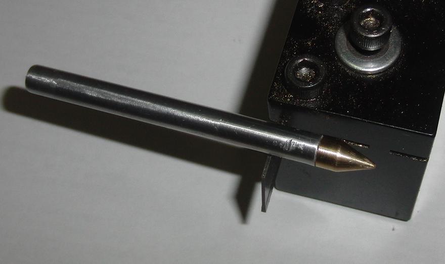

edit: found it, the CG is well forward of the CP, but clearly not enough.
Update: made a quick brass nosecone mounted in a length of aluminium tube and the result is dramatically different, this time the projectile was clearly traveling dead straight.
Next step is to make a very light (hollowed out balsa wood to change the shape without changing the CG too much) conical tail section and see if I can get the same results.

Strange enough this thing flew pretty straight;
The holes it made in the plywood were perfectly round.

Had the same result with a can of energydrink.
If it travels fast enough it will not have the time to tumble over that kind of a distance.
This does not mean the projectile is stabilised during flight.
It does add to the discussion though.
Speed itself is an important factor in accuracy.

Next time post a picture of both at the same time.
That way we can observe the difference in the CG points.
If you take the picture overhead such that it appears like a drawing, I can measure the CG point if I know the lengths of each.
The results of the hollow tube (assuming it is the same length as the Delrin one), appears that more drag is induced therefore stabilization.
From the pictures, the CG points look to be very similar.

What are the dimensions on that aluminium rod? How does the linear mass density compare to that of UHMWPE or Delrin? I think you'd want to continue trying to use plastics; I'm pretty sure aluminium rods (hollow or not) will get pricey...
