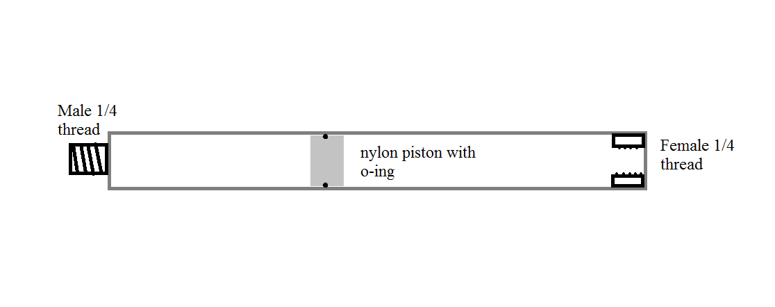

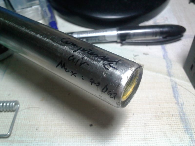

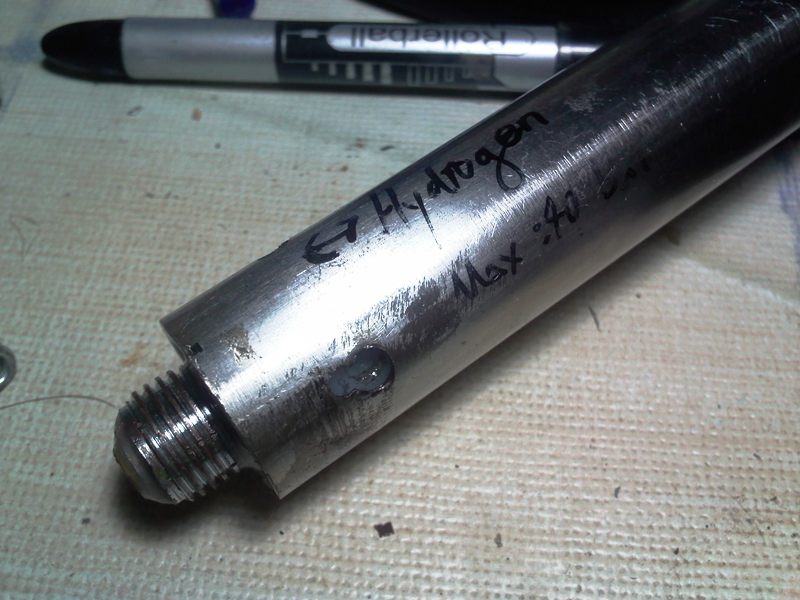

22mm ID, stanless steel, tested to 50 bar, but stay below 40 bar.
1/4 NPT threads.
Hydrogen output
Hydrogen output
Compressed air input.
Sem Título.png (13.17 KiB) Viewed 5440 times

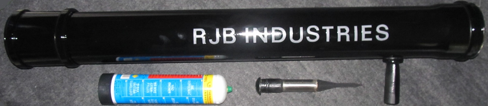

The PHC is the Pressurized H2 Chamber, this is a prototype, the main PHC will be bigger and reach more than 90 Bar.
After I can install this PHC(Pressurized H2 Chamber) with a regulator inside the body of my cannon
RJB INDUSTRIES
An application of PHC

That bullet it´s too heave compare to hydrogen´s burn rate.
What type of regulator are you going to use?

Is made of Inox at front and Plastic at back side. Is not so heavy, 200g
