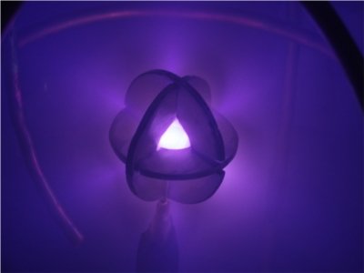

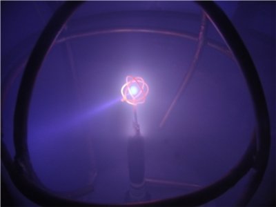

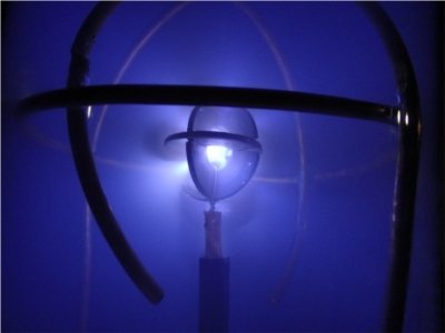

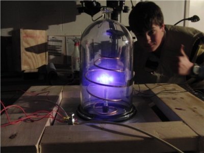

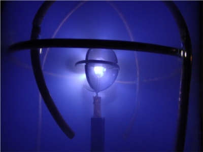

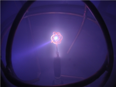

During my short and now-ended hiatus from spudding I directed most of my time and efforts towards designing and building an Inertial Electrostatic Confinement Nuclear Fusion Reactor (IEC fusor or farnsworth style fusor).
Here's a vid:
Before I proceed into the description of my project, I should first say that this IS NOT BREAK-EVEN OR COLDFUSION!!! This is purely for research purposes only and is very hot fusion.
An IEC Fusor consists of two spherical, concentric grids inside of a vacuum chamber. The outer grid is grounded, and the inner grid is charged to a very high negative potential, in my case via a full wave rectified neon sign transformer (and eventually a voltage multiplier cascade on top of that!)
Due to electrostatic field emission of the inner grid the gas (deuterium for fusion) in the chamber is ionized (thus it has a positive charge) and accelerated towards the inner grid (negatively charged.)
At this point the ions have enough inertia to collide inside the inner grid (in the case of deuterium, some collisions will result in the fusion of the deuterium into helium.) The ions are then either remixed with electrons, resulting in a plasma discharge, or are accelerated through the grid.
My Fusor:
Specs:
Power supply-15 kv NST full wave rectified (soon will include a cockroft- Walton cascade) produces up to 9500v DC @ 32 milliamps
Vacuum Chamber- 6" pyrex bell jar (Stainless chamber under construction)
Vacuum Pump- Welch 1399, down to about 10 millitorr
Doesn't do fusion yet, all I have to do is leak in the deuterium and up the input voltage a bit.
