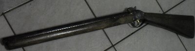

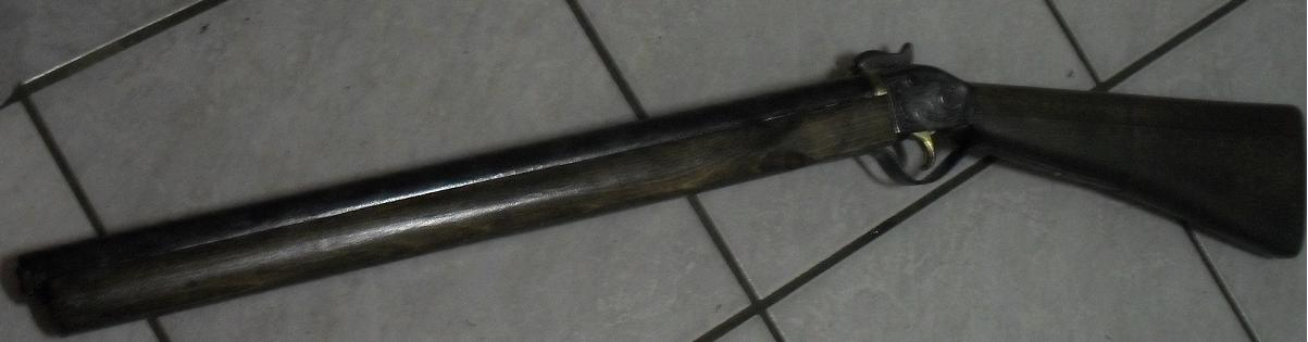

I just love the long stock!
I plan on having the front stock extended with a brass piece holding the ramrod and I'd like it to stick out further than the barrel just a bit.
That will make it look very beefy.
If done right that is. You'll see.

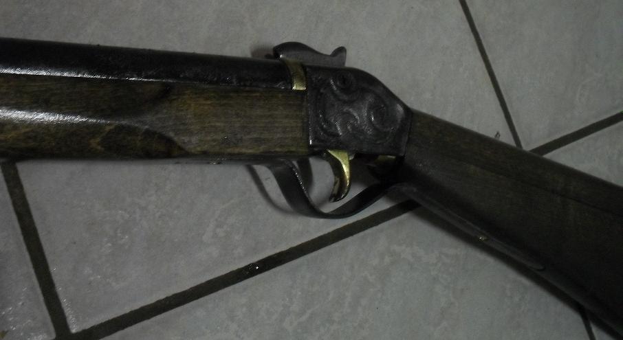

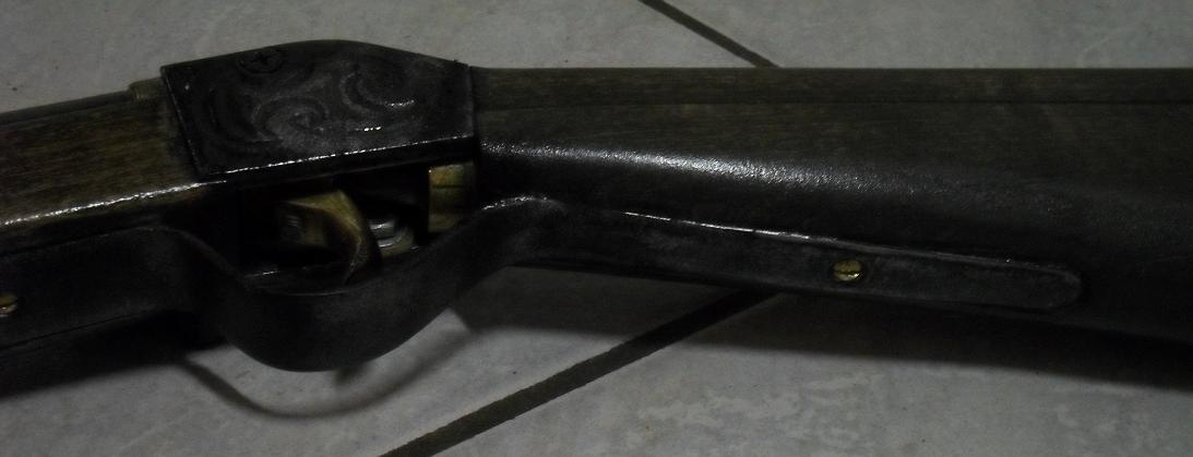

So...clearcoat is drying...and I still need to do some finishing touches on the paint..
At my son's request I went for the aged metal look.
...too bad..I had that triggerguard shining like a mirror..
But it looks pretty cool.
I got some brass screws for the triggerguard and for the hammer aswell.
In my painting frenzy I smeared paint all over the brass parts, like the receiver and trigger, but I can get that off tomorrow and restore the brass to its former shine.
Oh...and I engraved the sideplate...sanded the stock down to the final shape..and used a conical drillbit to widen the muzzle...and redid the inside triggermechanism..made a triggerguard, polished it and then cut it into the wood...made a halfcock safety..shortened the tail on the hammer...increased flow on the pilotvalve...and...well...I've been busy!

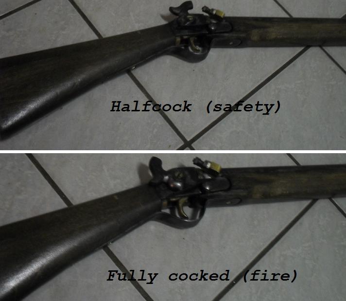

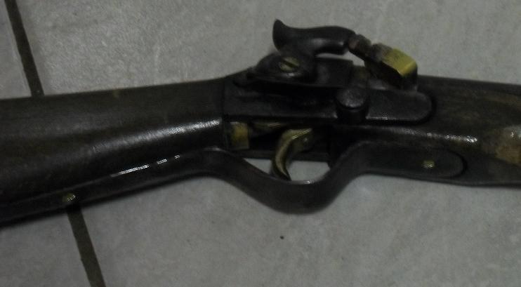

I was wondering how does the half cock safety work since your lever action...
BTW I knew somebody would go for the aged metal look
suits it well!
- Brian the brain
- Posts: 3497
- Location: Holland
- Been thanked: 7 times
Like Elvis said:
I'm caught in a trap...and I can't get out...
The first notch traps the trigger.It can only be released by pulling back the hammer.
In firing position, there is no lip to trap the trigger.
