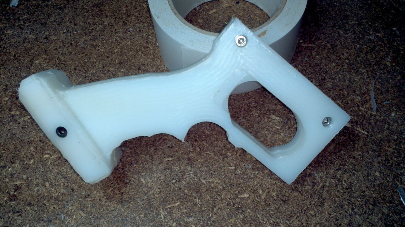

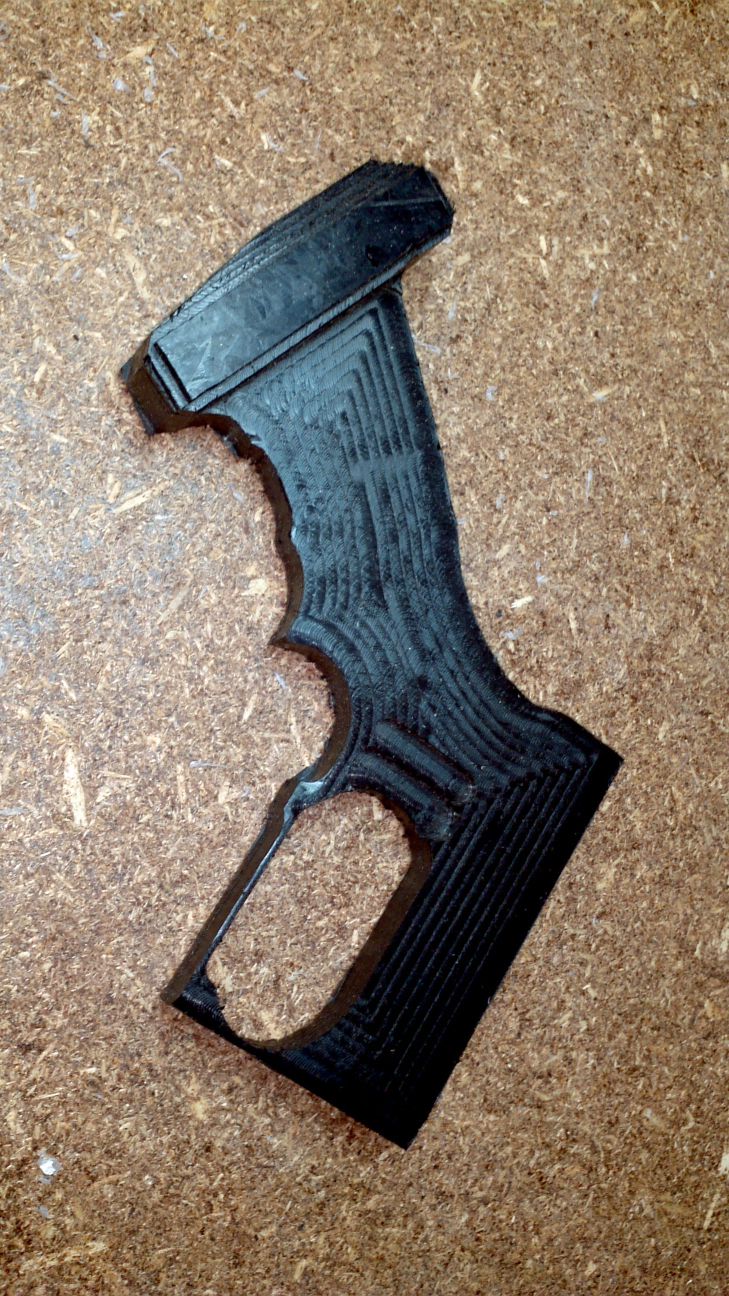

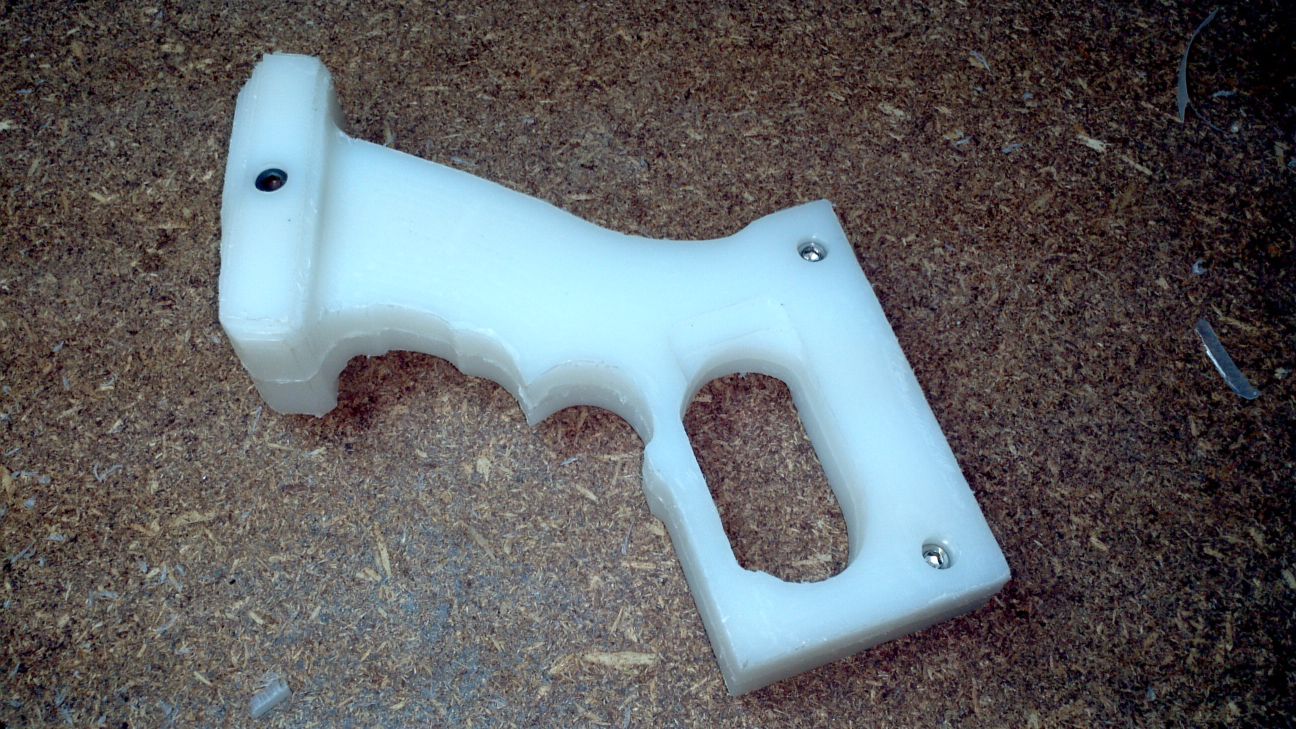

I has new supply of HDPE

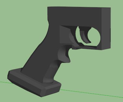

  • HALO image from Sketchup

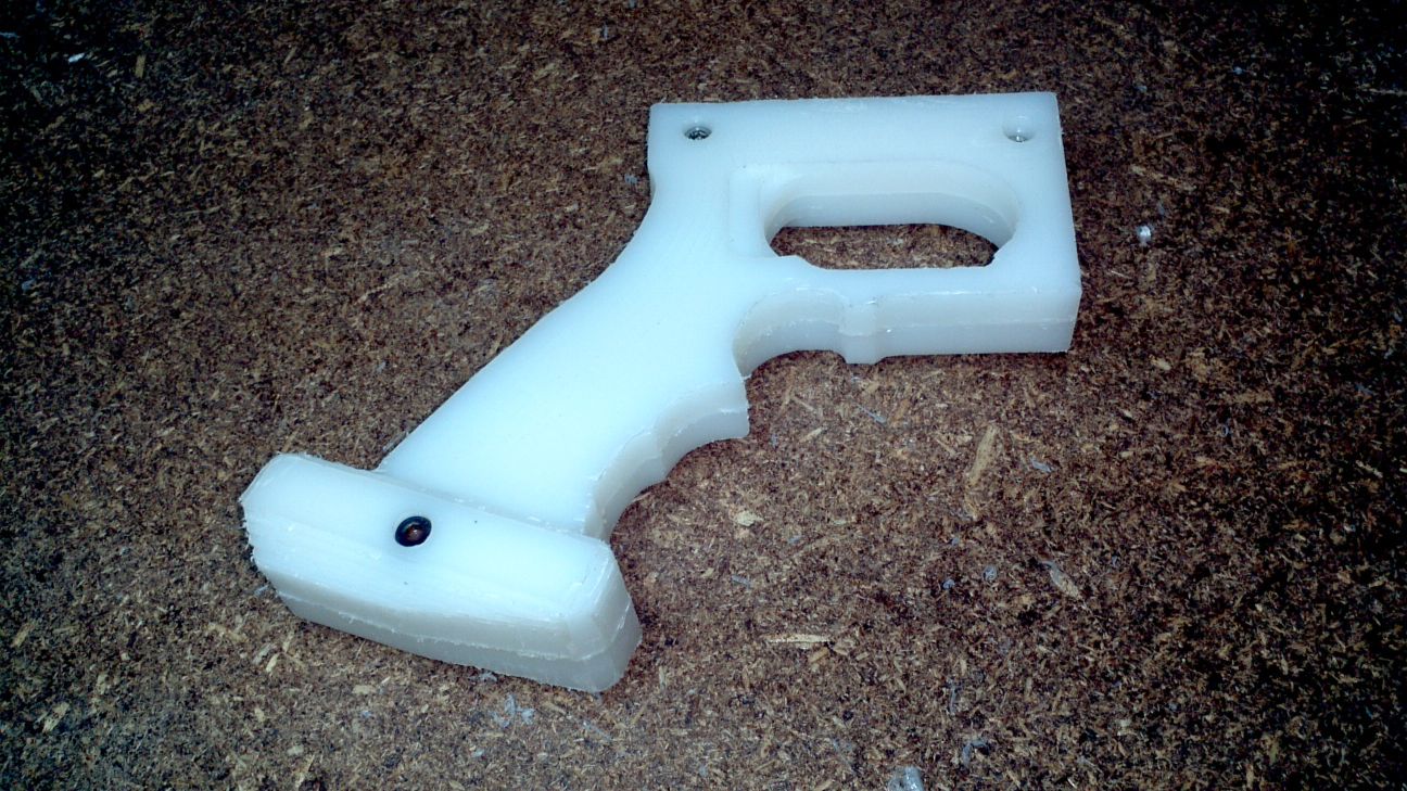

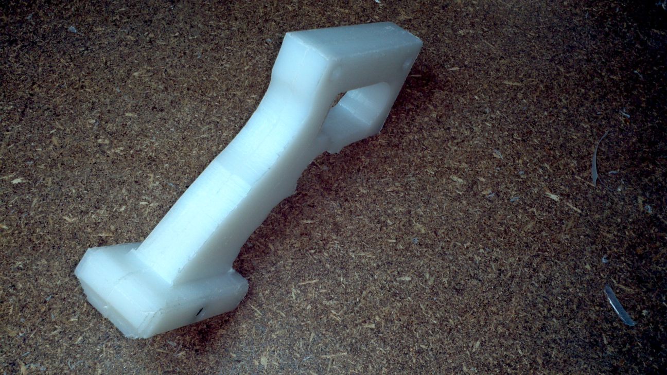

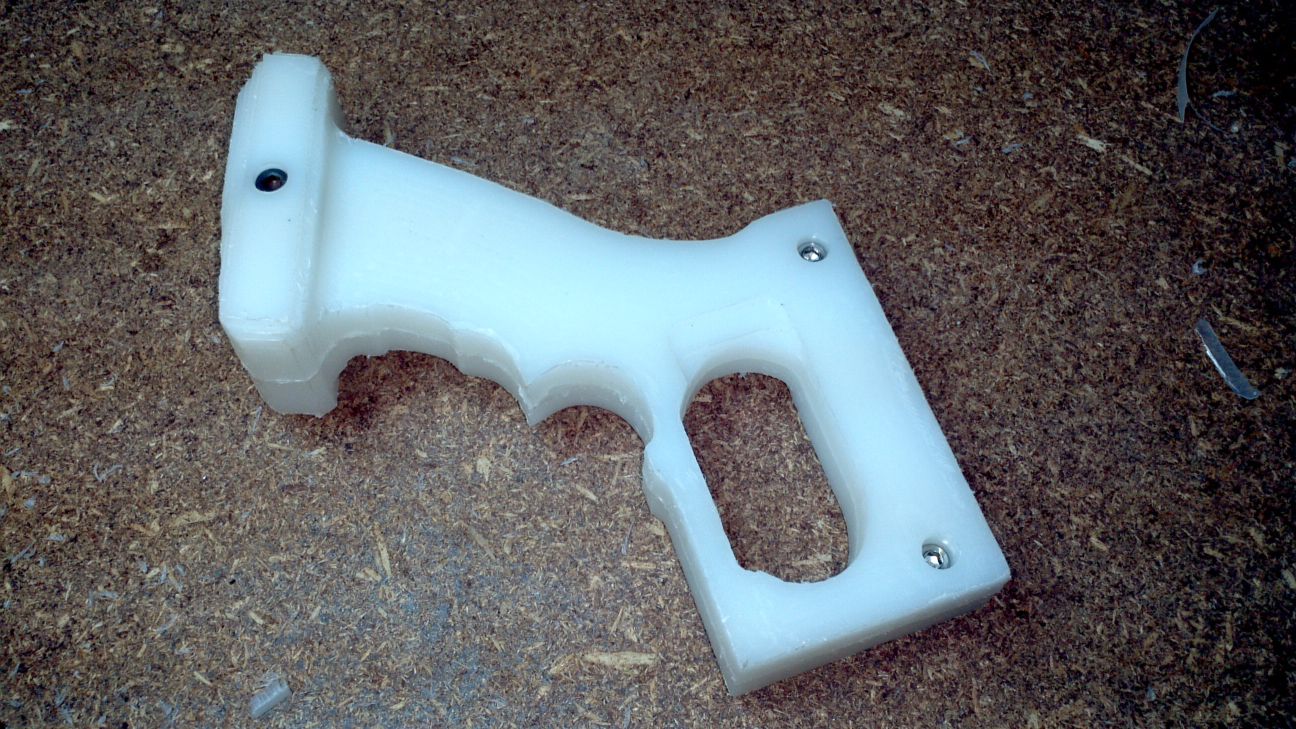

    40 minutes of CAD/CAM
    One hour on the mill
    Needs polishing and finishing properly

Looks good mate, if you need to just smooth it over a bit, just running a heat gun over it should slick it up a bit.
/sarcasm, /hyperbole
evilvet
Posts: 267
Joined: Sat May 01, 2010 2:48 am
Yeah, heat gun or a Dremel with a sanding drum is the current option.
My longer term plan is to add a fourth axis to the mill, then all is good.
Right now i can do pretty much any regular solid, if it has a symmetric axis in at least one plane then all is good. i create the part as a 3D object then split it into two halves, after milling they are glued or screwed as shown into a complete unit.
The process is pretty straightforward.
  • Create or acquire the object as an STL file
    Load it into CAM and perform a series of X axis slices at the range of 1-2mm depending on the level of detail required
    Delete all polylines below Z=0
    Create MOP's to suit the remaining polylines
    Copy and past the result and then do a Y axis transformation on the copy
    Edit the Z axis points on the copy to create two "flat" 2.5D results
    Machine then laminate
Crude but effective.

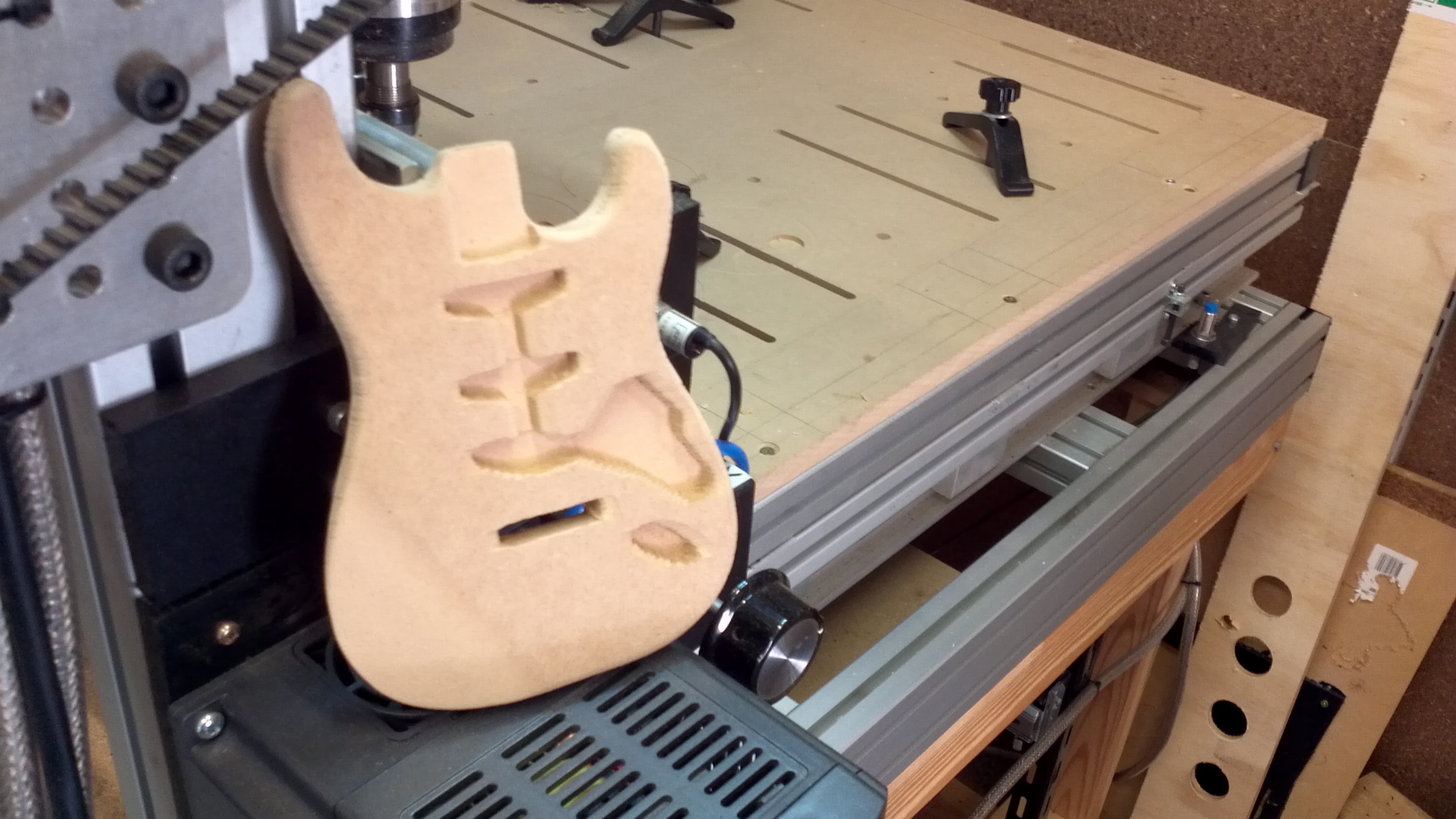

And fabricated a jig that allows me to flip a part accurately around the XYZ centre.
And the first result is..........
A 1/4 scale model of a 62 Stratocaster.
I have a couple of mates into their music in a big way so did this for a laugh.
tres cool! is that wood or foam?

It's MDF, 16mm stock.

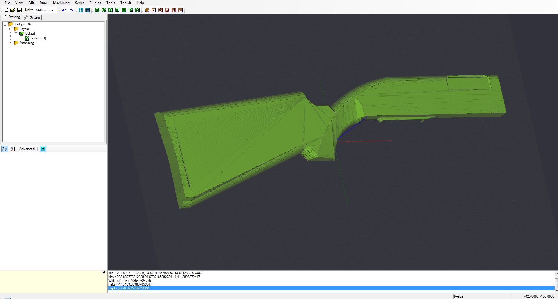

Something like this maybe.
Happy to make one up for testing purposes, anybody got some suggestions ?
Maximum dimensions would be 600mm long and no more than 40mm total thickness. The obverse and reverse can have different detailing, even engraved lettering if that floats your boat.
The main issue is getting a suitable 3D model. The one below was taken from a Google Sketchup model of (allegedly) a Remington 700, then exported as an STL format file for CAM processing. Each surface generates about 80,000 lines of code for the CNC mill to chew on. I can produce something to about 0.1mm accuracy, that's about 4 thou for you non-metric types, the result really depends on the tooling and the material.
