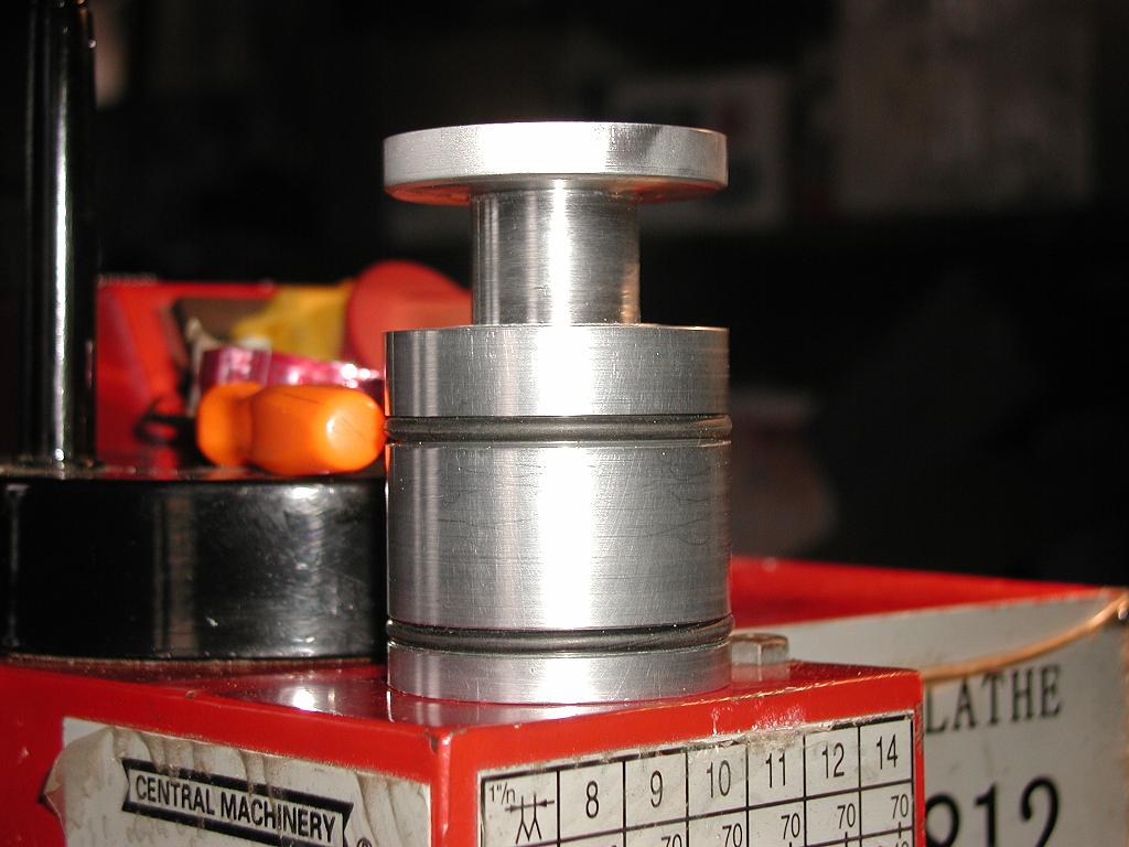

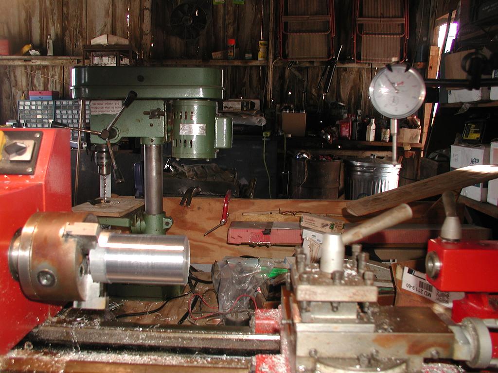

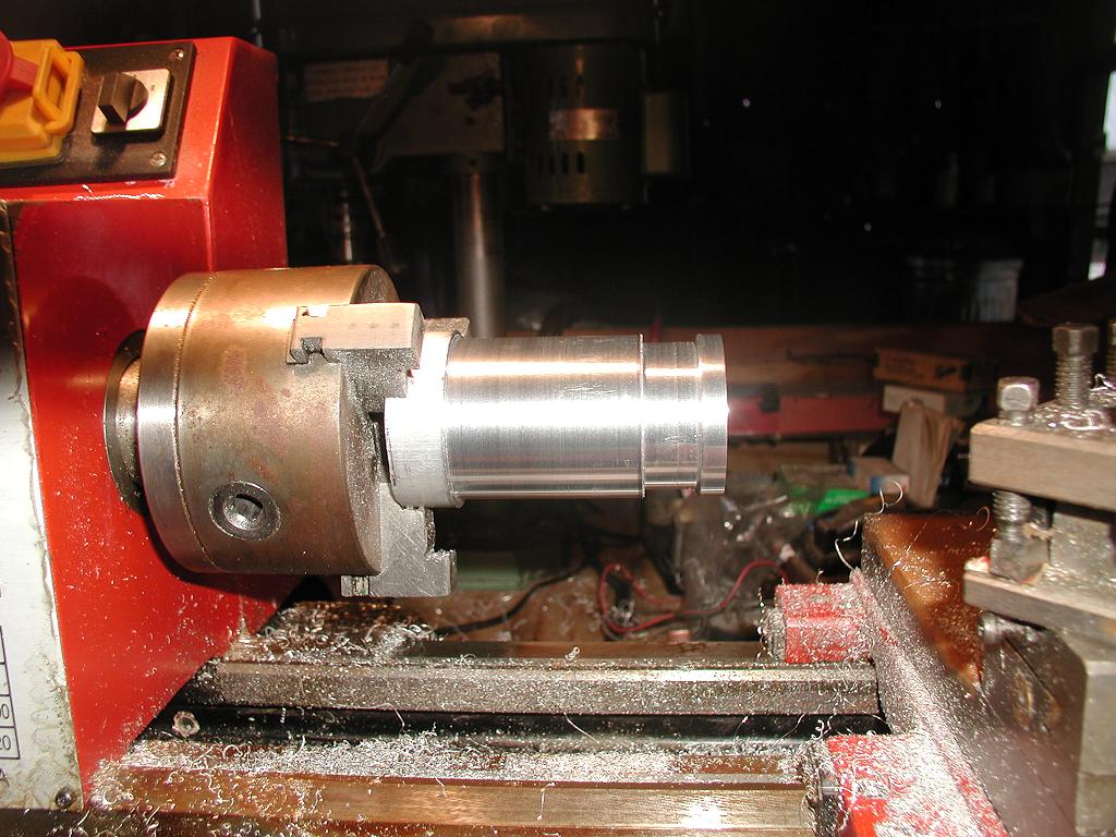

Hoggin out some dead weight on the back of this piston. Using a 2" boring head and a carbide tip cutter. jsefcik's piston valve. The way that it's put together (sealing face past the mid point) this configuration should open better. Multiple surfaces to push the piston back (toolies style) and drum in the rear for stability.
Who ever built the valve housing did a good job, only 2 places for improvment that I can see. 1: Sealing face should be centered and 2: the cylinder should be trued (made round and straight).

Lookin' good!jrrdw wrote:Hoggin out some dead weight on the back of this piston.
In practice, these surfaces cancel out so it doesn't make it more efficient than a "solid" valve. Weight saving certainly helps though!Multiple surfaces to push the piston back (toolies style) and drum in the rear for stability.

did the piston move on the chucks at 9 seconds?Hoggin out some dead weight on the back of this piston. Using a 2" boring head and a carbide tip cutter.

No, that was me grabbing the camera. It was sitting on the cross slide beside the tool post so I grabbed it while turning the tail stock handle. Everything moves at once if you look close at the chuck it moves right with the piston.did the piston move on the chucks at 9 seconds?
