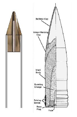

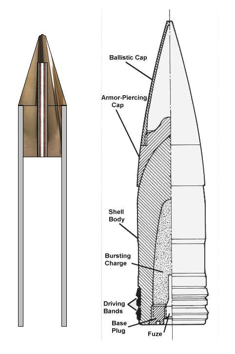

But I do not understand the point of drill and put a tungsten rod as the tip does not open, the tungsten will remain inside ...
See the attached diagram, the tungsten will back the steel with something hard and dense, and at the same time the steel will make the tungsten less likely to shatter by absorbing some of the impact shock, like a capped shell which we discussed some pages ago.
