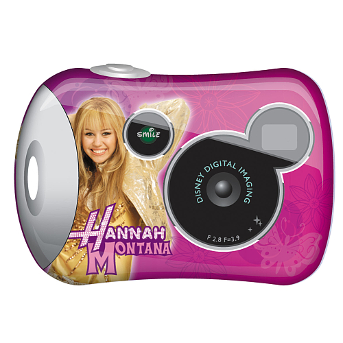

The camera would be fun. You can get one of those $20 0.1 megapixel kids cameras...
If a $20 "Hanna Montana" camera can survive ...
http://www.toysrus.com/product/index.js ... Id=3125465
I've got a $20 "spy camera" (0.1 MP or so) that includes ~20 FPS "video mode".
