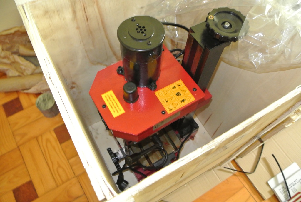

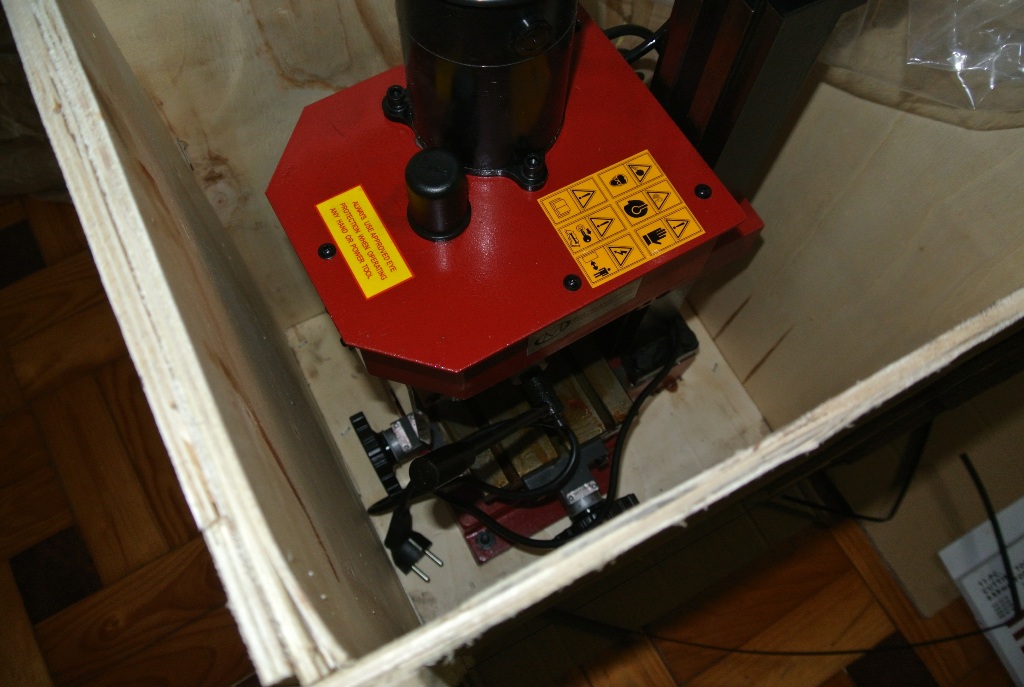

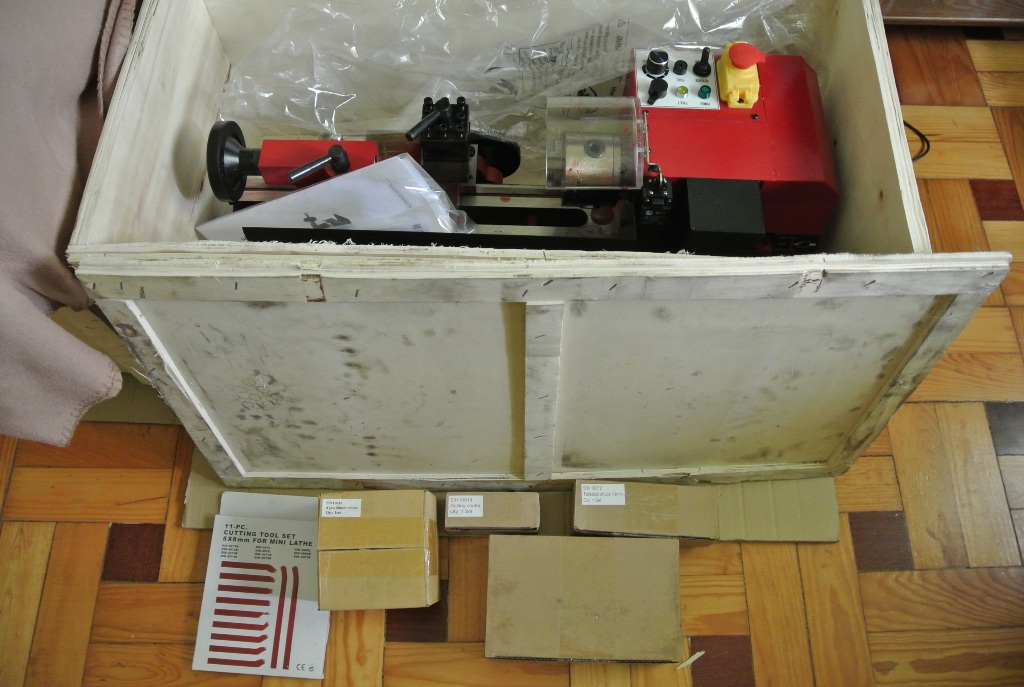

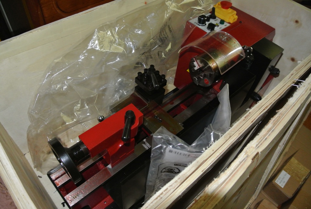

Finally I got the boxes open
40kg each, still haven't figured out how to move them into my work shop.

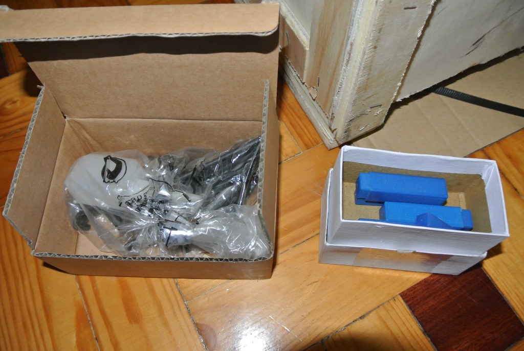

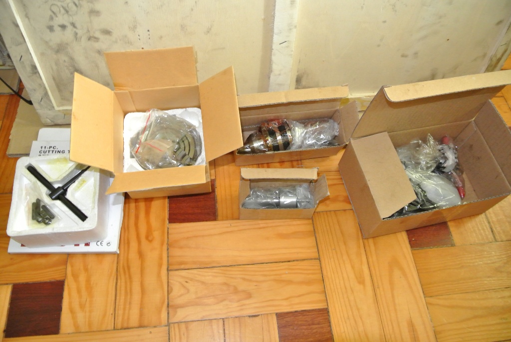

BTW it came with more accessories than I thought
