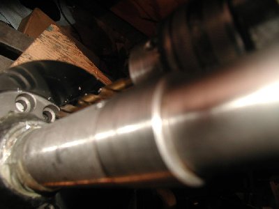

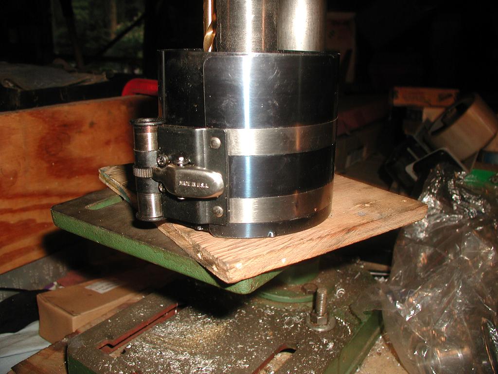

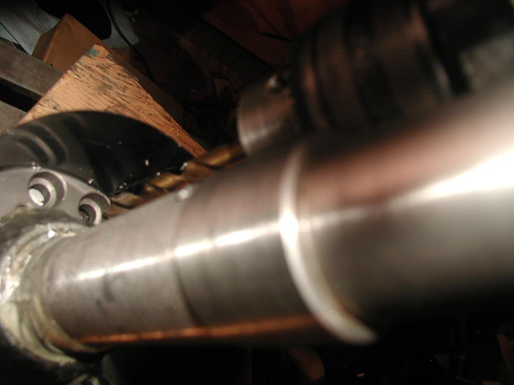

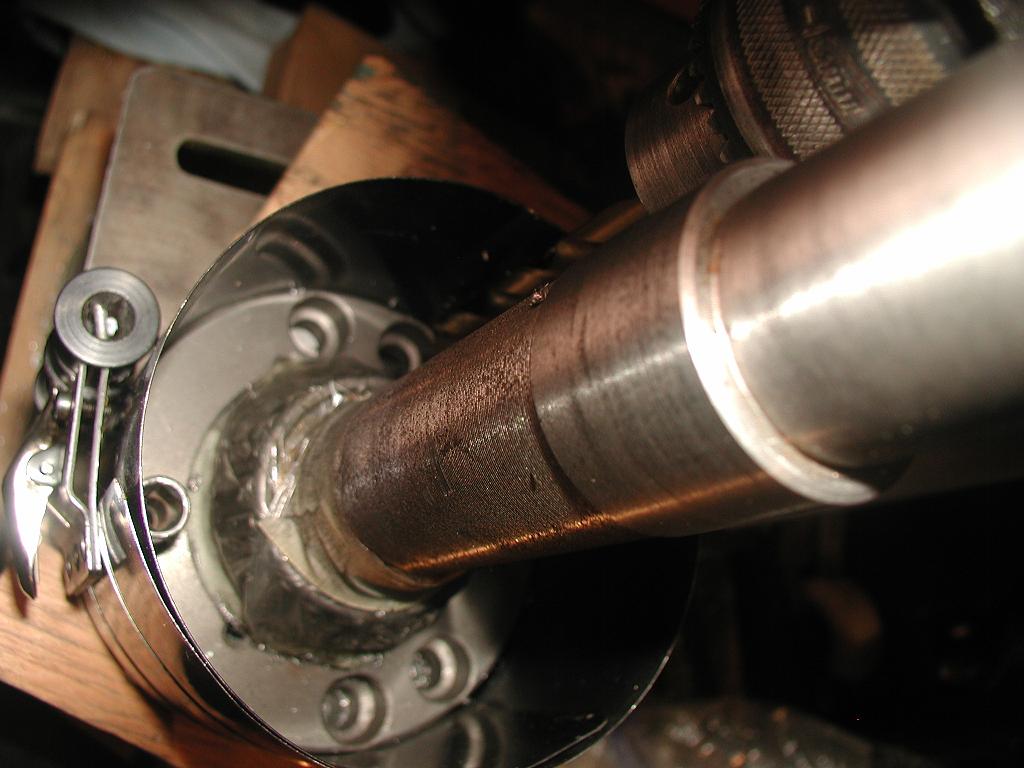

Had to drill my lathe spindle to mount my 4 jaw chuck. I turned/hogged out the adapter (3" spindle to 4" chuck) and used the bolt pattern for my guide. A 9/32nds deep well socket to keep the holes lined up and a piston ring compressor to hold the rig together. It worked very well! :D
Drill bit in possistion to drill the bolt hole.
The socket lining up the bolt holes.
The ring compressor holding the rig together.

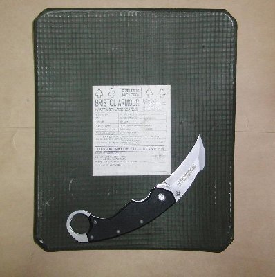

This is what happens when you machine for folks without cash, they pay you with a ceramic insert for a ballistic vest and a S&W knife :roll:
All I can say to that is a good knife is always a keeper, but as far as payment goes.....nope. It don't pay the bills!
Not exactly what I would term a "good" knife... http://www2.knifecenter.com/item/SWCK33 ... inch-Blade
