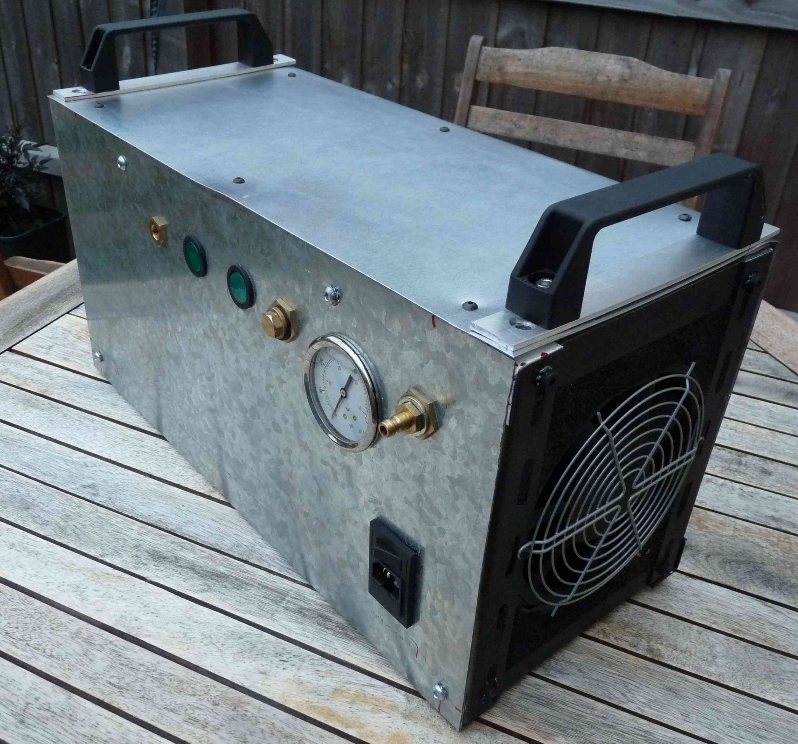

I got around to finishing this at last, the case is built out of scrap steel angle and some galvanised steel sheet, the fans are mounted in the ends in a push pull arrangement which gives very good airflow around the compressor shell.
There's a nice shiny stainless steel glycerine filled guage, individual controls for the compressor and fans, a quick release on the output, threaded air and service inputs for potential upgrades and an IEC mains inlet

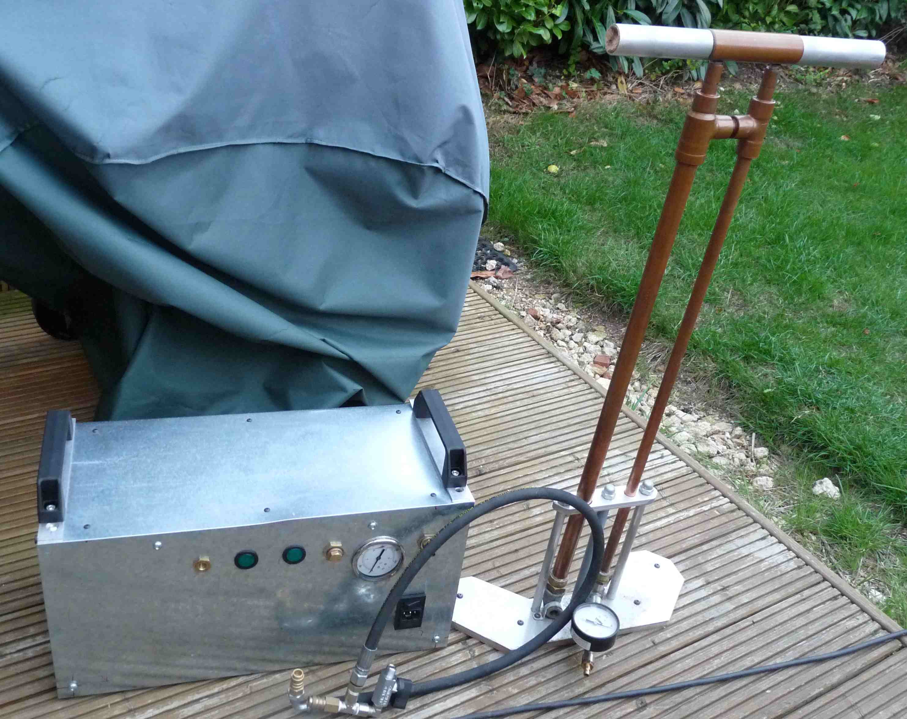

the hose is a hydraulic one with a quick release fitting on both ends so it can be shared between this and my hand pump (the power tends to go off when the zombies attack :lol: )
together with it's 'arm powered' brother and shared high pressure hose

Well played! I have plans to rig my compressor to my bicycle for the same reason! :D
But seriously, looking extremely professional there, puts most other compressor setups to shame.
