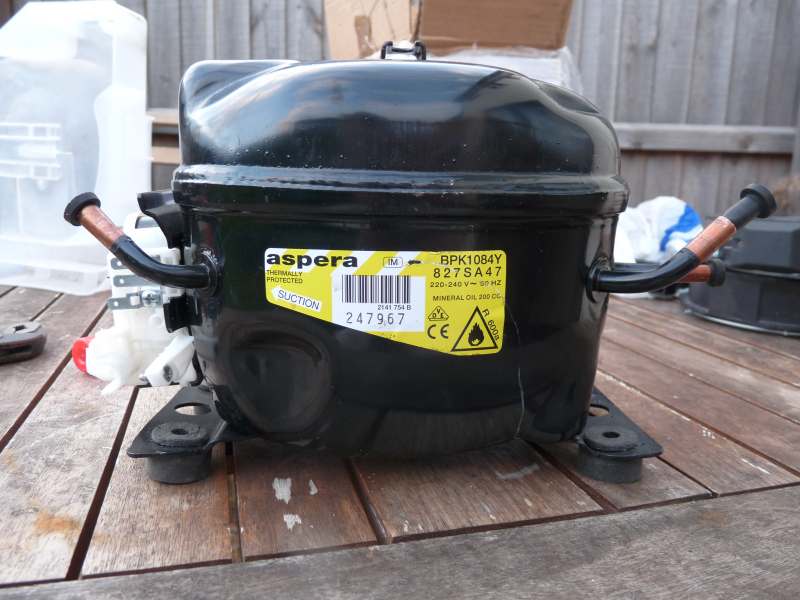

So I've just got a fridge compressor, I actually bought one new off of ebay as there are not many abandoned fridges to be found around here, problem is there is no pre-existing plumbing or wiring to give me a clue as to how to hook it up. After a bit of research and taking it to bits I think i've got the electrics worked out. The live terminal block isn't connected to anything, I need to wire it to the exposed connection of the protection device via a switch. the other terminal of the protection device is internally connected to the common pin of the compressor motor. The neutral terminal connects to the run coil of the comressor wire and a PTC (positive temperature coefficient) resistor connects the common and start coils. I was a bit confused by the extra terminal connected to the start coil, I think this is for a start capacitor which this compressor does not require, being a LST (low start torque) model.
As for the plumbing, the label indicates the tube on it's own on the left is the suction, which leaves the outlet and service connection on the right.
Not sure which is which but one leaks oil when I tip it up so I'm guessing this is the service connection and needs to be blocked?

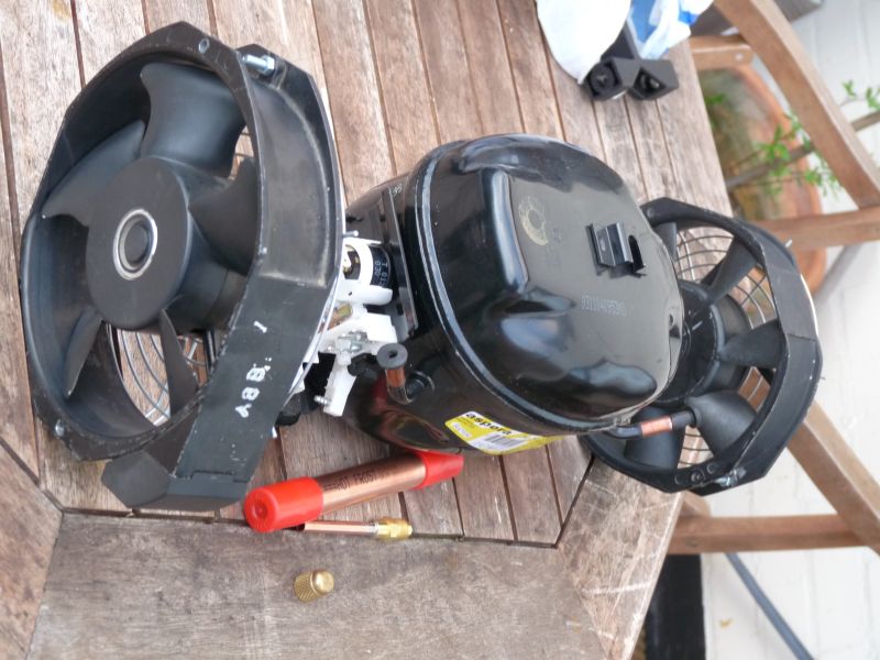

@ Poland, I think i've got the cooling covered, see below
As for the reservoir, I thought about it but it will actually slow me down, I'm going to have a big reservoir on the gun so if I put another one on the compressor as well it will just take my twice aolong to fill

I, er found them in a cupboard...damn, where did you get those fans ? they look great and it seems they are of the right power
they're 120V AC which is a bit wierd but I can wire them up in series for my 250V mains

Blowing air around a smooth compressor housing will provide little or no cooling. (no fins)

Are you saying if you sit in front of a fan you won't feel cool because you don't have any fins
True, fins would increase the cooling as would loosing the paint job and an aluminium shell instead of steel but the cooling will still be significant with a good air flow.

are you saying that this compressor cannot be air cooled or that adding a fan will not inprove the efficiency of the air cooliing?If your compressor was not made for fan cooling, adding a fan adds zero.
A compressor carries out work, it's far from 100% efficient so it gets hot, in turn heating the air around the compressor which rises away from the compressor and sucks more cool air in. It's called a natural convection current, add a fan and you have forced convection which can be hundreds of times more effective at moving air.
Your compressor may indeed need no fan, it's not enclosed in any way and it's outside in moving air. mine will be fitted into a rugged compact enclosure, fan cooling costs me nothing and can only improve the lifetime and performance of the compressor.
If you have found some other magical way your fan keeps cool other than air cooling I would love to know what it is, I'm doubting radiation off of the surface or conduction into the ground are very significant.

See my A/C compressor in the video?spudamine wrote:are you saying that this compressor cannot be air cooled or that adding a fan will not inprove the efficiency of the air cooliing?If your compressor was not made for fan cooling, adding a fan adds zero.
No fan would cool it, no matter the size.
Refrigerant compressors are designed to be cooled internally by the refrigerant that flows through it.
A fan blowing air over your chest will not cool your liver.
