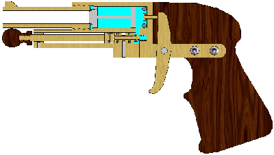

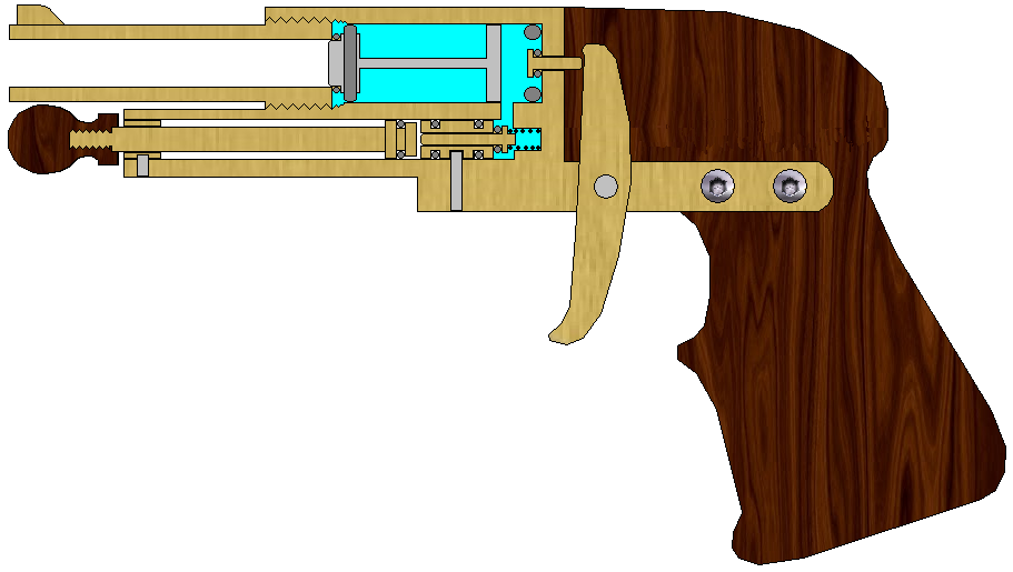

Been doodling some designs and seeking consultation as to what tools I would need to purchase exactly for my purposes and what is and isn't possbile with a lathe and mill. Here's one, not saying I'll build it but the list of potential projects is growing by the day...

selfcontainedminipistol, how do they work?
I don't completely get the piston.

Labtecpower wrote:selfcontainedminipistol, how do they work?
The dark grey part through the front is a rod so air is free to flow around it.

I still don't have a lathe :oops: what I do have is the money burning a hole in my pocket and the increasing knowledge that I need to be better informed before I part with my cash. My consultant assures me it will be fine in brass, though I have yet to see the full operation in action. Note that in this case the o-ring on the piston seals agains the breech, but there is no seal in contact with the chamber walls.

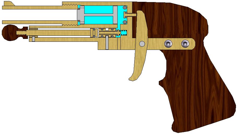

In the meantime, I noticed that the port between pump and chamber needs a hole that will then be plugged with a brass rod epoxied in place ;)

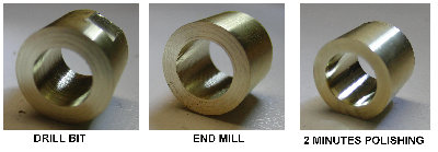

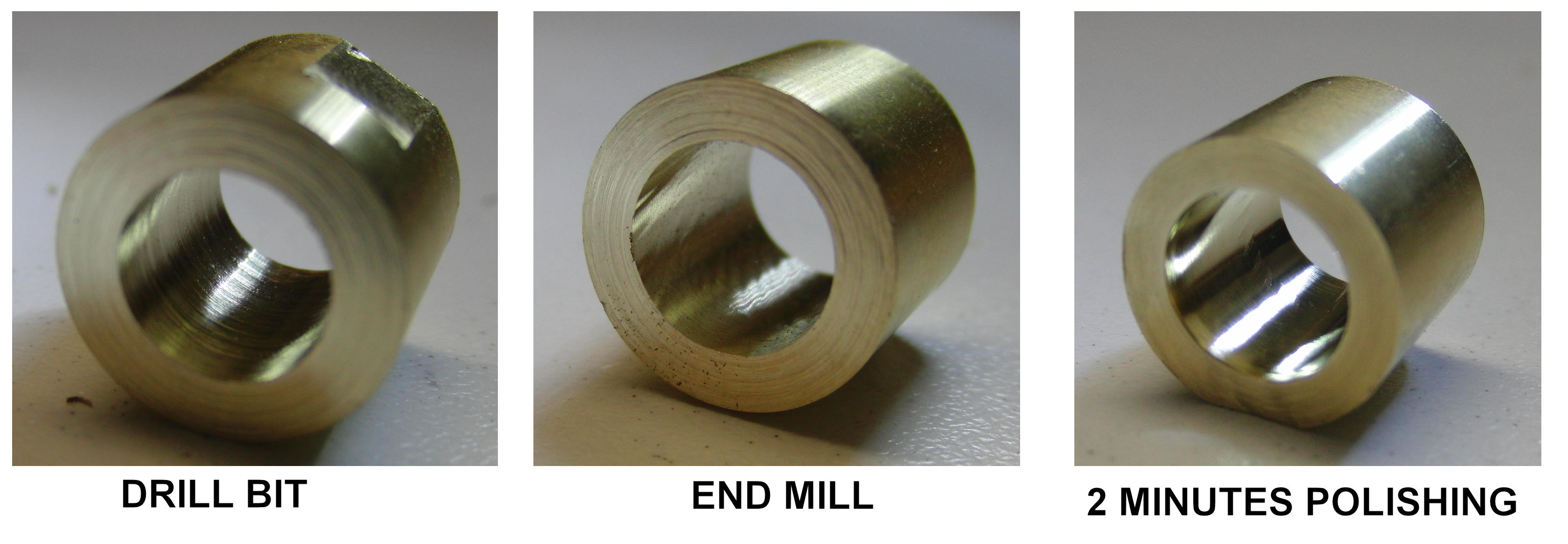

Here's for you 5/16" hole, just to feel it (very quick & dirty job)
But it is very true a reamer would do a better job... you never have enough tools ;-)

Image Yeah, work it! Image
To be honest, even drill only looks good enough for piston purposes...
How did you polish?

An opportunity to play with the camera :D
Look Ma'! No hands!!

LeMaudit wrote:An opportunity to play with the camera :D
Much better than your previous effort ;) and oh, that complex eh? I already polish like that in my drill-clamped-in-a-vice lathe!
Did you duct tape the camera to your chin :D
Then, maybe you don't need a lathe :lol:
This will remain unanswered.

No hammer and sear :(
No conical seat :(
No fold down grip for easier higher pressure pumping :(
No air inlet for the pump ;)
No spring to prevent air from leaking into the chamber instead of pilot volume :O

The pretty textures were meant to distract you!
Floating o-ring ;)
Pulling the trigger fully sufficiently blocks off the port ;)
al-xg
Great Britain
Posts: 643
Mmhmm and how does it get to the O-ring in the first place ? Loose fitting pump shaft ?
And the pin moves back with pressure on first pump stroke ?
